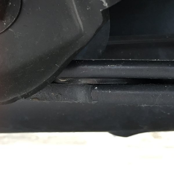

  6. May 21, 2016 at 2:06 PM
    #686
    Jks1
    Jks1 Well-Known Member
    Apr 8, 2016
    #183691
    190
    Jared
    SLC, UTAH
    14 dcsb offroad
    image.jpg I didn't take any photos during install so this is the best I can do for now. I pulled the 3rd leaf but am going to reinstall in a few weeks. I'll be adding the spacers to the 3rd when I do, so I will take some better photos then. image.jpg
    4WDTrout, Norton and DrFunker like this.
  7. May 21, 2016 at 2:07 PM
    #687
    Jks1
    Apr 8, 2016
    #183691
    190
    Jared
    SLC, UTAH
    14 dcsb offroad
    Looking at pic I realized I forgot to paint where I drilled so I'll have to do that when I reinstall the 3rd leaf.
  8. May 21, 2016 at 2:10 PM
    #688
    IronPeak
    IronPeak PermaLurker
    Mar 9, 2016
    #180799
    3,232
    AuggieX
    Back to Back
    2007 sr5 4x4 DCLB/2015 TRD sport 4x4 DCLB sold
    Bigger Taller Slower
    How many pairs of spacers are you going to end up using?

  10. May 21, 2016 at 2:20 PM
    #690
    Jks1
    Apr 8, 2016
    #183691
    190
    Jared
    SLC, UTAH
    14 dcsb offroad
    I put one on each end of the leaf, and will do the same to the 3rd down when I reinstall. So total will be 4 new ones per leaf pack. I went to the local spring shop and they were 50 cents a piece.
