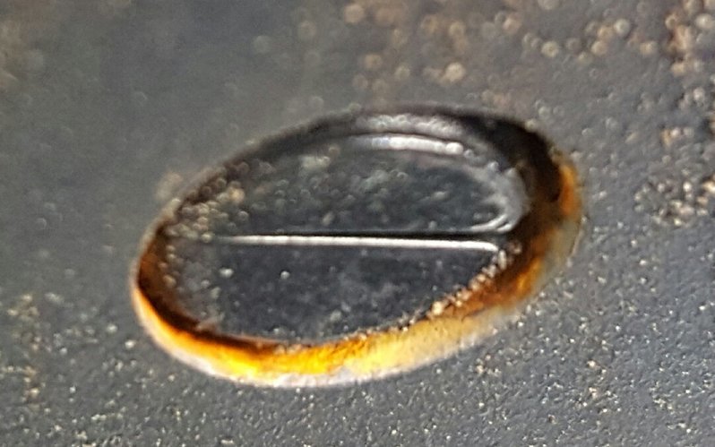

    Im.not sure but I did ask for the springs to be "drilled and isolators installed" , here is a pic, I can't tell from it one way or another, though I would expect some deformation around the lip of the hole if it was punched. Looks like I'll be giving each hole a shot of paint, too :)

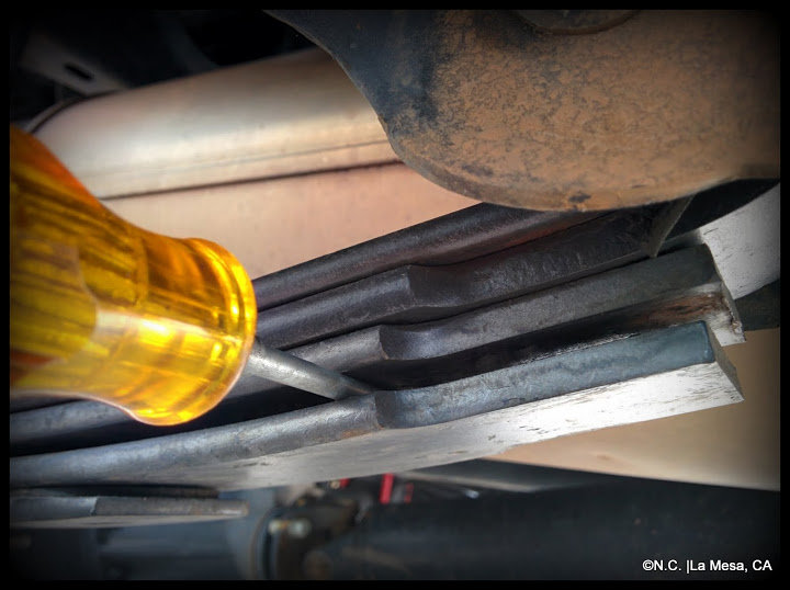

    The best tool to diagnose the squeaking is a mechanics stethoscope. I have this one from Lisle. It's great. Lots of uses!
    In my experience, the squeak comes from the ends of the leaves, so that's where you'll want to lube. What has worked for me, has been to chock and block the front wheels, then jack the truck by the slider and put jack stand under frame. The rear suspension needs to fully flex out, so it's unloaded.
    Then take a screwdriver and hammer into the sides of the leaves to pry them apart. This will be easy. Then spray the lube.
    Use care to wiggle the screwdriver out. Repeat for each leaf, leaf ends, and each side of truck.

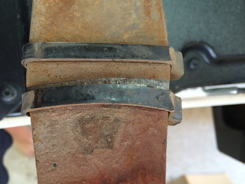

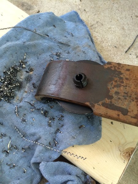

    Drilling for the inserts today. I'll be successful, but I think it would have been worth $10 a hole to let a spring shop do it.
    How the zip ties looked after six months and about 7-8k miles.

    Finished! Now that it's done, I'm glad I did it myself. Once I learned to start with small drill bits and slowly enlarge the holes with bigger bits, it was a breeze. I used a lot of cutting oil, but my drill bit set faired pretty well.
    And the Dakers are quiet as a mouse!

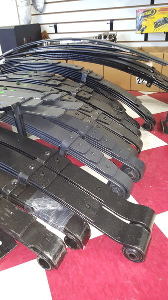

    At Yodaman, Santa Rosa CA, a pile of leaf Springs shows isolators on all leaves. Wonder why ARB doesn't follow suit, as it looks like industry practice.
