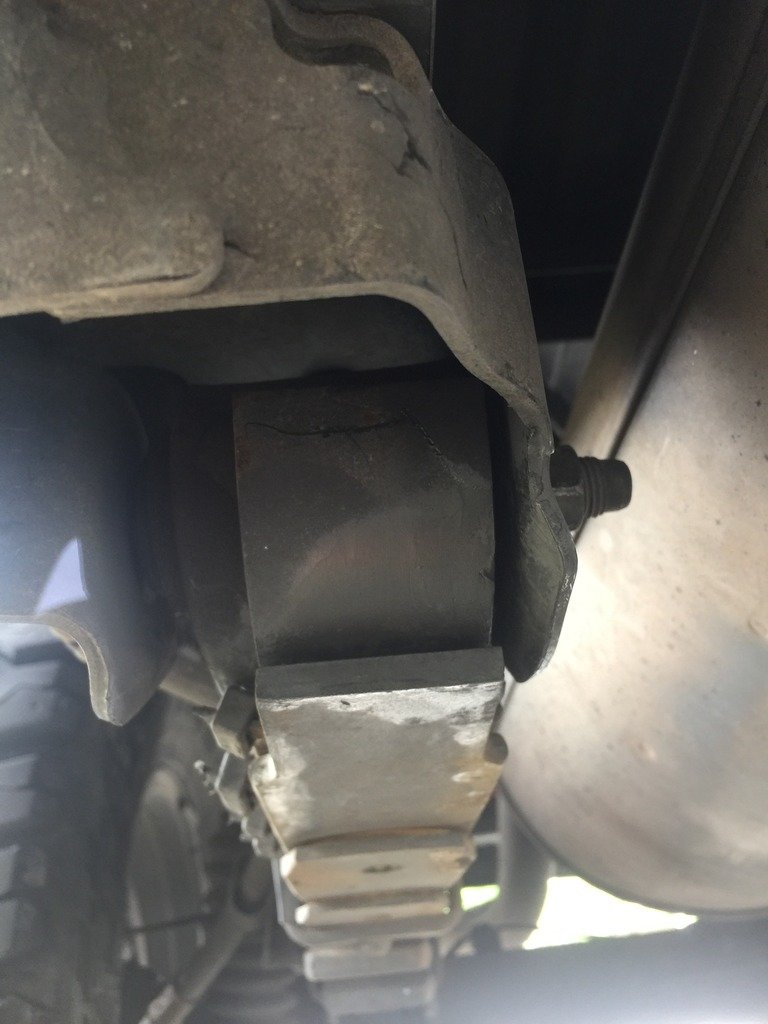

    So after trying all the methods listed in this thread and still not getting results, I isolated the issue. I had tried the whole loosen the bolts and cycle the suspension and tighten them back up again thing and that didn't work but this time I loosened the bolts and then went back under the truck to see if the noise went away. Turns out it was my passenger side front bolt that was making the noise. Torque it down, noise. Loosen it, no noise. You can see in the picture how it is sort of pushed over to one side (the photo is after I moved it). I went under there and jammed a flathead in between the spring and the right side of the bracket and started to try and pull it back over. Wasn't able to get it to move much but it did a little. Shot some dry moly lube in between the gap I had created and tightened the bolt back down. Seems to have fixed it for now. I will report back after a while to see if it's a lasting fix.

    Those shackle mounts are known to splay outwards according to some older posts I've read

    Reporting back, the moly lube did not work out. I went to home depot and got some neoprene washers. I took the nut off the shackle bolt and I didn't want to get fully into taking off the U bolts and all that so all I did was put the neoprene washer underneath the washer and nut for the shackle bolt and voila. Over the past few days it seems to be working pretty well.
