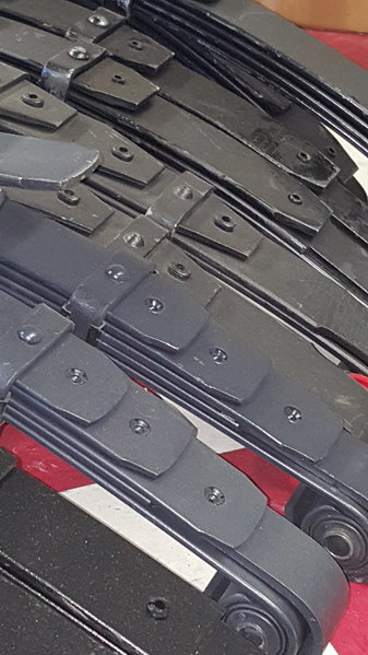

    One thing,I was at Yodaman, the best guy in the north Bay for 4x4 work. He has a rack of done up older tacos out front and is often out of the shop wheeling up in.the Sierra or moab... anyway here's a shot of springs he's waiting to install and you can.see that isolators are industry standard, maybe not for those aussies...:20160627_150002.jpg
    ChadsPride, Norton and DrFunker like this.

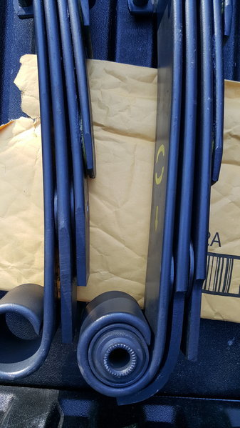

    OZ-T
    OZ-T [OP] I hate my neighbour
    Dec 15, 2009
    #27584
    50,587
    Peter North
    British Columbia
    Theres no isolator on the leaf wrapping the front bushing in your pic
    Thats where the Dakars squeak
    ChadsPride and IronPeak[QUOTED] like this.
