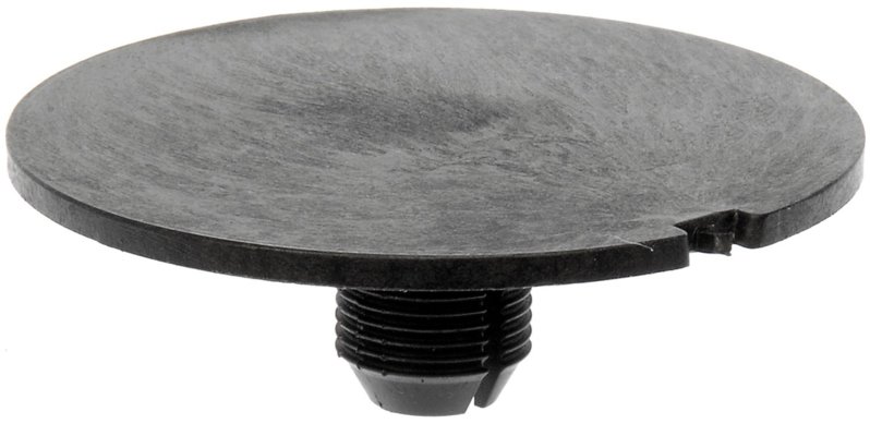

    Just ordered these from Amazon. Won't arrive until next week, but I want to drill the holes in my Dakars this weekend.
    Are they standard 1/2" holes that need to be drilled?

    Dunno. I'd wait and measure with a caliper. Are those the Dorman ones? I think I need 12 of those...

    Yeah I ordered 3 boxes of 4 in each box. They were Amazon "add-ons" so I ordered another RAM Mount diamond base to meet the add-on threshold, since I've turned into a RAM Mount addict like you :)

    Very good! Please let me know how your drilling works out... I'm curious thx.
