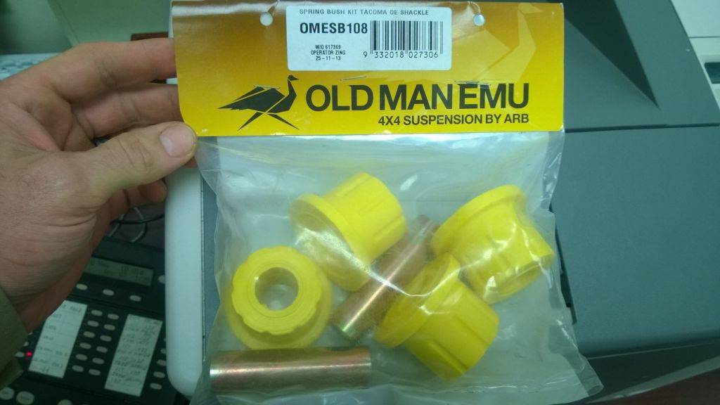

    Are the dakar bushings supposed to be greased just upon install? Or are they supposed to greased at different intervals following install as well? Because I'm starting to think that the people that installed my dakars maybe didn't grease the bushings...

    What kind of bushings do you have?
    Dakar only supplied one rubber bushing in the front. Customer was responsible for supplying rear.

    Used the OME Bushings that you can buy (not my pic) but they're these

    Yes. Those should be greased.
