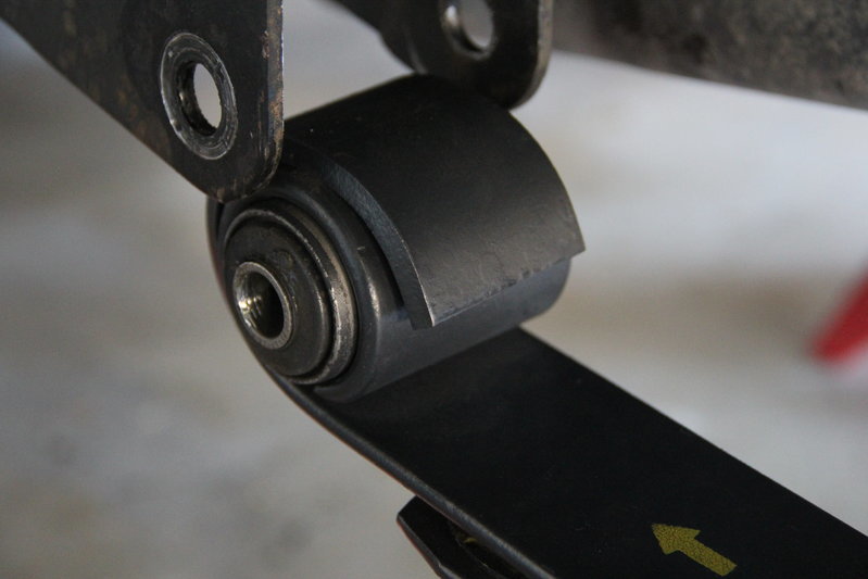

    I replaced the stock rubber Dakar bushing with Poly when I had them out. Rear already had poly and was still in good shape, so I re-greased the bushing and sleeve.

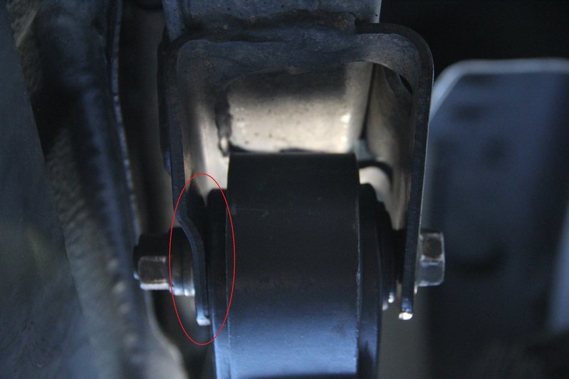

    1st gen here, but i guess this applies to the 2nd gens too. For the ones that complain about the squeaking from the bushing area, check to see if your bushing isn't doing this.

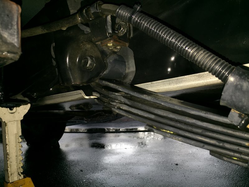

    I did like others and disassembled both sets, sanded, primed, painted, pond liner, and greased. I did install poly bushings though.

    I think that pack has been drilled for isolators
