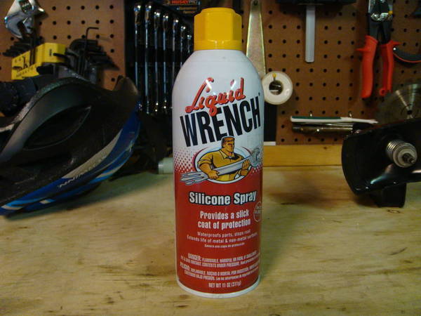

    i spray this stuff on the eyelet and the u bracket that hold the leafs in place and sty quiet for a few months. it seems they squeak more in the winter than the summer.[​IMG]

    Did you try it ?

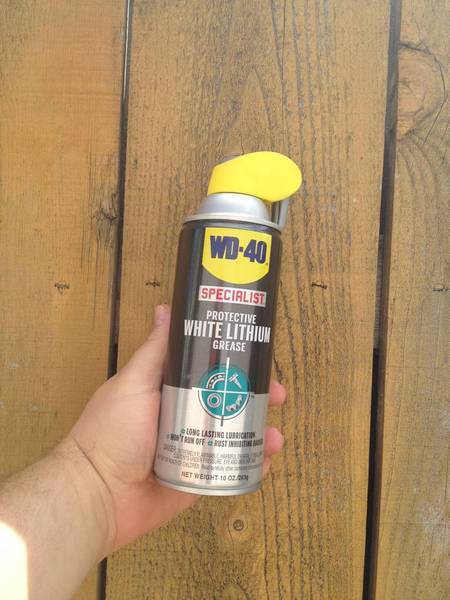

    I would not suggest a silicone based spray lubricant, it tends to be a bit aggressive on the rubber bushings.
    I would recommend: it sprays on wet and drys.
