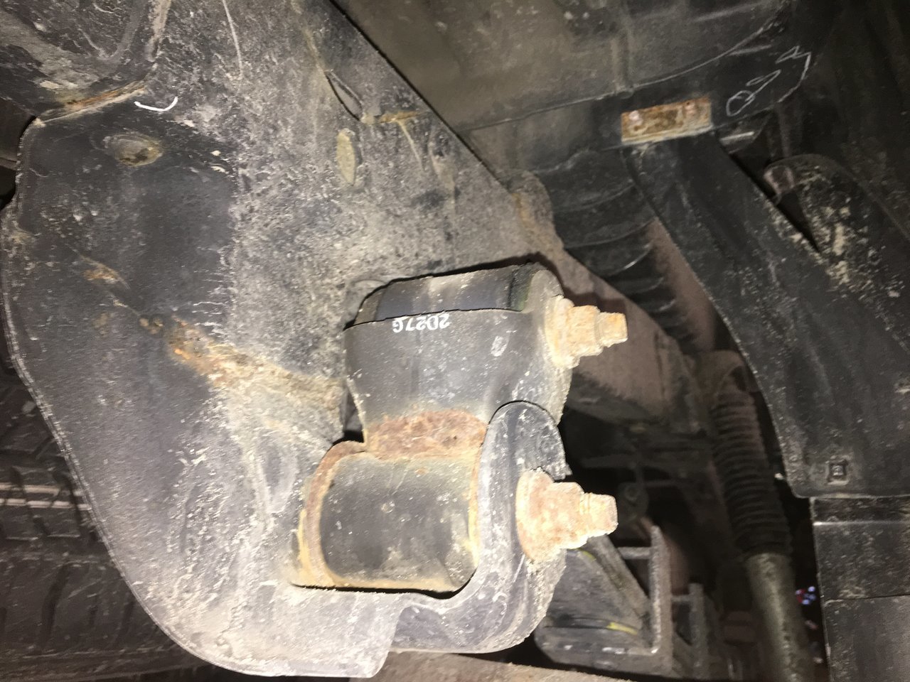

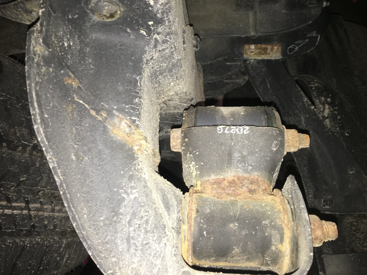

    Still haven't found the time to install the Dobinsons greasable bolts, but I did do an oil change on my truck last night. While the truck was on the lift, I was checking out the rear shackle. The bolt is installed from the inside. This might be the reason why Dobinson says that their bolts are for the front only..... but that's easy enough to work around. Even if I have to install the bolts the opposite way and cut off a few threads for clearance, that shouldn't be a huge issue... or install the bolt from the inside like OEM and replace the straight zerk fitting with a 90 degree one. I don't see any reason for the Dobinsons bolts to not work on the rear shackle. Excuse the New York State rust. This is why we have frame rot recalls. Lol

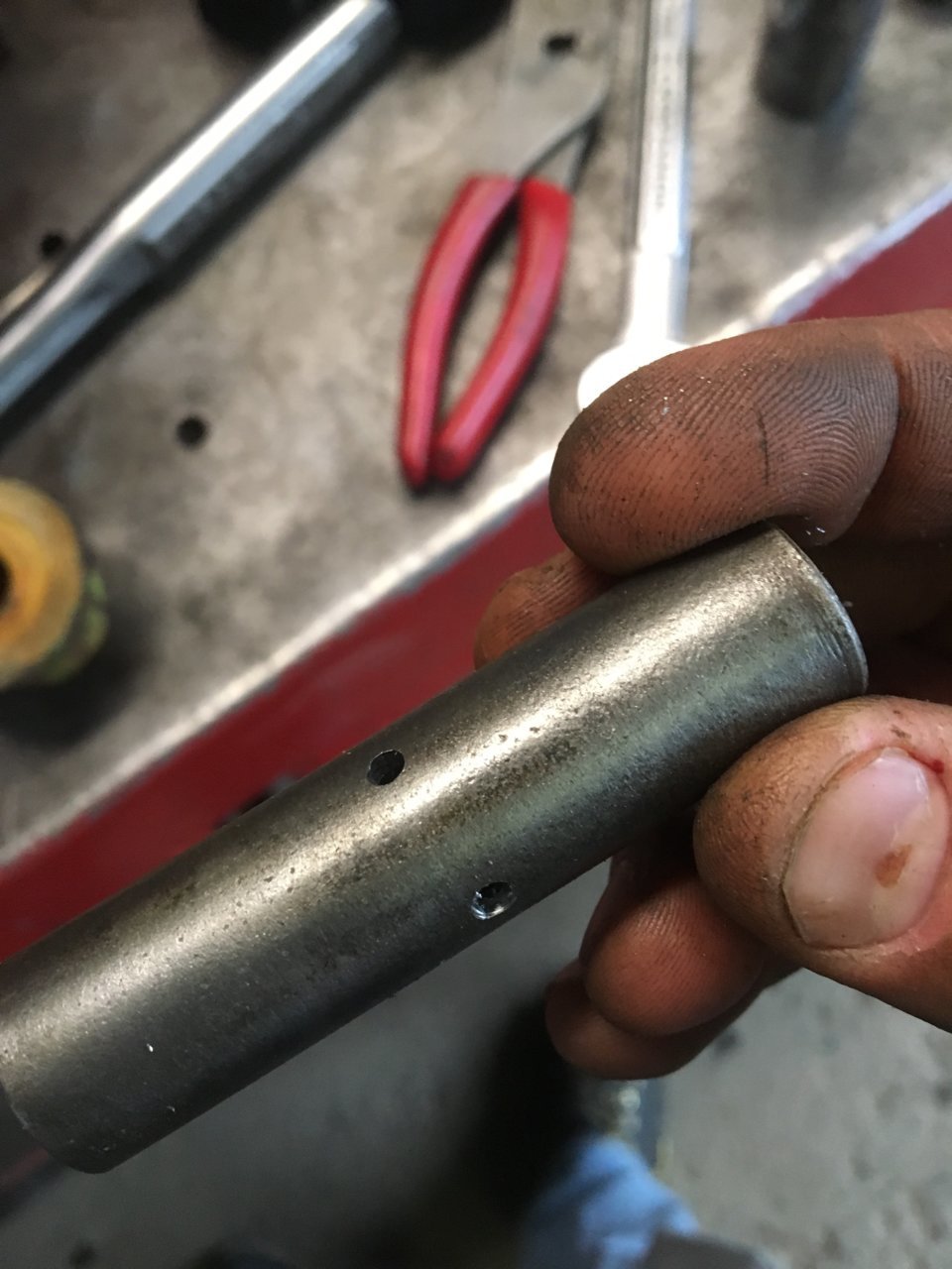

    Finally got the Dobinson greasable pins installed front and rear. The inner sleeve had corrosion from the lovely NYS salt.... presumingly causing the squeaking sound. I cleaned the sleeves up with my wire wheel and then cross drilled holes in the center of the sleeves. Cleaned up the poly bushings and reapplied grease to everything and reassembled. Applied grease to the zerk fittings and no more squeaks. I did cut off some threads on the rear bolts so they wouldn't hit/rub. I'll be applying grease every few days for the next few weeks. I didn't take many pictures, but I'll try to get some tomorrow. Cheers to no more squeaks!
