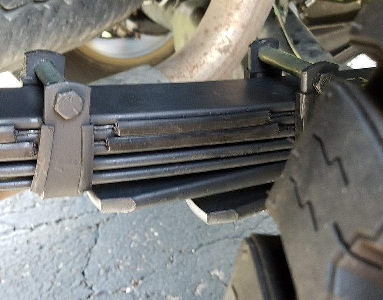

    Those are their anti squeak pads or whatever they're called. They should have a opening on the bottom side so you can insert a grease gun needle and grease them.

    Cool. Did not know that. Fortunately have a grease gun with needle.

    Hows the non squeak holding up with that grease ? I believe I have the updated dakars ...there are holes in front and back up through the isolater pads ,i took my grease gone and pumped some grease in until it was gooshing out between the leafs ...noise gone for now

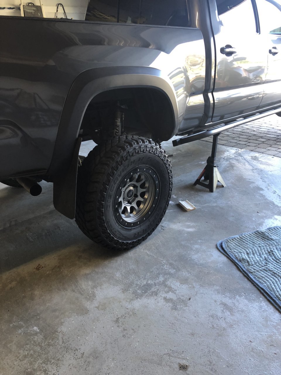

    ‘17 OR DCLB. VF Tuned, 5.29s, Dobinson’s MRR
    OVTuned w/ 5.29s 2” lift on Dobinson’s MRR paired with ICON RXT leaf packs. SCS RAY 10s Toyo Open Country AT III 285/70R17
    Squeak is gone!
    I just removed the two overload springs and re-installed my 1.5” block to improve ride quality. It’s perfect and no more noise.

    1,236
    I know.
    The leaves were worn to bare metal on the contact surfaces as were the leaf retainers.
    For ride quality, I am of the opinion that the truck is just not heavy enough to compress the overload(s) and therefore it’s like hitting a bump stop any time they are engaged.
    For the squeak, I’m not quite sure but don’t care because it’s now gone.
    Without the overloads, the truck can actually use all 10.1 inches of travel rather easily and my Fox DSC clickers can do their job properly.
