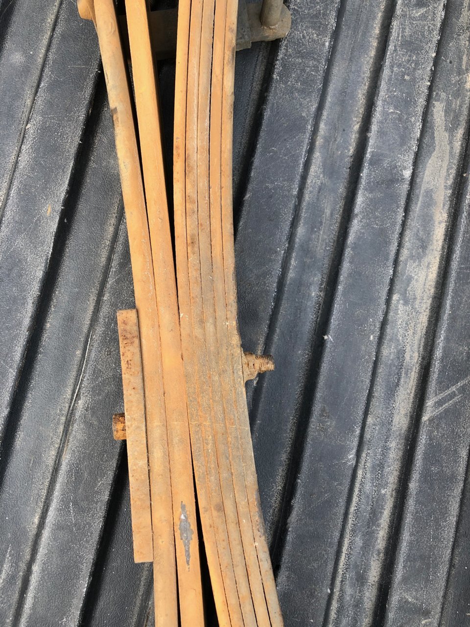

    I just ran into this with my progressive AAL from Wheelers. The bottom 2 leaf's don't have any silencer pads and it is metal to metal contact. I took my leaf's apart and wire wheeled them to get the rust an dirt off between the leaf's and paainted the bare spots. On the AAL part I took my dremel and took out all the sharp edges that were making contact with the spring and painted the bare metal. I got it all back together and it is quiet for now and hopefully for good. I have to retorque the u bolts in a couple of days. I hope I solved the problem. Will keep you updated.

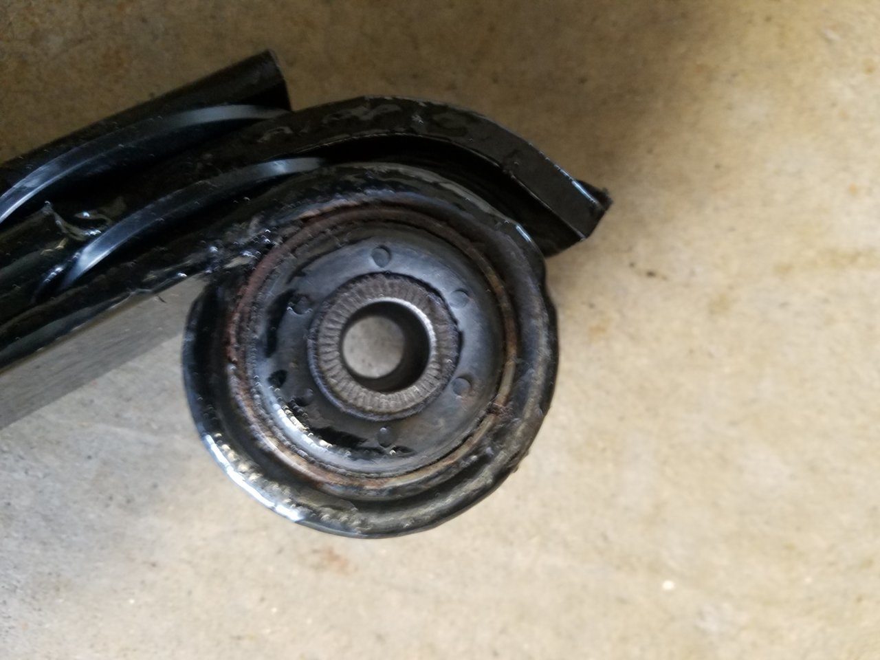

    I pulled my el095r dakars out this spring after 1 winter season and re installed my factory pack with a block because I couldn't handle the creaking noise any more with the advice from my local spring shop I ditched the poly bushings where it seemed my noise was coming from and had the spring shop press in factory bushings I then disassembled them painted with POR 15 installed the dorman 31067 anti friction pads and add a leaf to make them the hd pack reinstalled them and sounds quite so far will see what happens after a winter salt cycle20190928_093220.jpg 20190928_093148.jpg

    Update :
    Still quiet on the Western Front. I guess before putting any new or progressive AAL leaf springs in is to take them apart and make sure that the plastic pads are in place and that all the sharp edges are smoothed down. Repaint the bare spots to help keep the rust down. Hope this helps.
