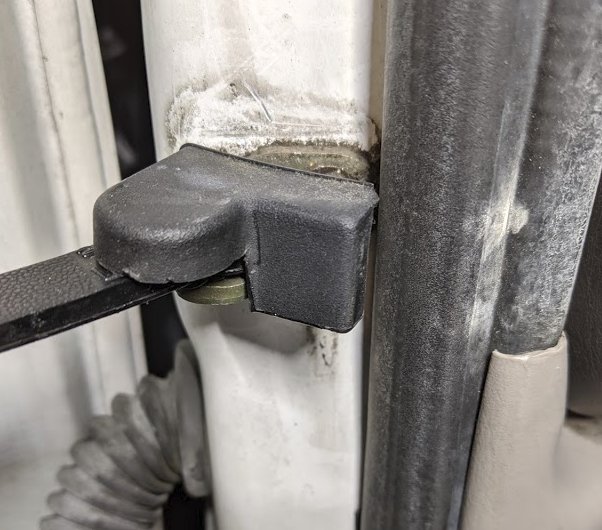

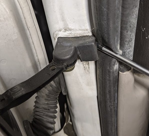

    Apologies - late reply.
    Yep, the black plastic piece needs to be removed. To remove, one of two choices -
    1. Pry or pull it towards you or pry it up

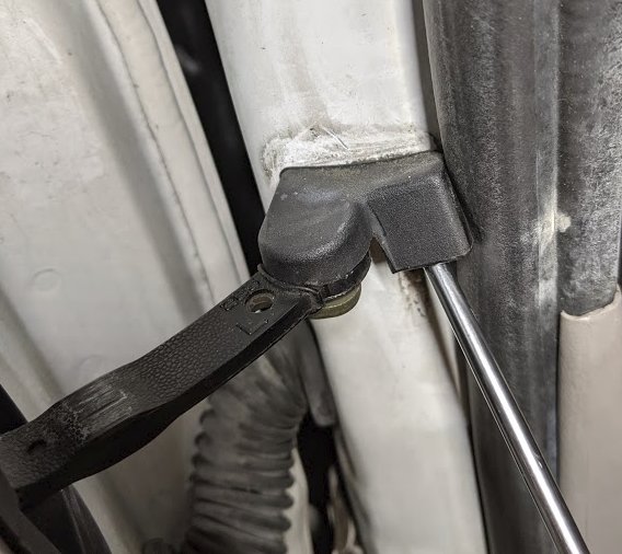

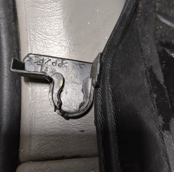

    This is the bolt which may have loosened slightly (on my 2002, it was fine - the lower hinge was a little loose) -
    2. When replacing the plastic piece, slide it back into place -

    is that part sold individually? (in case it breaks)
    now I gotta hunt down a plastic or rubbertipped screwdriver

    don't stress - its fairly durable. I was using a regular screwdriver and just forcefully pried it upward from the side in the pic. Damn thing popped loose and flew. hahaha Should be fine.
