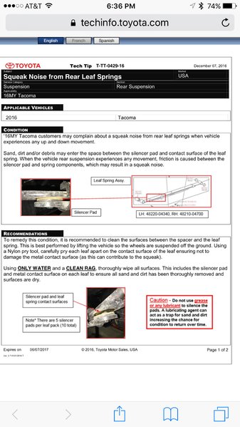

    TSB came out 2 weeks ago
    DjSamthrax and RBfastback like this.

    That appears to be a Tech Tip (TT) not a TSB
    TRDSport10 likes this.

    My bad the TSB was for the driveline

    Just dropped my truck for 20k oil change and sunshine treatment. Mentioned tech tip for the leafs and they were aware. They know me by name at this service department BTW (shocking I know). They're going to clean out my leafs and change the oil. Said it would take an hour total. Nice and slow today.

    Service advisor applied the tech tip. It seemed to work for now. We will see how soon they start squeaking again. He SPECIFICALLY said their tech instructions are NOT to lubricate the leafs or any components on the leaf assemblies FYI

    Like firearms in a sandy environment, too much oil traps debris. While it decreases noise and scoring it can causes a wet sanding effect. Using SOME lubricants though should work fine though. I'd think a graphite base would work awesome.
    The tech tip does seem logical. Will be interesting to see if they have standard part numbers for this or if it's what techs have handy to space the leafs.
