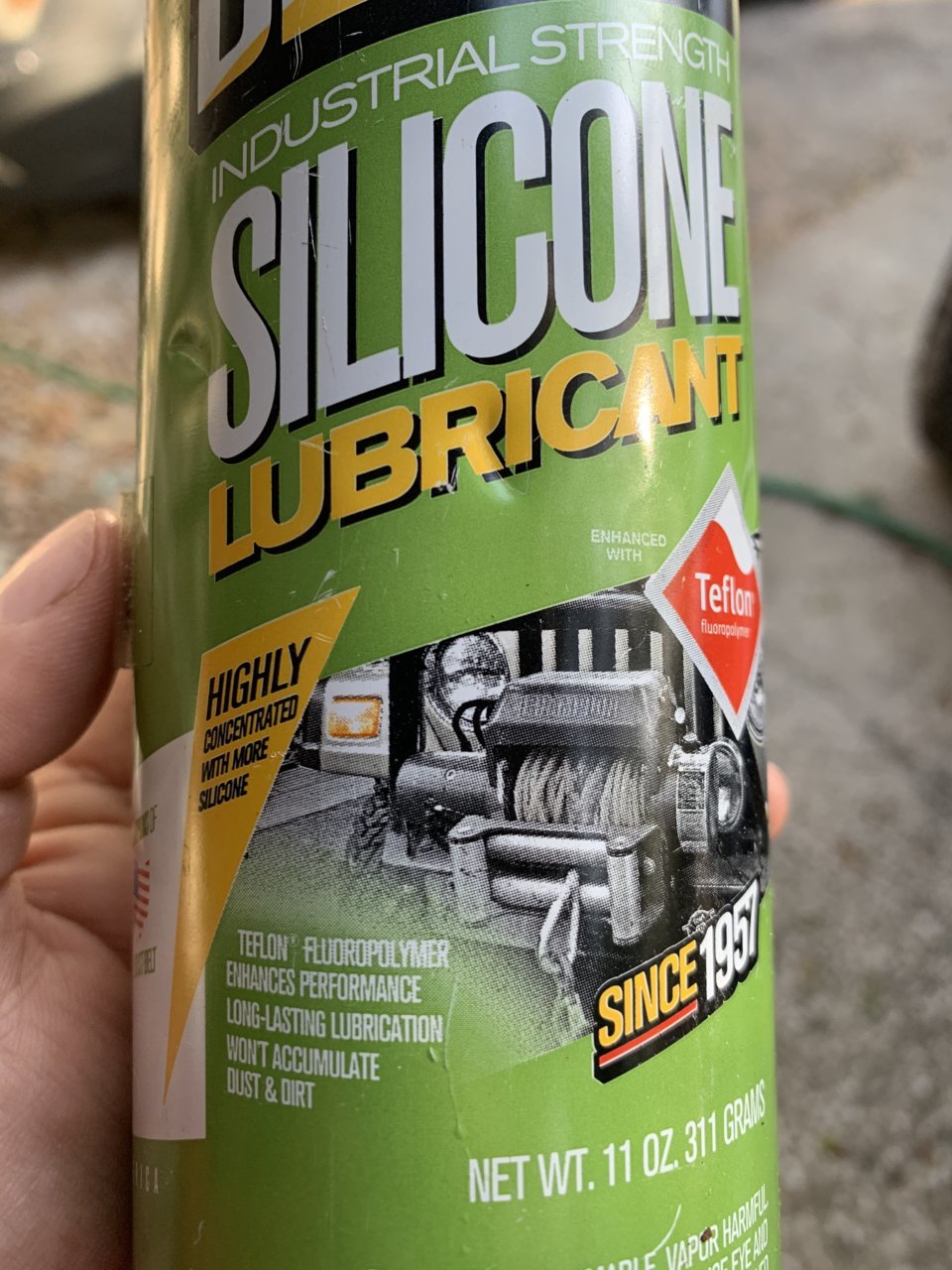

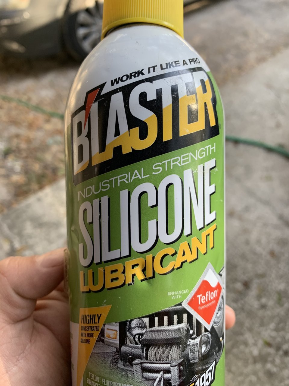

  17. Feb 7, 2020 at 1:25 PM
    #137
    gage mgm
    gage mgm Well-Known Member
    Jan 12, 2017
    #207325
    52
    Florida
    18' trd offroad 4x4
    B6731262-27EC-4CB4-AE73-C90A2C96CA15.jpg CF33DD11-ABC5-4F57-B85F-D99CAE2A884C.jpg
    Has worked for me pretty good so far havent squeeked in a couple months
