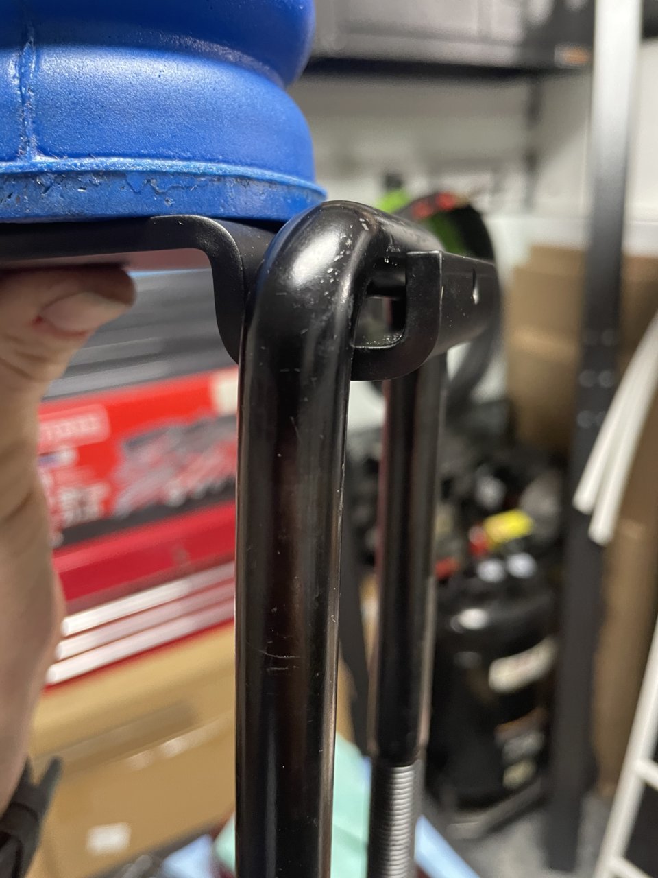

    Did you reuse your stock ubolt with both the aal and sumo? If you replaced did the new ubolts sit completely flat on the sumo bracket? If so what brand ubolt? Mine don’t sit flat (on a dry fit) but only contact on the edges

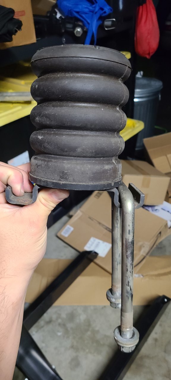

    Yes I resued stock u bolts. They sit flat in the grooves I'll get a pic tomorrow and post it

    I forgot took them out when not camping lol. But yes they fit in the grooves. Take a pic of yours and I'll tell u if correct

    Pic is a dry fit with the sumos and the included ubolt from the 3leaf aal. You can see it touches the edges and gap between not sitting flat. I don’t think I could even use stock length ubolts with the 3leaf and sumo

    Ya the u bolts might be a bit thick. Trying going to local auto parts store with your sumo and u bolts and ask them to find one that's right size and length

    These are what mine look like. Found an old set of stock u bolts I had from my truck
