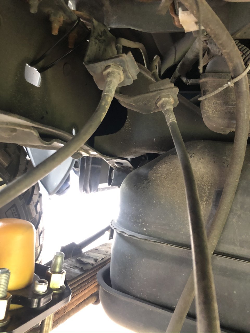

  20. Aug 9, 2020 at 4:30 AM
    #200
    Chris(NJ)
    Chris(NJ) Well-Known Member
    Jan 21, 2010
    #29777
    5,048
    Usually in Central Jersey
    08 Indigo 4x4 DC OR
    Mods are currently being changed .....
    I've had Dakars on my truck for about 75k now and always thought the squeaking was from the springs b/c I kept reading everyone's problems w/ them. It wasn't bad, only when the rear was going over a speed bump, or something like that which cycled the rear suspension. It as more of a high pitched squeak too. Anyway, I was removing the axle shims yesterday and when I was unbolting the brake lines, I accidentally found the cause of my "leaf spring squeak"! The edge of the upper bracket that holds the brake lines was rubbing against the frame rail. Since I can't bolt that bracket down, I zip tied it and sure enough...NO MORE SQUEAKING!
    Pic of culprit, all tied up with nowhere to go anymore.....
