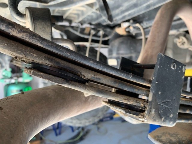

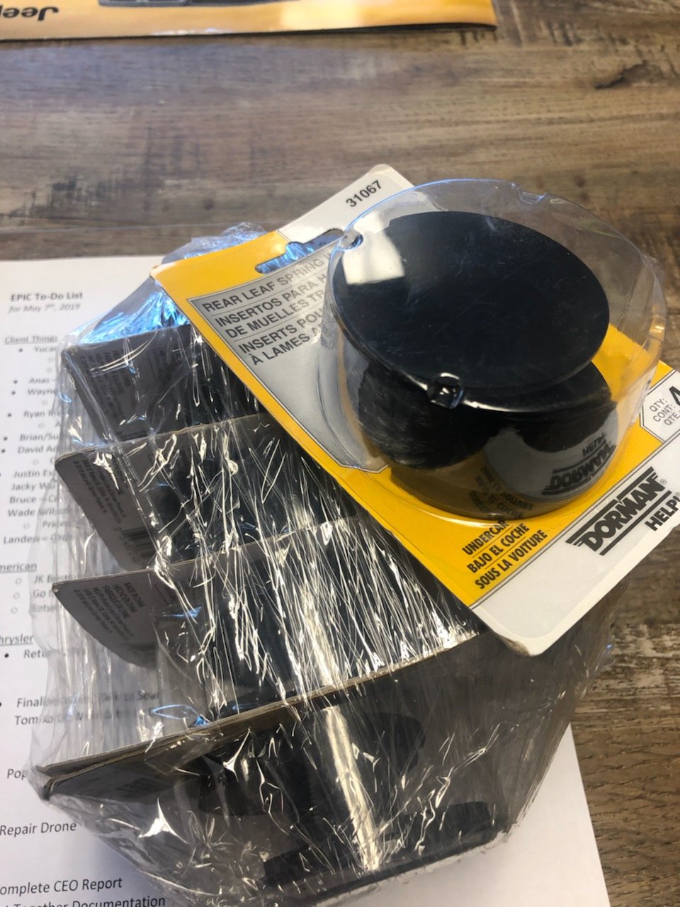

    ^THIS... so much this. I just replaced all my yellow pads with these Dorman pads and all the horrid, awful, ear churning, nit-picking, infuriating god awful creaks and squeaks are gone. Let's hope this lasts.
    I used 8 packages (16 pads) for my OME Heavys. Some of the location inserts have to be ground down a bit if the neighboring leaf overlaps a bit. As an added bonus they are a bit thicker than the old ones so a bit of gap is taken up making the springs wrap a little less when accelerating. $40 well spent.

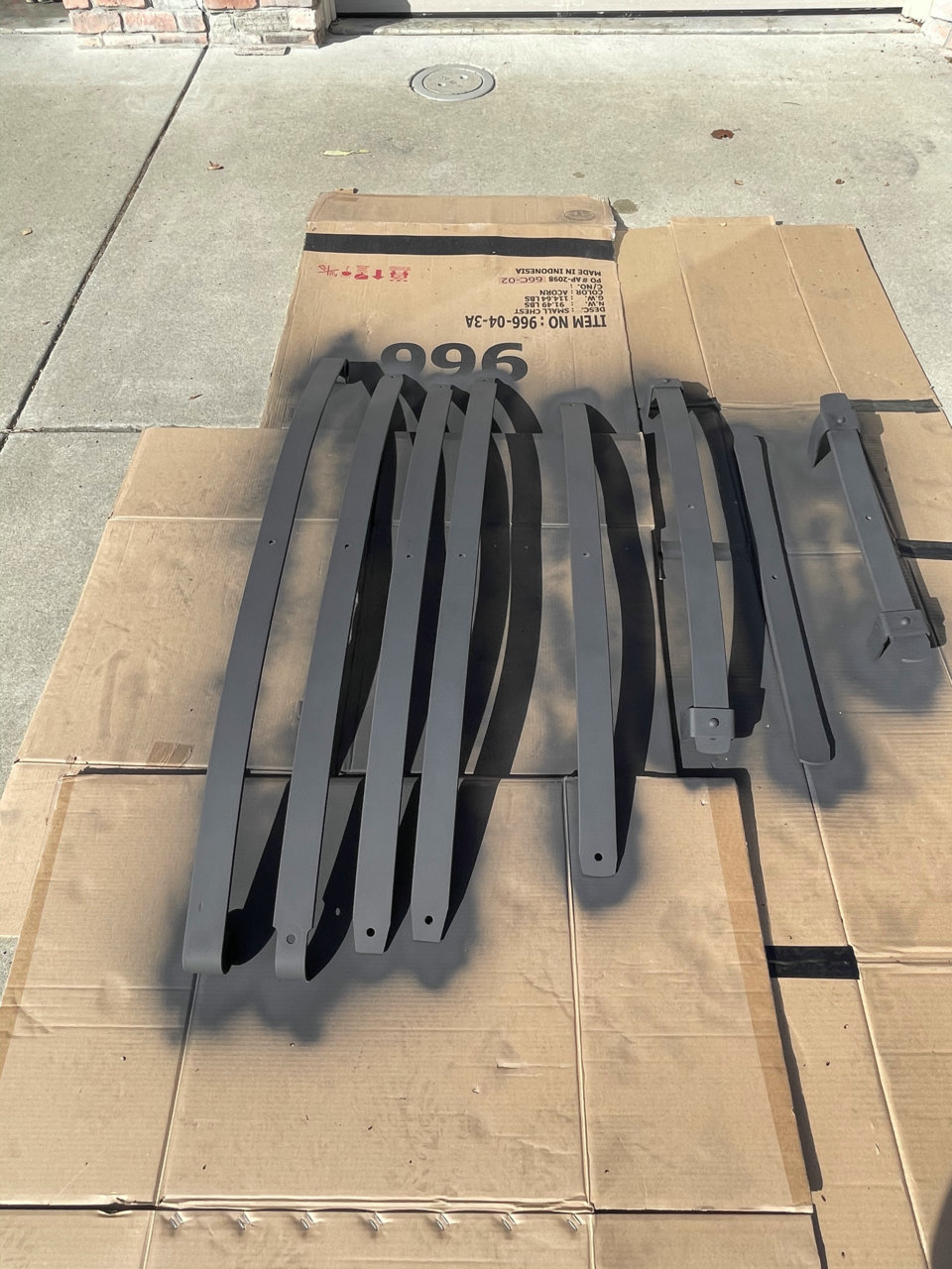

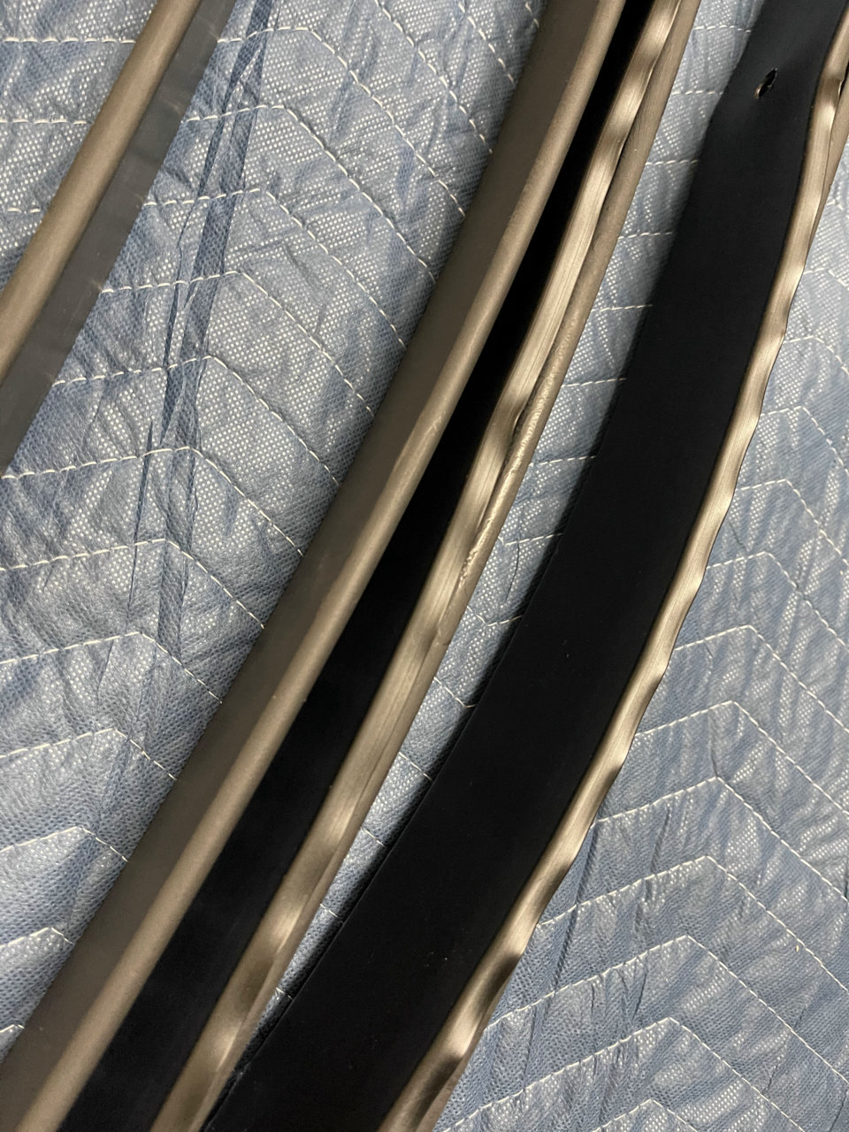

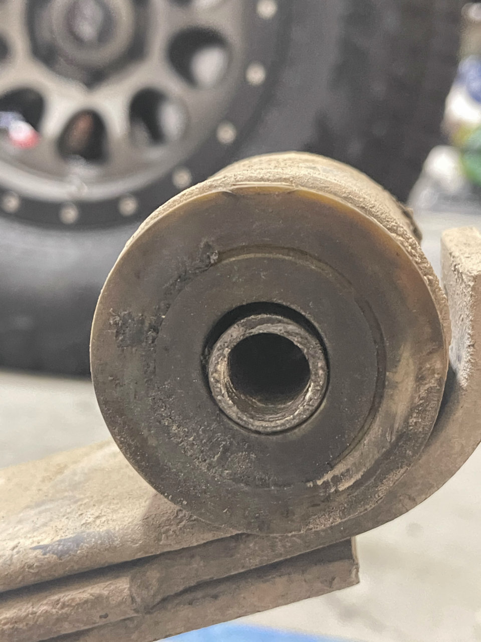

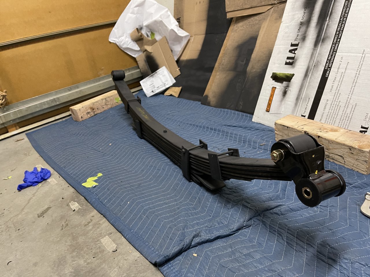

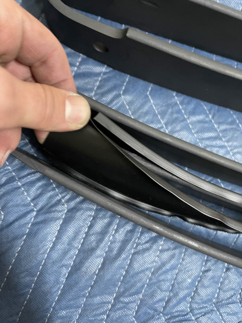

    So i ended up taking apart my leaf pack to add a leaf and discovered that all of my bushings were shot. I took the leaf pack apart and found that there was rust in places not just where the original yellow pads were which indicates to be an excessive amount of rubbing and water getting between the leafs (possibly due to the yellow pads which had worn out). I ended up grinding of all the old rust, repainting, adding a leaf, changing bushings and I added the speedway liners). i also added the Dobinson greasable bolts which BTW require some modification to fit the archive garage hammer hangers. 500 miles post new liners have had 0 squeaks and I've taken the truck through snow & dirt since then.

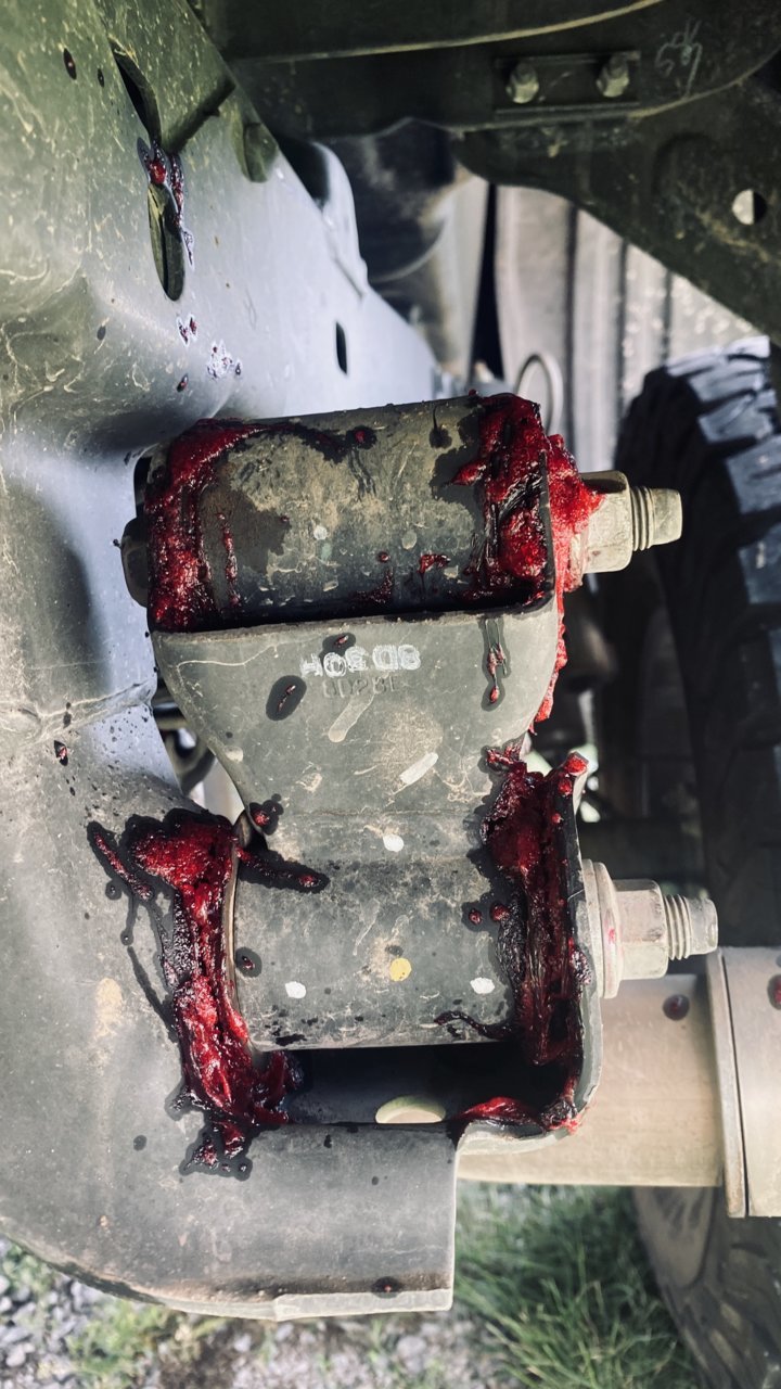

    Sprayed Motorkote on my squeaky Dakar leafs in Spring of 2019. They just started to squeak again last week. I pressure washed then followed by another Motorkote spray on the bushings and pads - squeak-free again. Just sayin, it's a hell of a lot easier than taking those things apart.

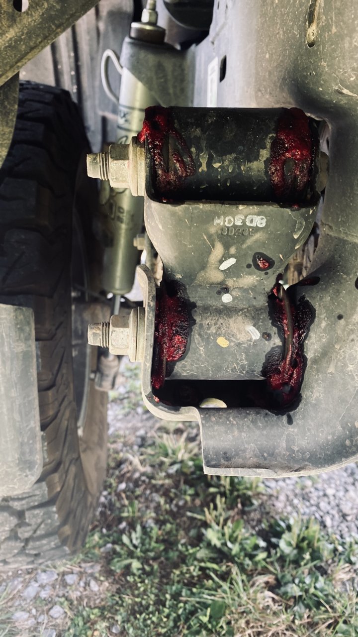

    I can't find my last comment on this thread about squeaking, but I still haven't had to do anything as far as squeaks go. I just jack up one wheel and hit it with Red and Tacky through a needle valve. I'm sure other things work or help, but I've had good luck with my method. I don't wheel my truck as much since I got my SxS, but my truck tows it's ass off. I feel like it gets a good work out.
    I did check my hangars and I do have a minor rub spot, so I might eventually pull my leafs and grind them down and then install new isolators linked from this thread.

    I jack up one wheel and use a screwdriver to separate the leafs as much as I can and grease the whole leaf, not just the isolators. Needle valve makes it fairly easy to get in where you think it's rubbing.

    figure out how many you will need depending on how many leafs you have. i have the HD and I added a leaf, so I needed 3 rolls. these are still going strong....truck sounds like it should in the rear suspension....silent
