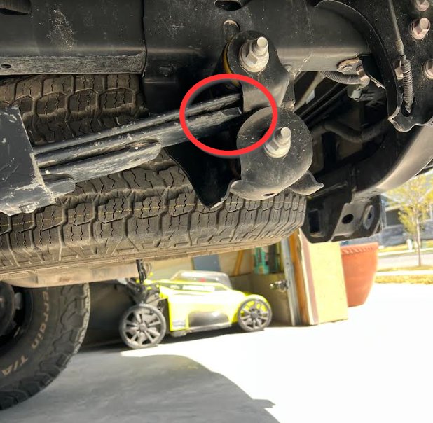

    I followed the TSB listed earlier in this thread and holy shit i'm so happy that i got this creaking noise fixed. I was at my wits end with that noise! Just jacked it up one side at a time. Spread the leafs with a pry bar and used a putty knife and spread the lucas oil red n tacky on them sumbitches and creak go bye bye. Took maybe 30 mins. 10 of that was sitting there in disbelief that i should have done this years ago while sipping a Yuengling.

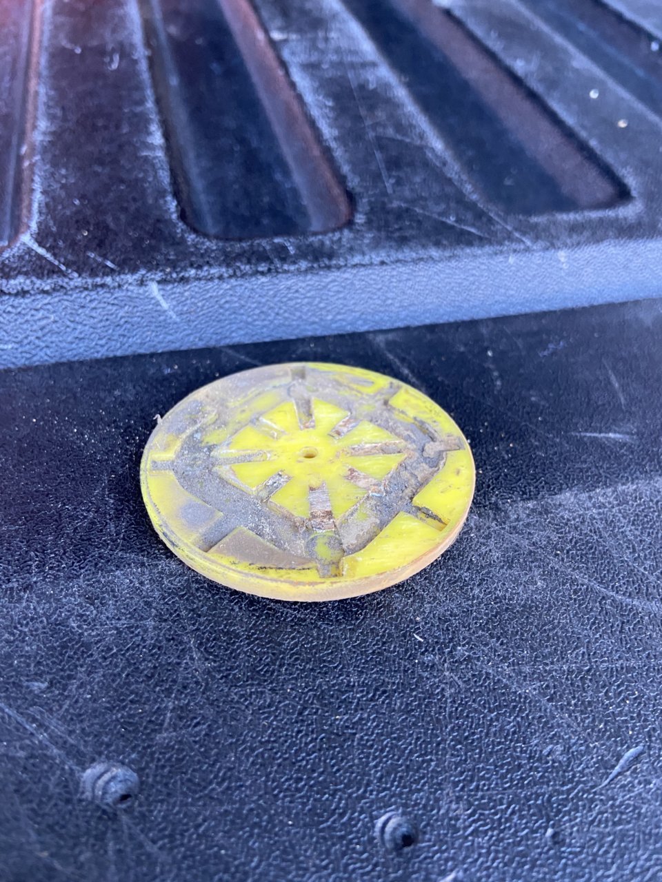

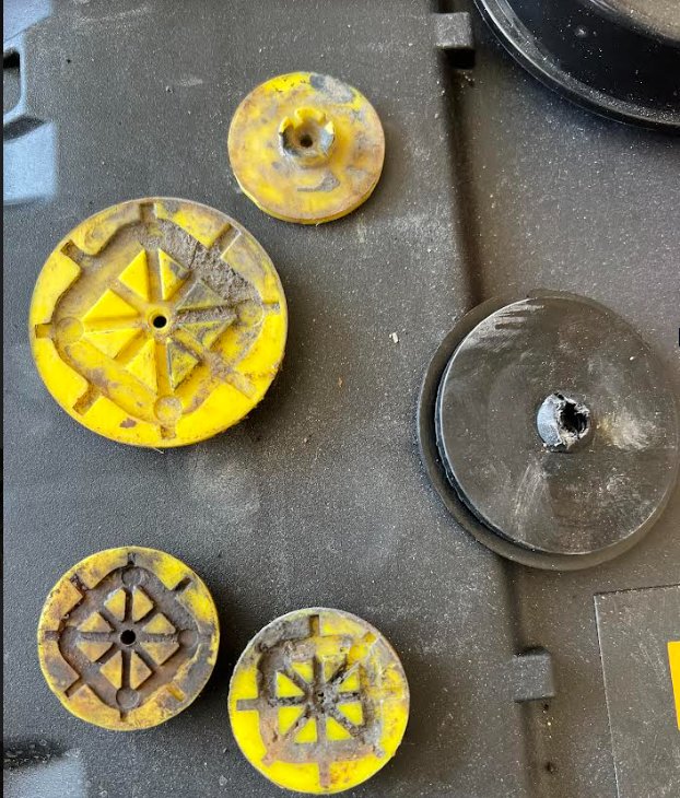

    This, right here, 90% of the problem. Why they don’t ship these with and rubber on the isolators I will never know.
    C1742896-0ED1-4506-8A50-382E9D565463.jpg 080B13FC-A246-4D8A-A3B1-50E4CECE8825.jpg
    So this is the perfect fix! It’s listed many times here, but this was a simple fix. Jack the truck from the frame, not the axle, let the seuspension sag, use a crow bar and pry the ends of the leafs down. Use pliers (NOT YOUR HANDS!) to remove the old isolators. Place the new dorman isolators in and align the holes with the pegs (with pliers, if the crowbar slips out you’re gonna loose a finger). Release the crowbar. Give the end of the leaf a whack with a deadblow hammer and it will seat the isolator. Problem solved. You will need to trim the inner isolators tab to about 1/4”. No more squeak.
    Dorman 31067 Rear Leaf Spring... https://www.amazon.com/dp/B000TYU0FM?ref=ppx_pop_mob_ap_share

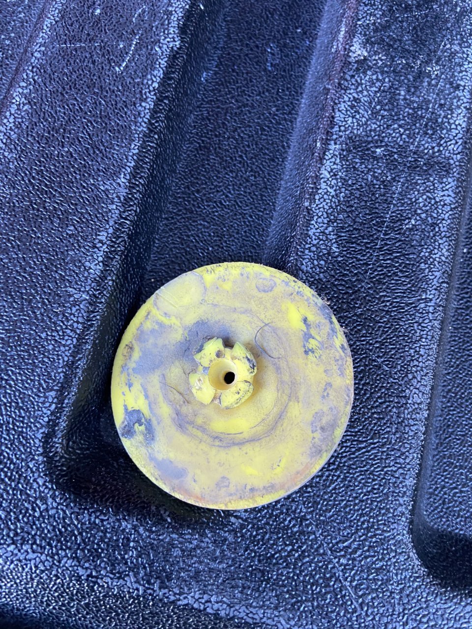

    For me the squeakiest ones were the small ones by the end bushings. I greased them and that would only last about 3-4 days before squeaking again. They're about 1/2 the size of the normal pads (35mm in diameter) and there's 4 of them. Got them out with a prybar and some screwdrivers, wasn't too difficult. Had to cut down the Dorman pads to size, but since I put them in there it's been blissful silence. They've been wet they've been muddy, so far not a squeak to be heard. Hopefully they hold up, but if they don't they're not that hard/expensive to replace. Better than squeaky. Such a relief! Thanks y'all for the research and suggestions, I love this forum.

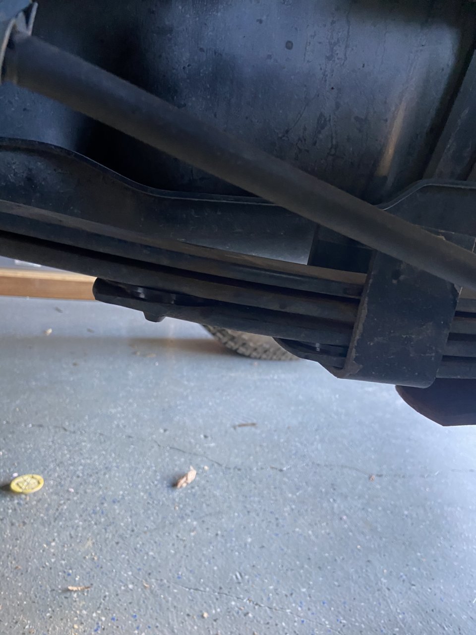

    18 Tacoma TRD off road OME BP51 front Fox 2.0 Resi rear OME Dakar Meduim Yoko G006 325/75r16 Black Rhino stadium wheels Cali raised ditch light brackets Baja Designs S1 pods Baja Designs Squadron SAE fogs Prinsu Cab rack TRD Pro grille AVS rain guards Backwoods adventure mods hi-lite bumper BL Apex 12k winch Dobinsons 4x4 snorkel Sy-clone prefilter ARB rear diff breather relocation RRW rock sliders RCI full skids At the helm bed stiffeners lil b LCA skids Warfab Phantom rear bumper Warfab tie rod sleeves C4 fender liners Dirt king UCA Duro bump stops

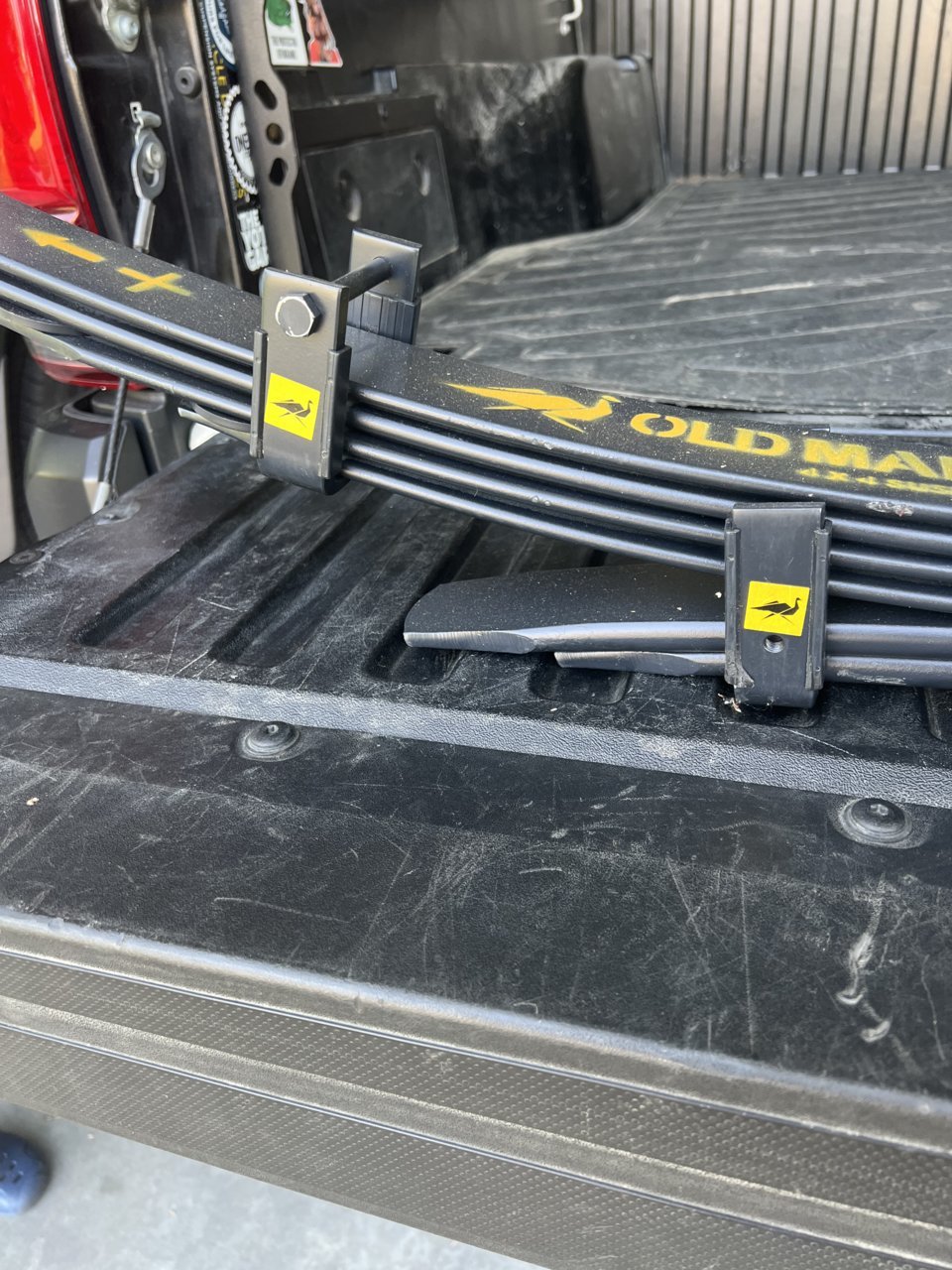

    Just got a new set of Dakars
    looks like OME may have changed a few things. Hopefully these don’t squeak like the older versions.
    They’re painted, rubber protectors on the rebound guides and silencers are different.

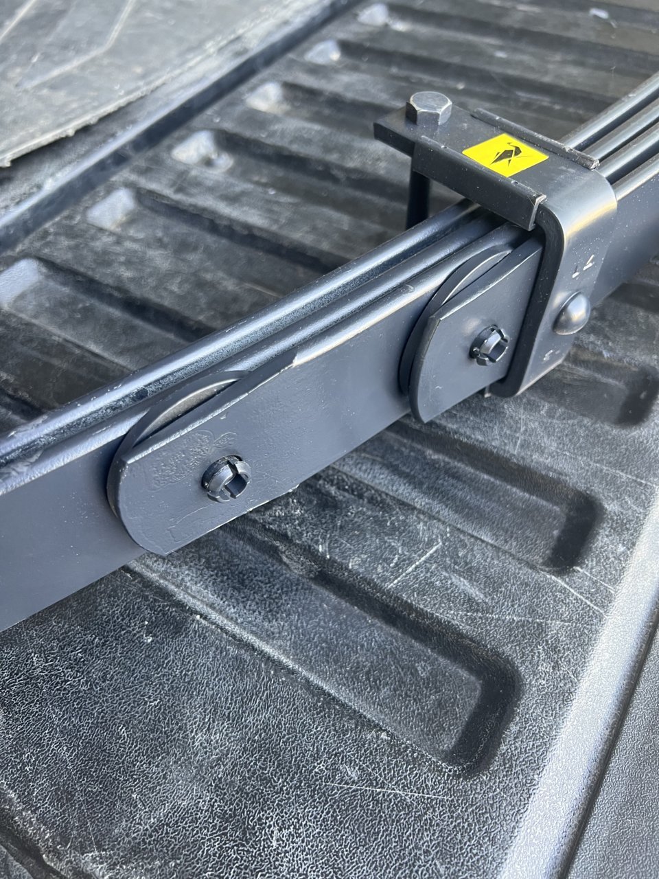

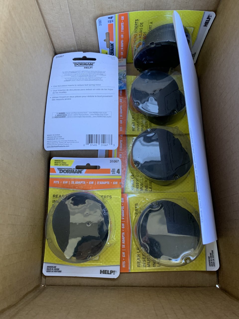

    These just arrived. I am praying for sweet silence……so I can hear all of the other creaks and rattles.A9A75872-62A7-4B29-8D25-1C4BED4F6A78.jpg

    The silence is beautiful. I'm so glad I found this thread. One of the easiest mods I've done too.

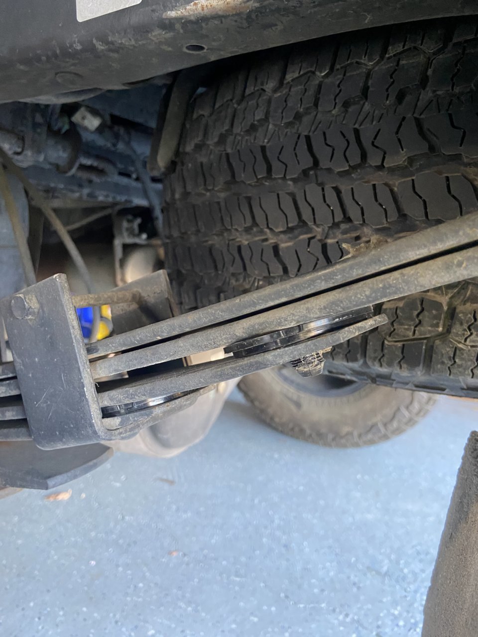

    Noise with this leaf pack is going to vary widely.. think about all the variables involved with each of our applications. Region, driving conditions, weight, etc.. Jack up the rear of the truck, lower onto stands at the frame on driver/pass side of truck so the rear hangs. Grease gun with a needle and a pry bar and screwdriver. Pry each spring apart near the pads, then insert screwdriver to keep them apart, you apply grease onto the top/bottom of pad, but I also shot grease up through the hole
    at the center of each pad from underneath as it was obviously designed to allow. I instantly went from constant squeaks to silence. With each leaf open I could see small rocks that made their way in and were the most likely culprit of the noise and was able to clean them out. It’s easy to do, takes less than 30 minutes, and will resolve the noise issue.
