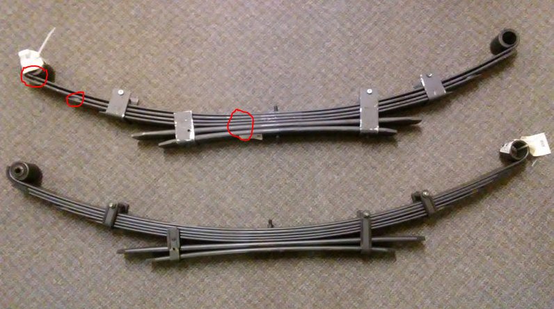

    jack up the truck from the frame so the load comes off the leaf pack a bit.
    I use Red N Tacky aerosol with the little stray attachment.
    Spray the end tips where it curls inward to the leafs, most of the squeak I get is from there.
    Pry each leaf to expose the isolator pads and spray directly on top of the pads.
    Pry closer to the center of the pack and give each leaf a blast of lube as close to the center as you can.
    I don't get any squeaks until I hit up some real mud caked trails and have to really blast my truck with the pressure washer.
    Could add it to your list of general maintenance when you do oil changes and tire rotation too if you want, really doesn't take more than 2mins to do.

    I appreciate everyone's contributions to this thread. After 5 or so years my Dakar EL095 pack with the yellow isolators had been getting noisy for a while. I had been lubing and greasing them over the last few years with only minimal improvement that was short lived. Some of the isolators had worn down to the point they no longer had grooves in them to hold grease.
    I just installed the Dorman Isolators today and first impressions are silent. Hopefully long term this proves to be a permanent solution.

    The isolators appear to be doing an excellent job of keeping most of the noise away. However, they have allowed me to pinpoint my poly leaf bushings as the remaining source of noise under flex. I've been able to confirm this by soaking only these areas with penetrating oil and achieving short lived silence.
    I will attempt to use a needle attachment on my grease gun to see if I can inject grease between the sides of the bushings and the shackle mounts.
