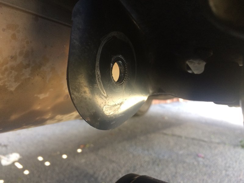

    As @geekhouse23 picture shows actually the rubbings in-between the spring eyes and the leaf spring mount. I use to spray white lithium grease in between which would help but got really messy and drys creamy color. I use an all purpose grease and honestly I haven't greased in the last 20k miles and no squeaking.

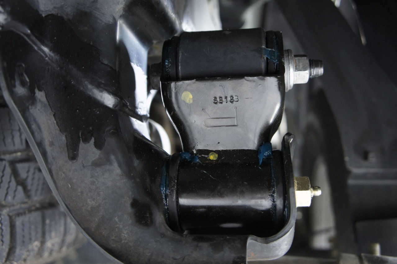

    are you using the greasable bolt on the front and rear or just the fronts?
  8. Dec 11, 2019 at 12:51 PM
    #148
    rnish
    rnish Well-Known Member
    May 9, 2014
    #129450
    8,618
    Peoples Republic of Maryland (USA)
    Tacoma 2nd gen
    King's, Camburg UCA, Dirt King LCA, armor
    I use the front eye and the lower rear eye. The top bolt rubbed so had to do stock.

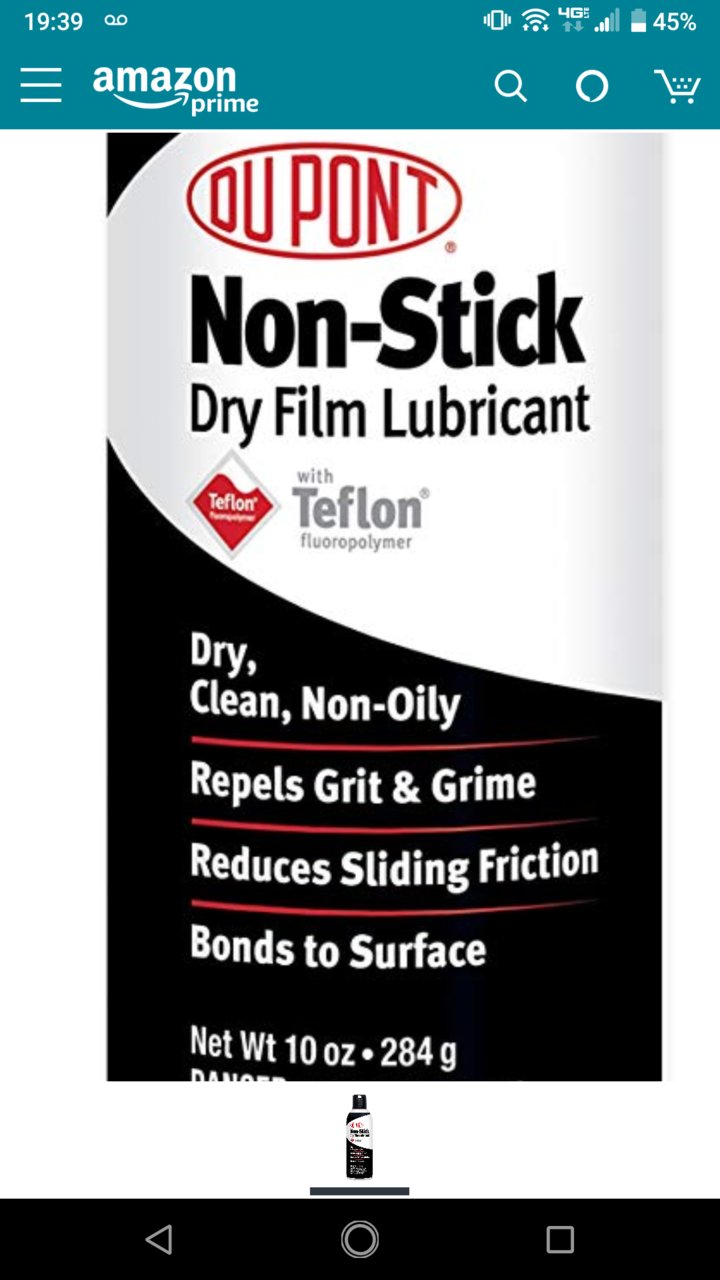

    On January 12, I lifted my truck with my hi-lift until the tires were almost off the garage floor. Then I sprayed this stuff all over the springs, hangers, etc. I bought it at my local ACE hardware.
    Anywhere the straw would reach, I sprayed until it flowed out. It's pretty thick, almost like spray foam insulation when it first comes out. Or maybe like silly string right as it comes out. It's thick and sticks well. I didn't spray the springs off or anything, and frequently drive on dirt and mud.
    I drove it right after and it still squeaked. I drove it the next day and I think it was better. I didn't drive it again until today and the springs are completely silent. I'm writing this post for two reasons - to share the result, and document the start so I can track how long it lasts.
    I'll try to remember to post when the effect wears off. Feel free to quote this or PM to ask for a current update if you're reading this... in the future...
