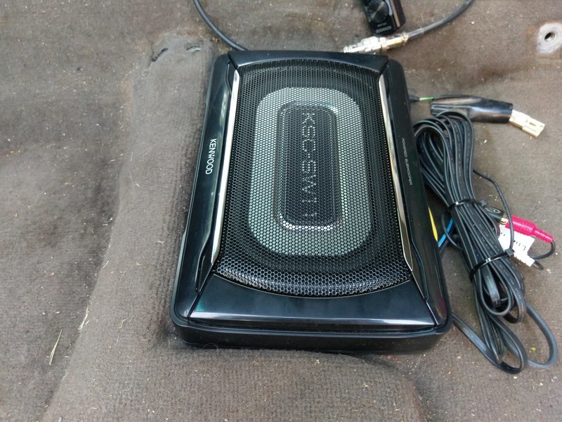

    Oh, and my little project for the evening.

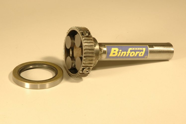

    There is no need to reinstall the tone ring if you do not have ABS. All e-locker rears come with the ABS provisions.
    The placement of the inner retainer is critical and recording the placement of the original should be considered a "ballpark". Depending if your truck came with the new or old style seal will be relevant as well as any deformation of the seal at installation. I install the inner retainer a little inboard and check the contact point against the installed seal. Then adjust as necessary. I put "Magic Marker" hash marks across the surface of the retainer. The lightly lubed seal will wear thru the marks with a few turns of the shaft and very accurately show the contact point.

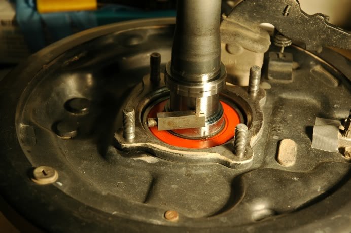

    Equally important is to check that the retainer is square to the shaft, they can go on cocked. Correct any wobble with a brass drift and hammer. If for any reason you need to move the retainer back inboard, a single hook on a slide hammer will do the trick, one side then the other (gently) and you can "walk" it back. This of course is if the tone ring is left off.
    Checking the retainer for wobble with an improvised "go/no go" gauge. Numerous other ways could be used.
    "New" seal vs "old".

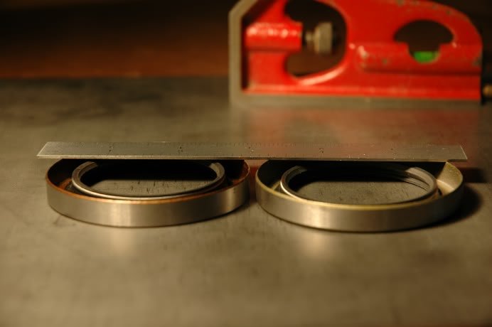

    Around your year Toyota upgraded the seal and the "lip" is now further inboard. Obviously this has a bearing on where the retainer is placed. It really becomes an issue when the seal is driven in too hard and gets deformed, this can effectively move the "lip" even further in.
    New seal on left, old on right.

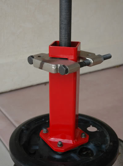

    If you want to fab a press fixture make sure the hole/tube is on the heavy side of 3.75" (diameter of the tone ring) Correction, 2.75". This will allow pressing off both retainers, the tone ring and the bearing at once. Assuming you remembered to remove the snap ring.
    This fellow works perfectly. It was made from scrap at hand. The square tube will not rotate enough between the rails of my press bed for welded on tabs, hence the need for the (removable) splitter, so use round tube if you can.
    The old tone ring welded to some stock, just happens to be the right size for a seal driver and contacts the seal at it's outer circumference, lessening the chance of deforming the seal. There is a service bulletin on this issue. More on that if you want.

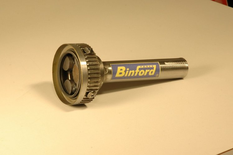

    The BINFORD ABS2000, with magna grip.

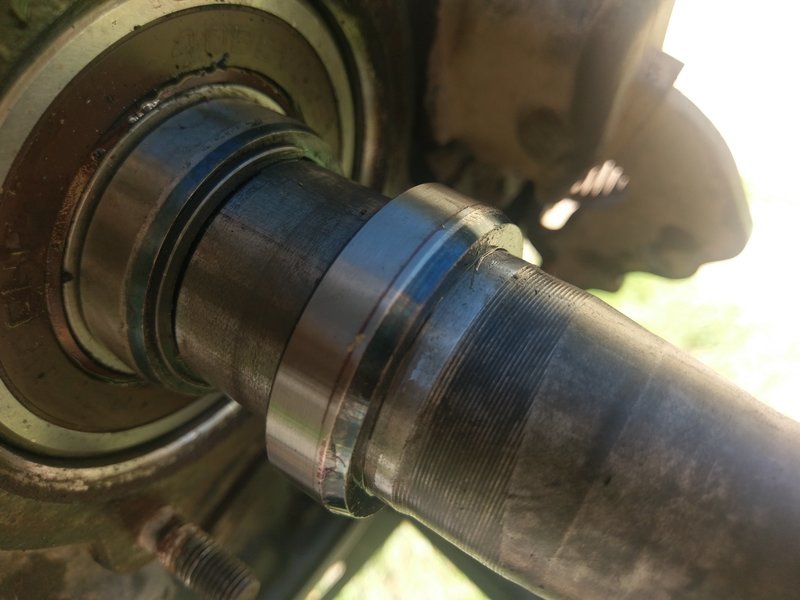

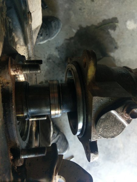

    So who can tell me where you want the retainer to ride on the seal? First try has it is just outboard of the bevel.
    Edit: FWIW I left it just a bit inboard of where the old one was, but I did notice the seals I removed were the old style.

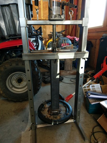

    Made an overly complicated tool that works. Have to unbolt the top of the press to get it in, but it's the best thing I could come up with given what I had on hand.

    First try.
    Left it inboard of the original location and it still wasn't enough. Had to bolt it up the the fixture and press it all back out. Was careful not to go too much the second time. Got it after a bit of guess and check work:
    That was quite the job, although a lot of time was spent fabbing the press fixture and messing with it to get it to work just right.

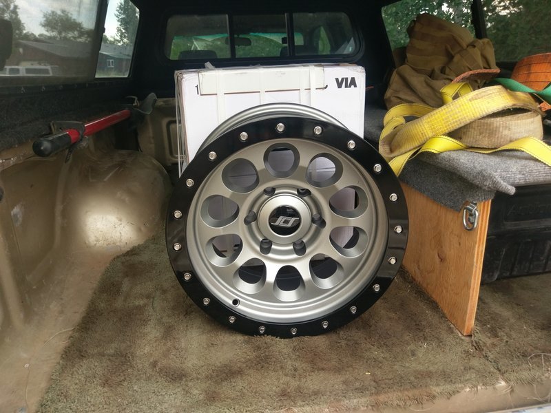

    Oh, and, :spy:
    Happy to land a set of 5 blems cause I know I'll be messing them up anyways. Now just waiting for Discount to do their $100 off $400 deal again.
