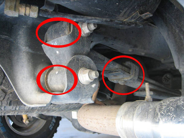

    After off roading in mud or water my leaf spring start making a squeeking noise. I took it to the dealer once and they said dirt had gotten on the friction pads between the leafs and possibly in the bushings.
    They said all they did to fix it was spray some sylicone based lubricant with teflon on the leaf spring friction pads and bushings. The noise went away for a year or so.
    A few years later, after my truck was out of warrenty the noise came back. So, I purchased some of that spray and now the squeak is gone again.

    could you by any chance post a picture of the part where you sprayed the stuff? i'm a truck/car noob and don't really know much about the parts :)

    Spray it on all these parts, and same thing on the front of the leaf spring.

    that perfect. thanks!

    thanks so much for this picture, will wd-40 work?

    If will eventually evaporate. Use something like white lithium grease.

    WD-40 will work for about a week.... i cant remb the name of the stuff i used but in sure someone will chime in on that
