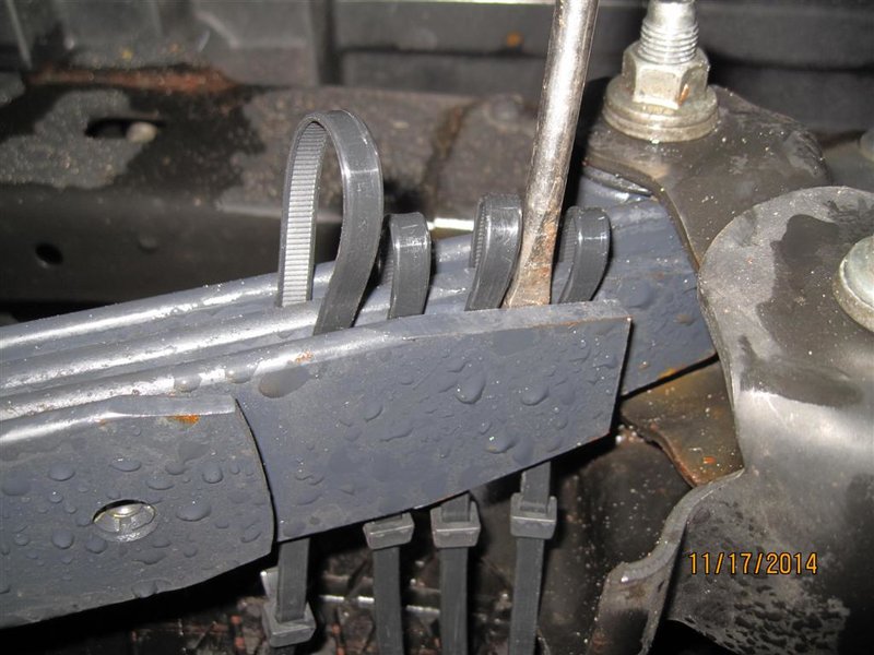

    Truck was on lift with tires off the ground, Pic below, shows old dull screwdriver between leaves.
    Went in no prob, and Ties will adjust without screwdriver before cinching
    I only installed 'em in the rear of leaves, as that's where the squeak was originating. No reason you can't do both front & back.
    Cable Ties are still in place, spankin' them squeaks.
    CC
