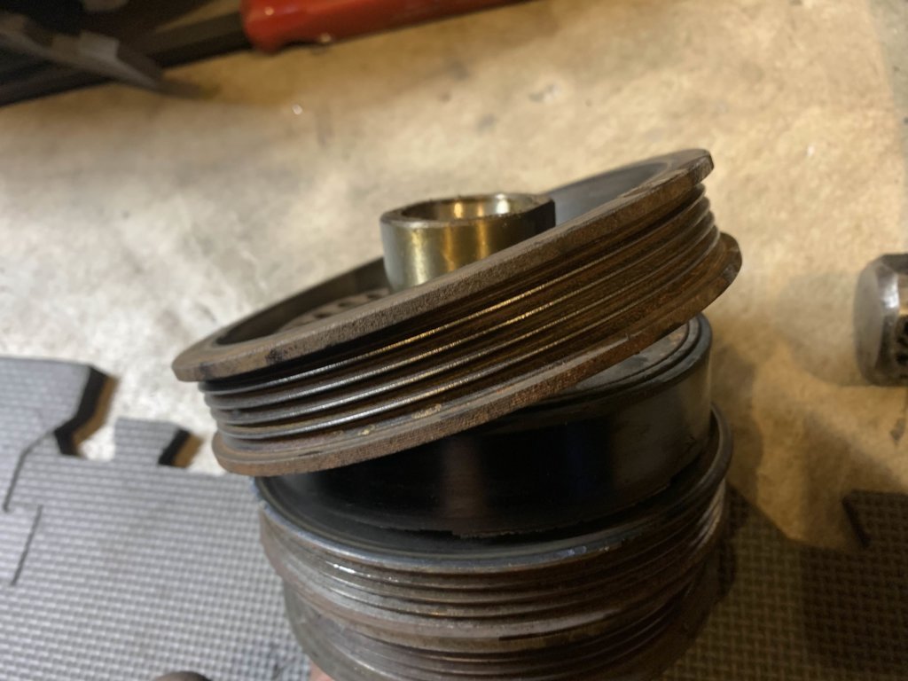

    this wasnt mentioned but check your harmonic balancer. do not over tighten your belts causing stress on your accessories and bearings.
    i was diagnosing a squeal and tightening the belts didnt solve it. previous owner actually over tightened some belts which had me confused. after scratching my head and looking at the pulleys closely i saw the harmonic balancer would wobble under load and squeal especially on startup.
    the pulley had separated from the rubber. this was the harmonic balancer on the 3rz. youll see problems like this on the 5vz as well.
