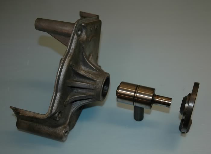

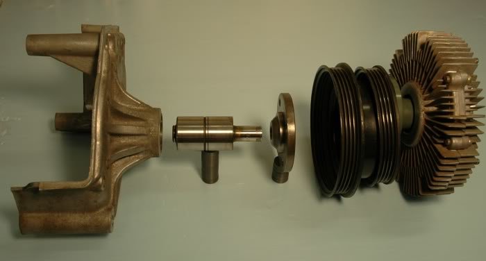

    Anyhoo, on the V6, after checking the belts and the AC idler pulley under the PS pump, a semi common "cold start only" squeak that sounds exactly like a belt, can come from what Toyota calls the "fan Support Bracket". It's a casting holding the bearing/shaft that the radiator fan/fan clutch spins on. It is sometimes called a "false water pump" because it looks kinda like a water pump. Usually this squeak/squeal happens on colder mornings in winter. As time goes by it does get worse and happens at increasingly warmer temps.
    A mechanics stethoscope is the best tool to use. Put the tip right on the casting as close to the inner pulley as possible, you will have to be quick.
    You can improvise this tool very effectively with a long screwdriver. Put the tip on the casting and your ear to the handle. The internal sounds will be telegraphed to your ear quite clearly. This technique can be used to "listen" to all kinds of stuff (hint), like alternator bearings or the fascinating slurp of a PS pump.
    A perfectly good stethoscope can be had for about $5 at Harbor Freight and worth every penny.

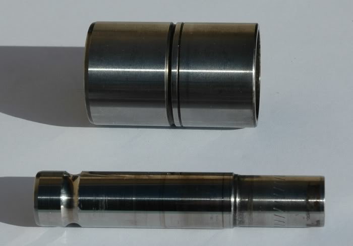

    Should the fan support be the problem do not get one from a dealer. Toyota only sells it as an assembly that includes a fan clutch, the pulleys and the bracket (everything in the top pic) for better than $400. The bracket can increasingly be had by itself through aftermarket parts houses that sell Aisin parts for around $125. You will get what is shown in pic #2, but all pressed together. Absolutely DO NOT by a Chinese knock off under any circumstances.
    The bracket can be taken apart but the actual bearing itself is a proprietary Aisin part that is just not available.
    EDIT, link for obtaining just the bracket
    http://www.macautoparts.net/ProductInfo.aspx?id=5990799
    From the Dirty Pool of visual aids, here's a few pics.
