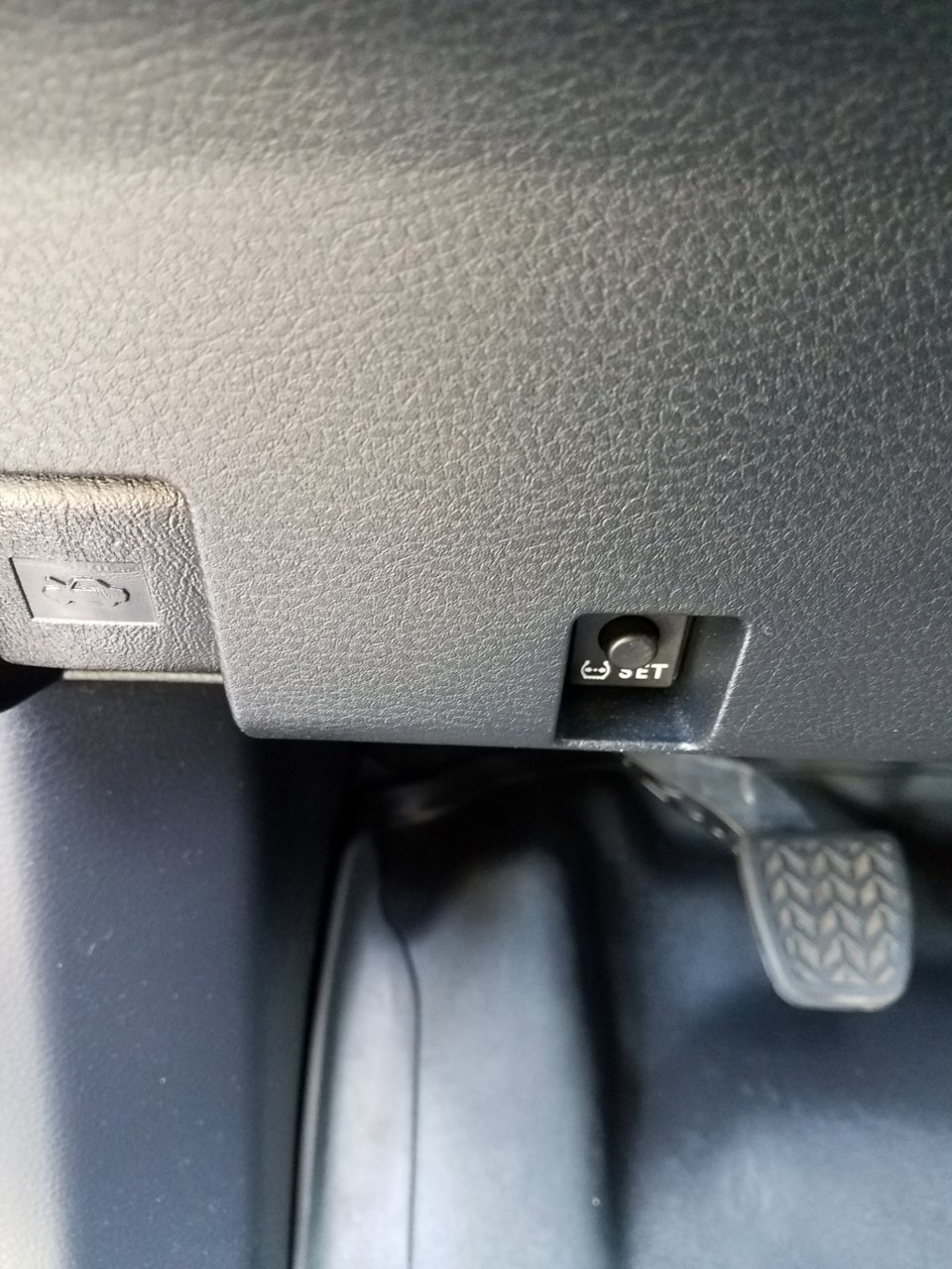

    I'm wondering if the 18s have this button? I looked and couldn't find the dang thing. I did drop to 30 and didn't get any lights however. I just wanted to know for future reference.

    I know mine is a 17 but maybe it would be in the same spot.

    I can confirm it's in the same spot. When someone explained it's under the steering wheel, I just assumed it was on the steering column. Thanks for the visual!
