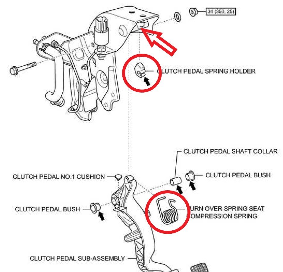

    Disc brake grease in hand, contort yourself under there and be liberal with the application while moving the pedal. Make sure to work it into the turnover spring and that pivot point that resides up high on the assembly:
    DustStorm4x4 and shakerhood like this.

    this, exactly. do it right and the noise and friction from the spring will be gone. put on a nitrile glove and get a wad of the stuff and work it in there real good with your fingers to be sure you don't miss anything.

    Finger blast it!

    My '18 was creaking like a haunted house door on hot days, kudos to the dealer for taking me seriously when it was almost silent on the day I took it in, tech found a TSB for 2017's with the same issue, Toyota approved replacing the parts below (listed just as they are on the service order), two weeks later still quiet and as a bonus it feels better too.
    31434-60010 HOSE, CLUTCH RESE
    31420-60032 CYLINDER ASSY, MA
    31311-04020 PEDAL, CLUTCH
    08887-02007 BODY GREASE W
    DustStorm4x4 likes this.

    T-SB-0186-12 covers 2005-2017 Tacomas.
    I printed it out and brought it to the dealer. The service manager drove my truck and I rode with him. It was creaking like crazy.
    They didn’t have the parts in stock, but they ordered them. Hopefully that fixes it permanently.
