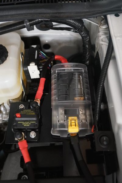

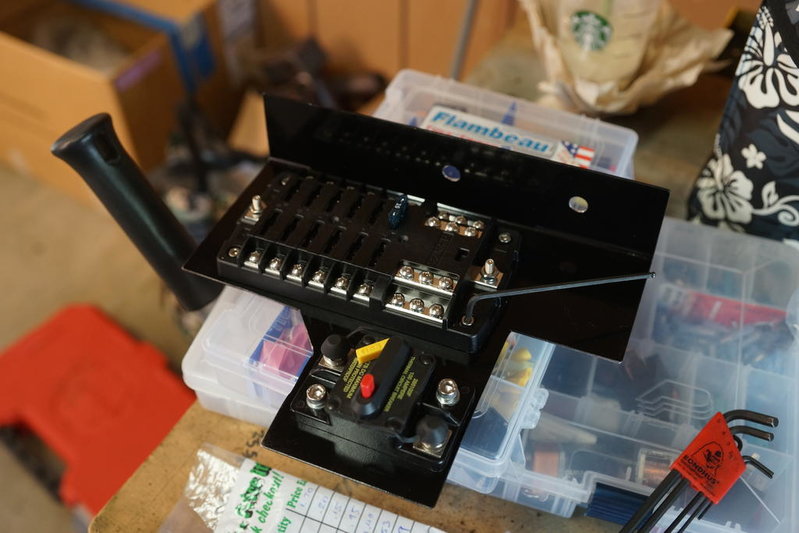

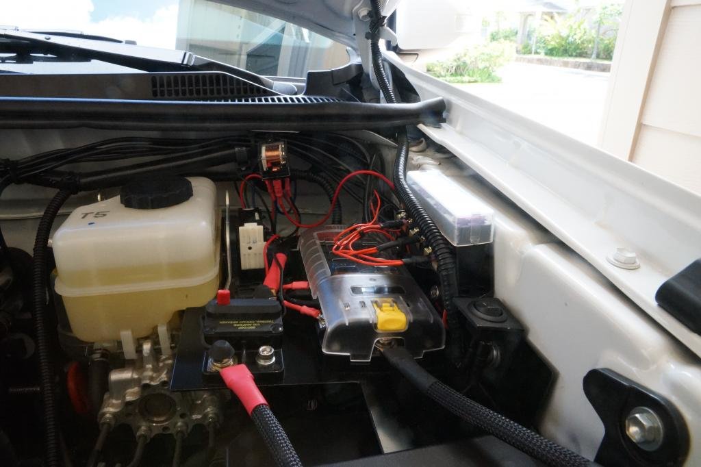

    Bro...I missed your question ..sorry.. You will def benefit with having a fuse box add-on if you plan on adding anything electrical/lighting... Tap off the battery and one to ground...:) Then just plug whateva you need!

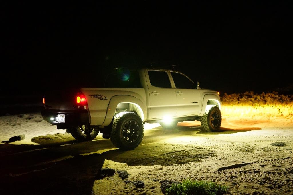

    A few pics:
    I need to remove that Zip Tie tab..lol
    The wiring setup...

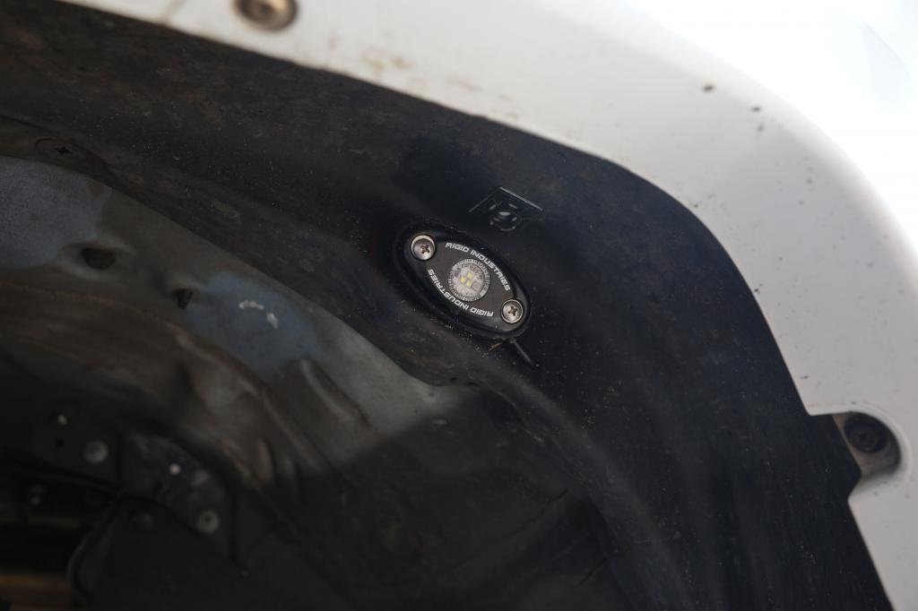

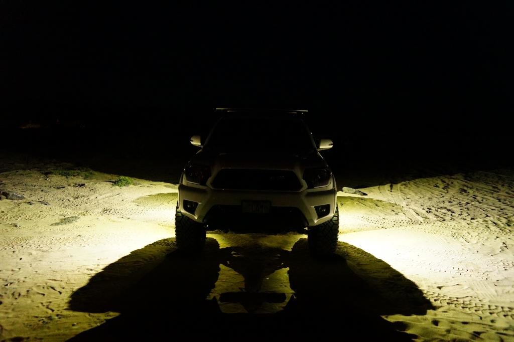

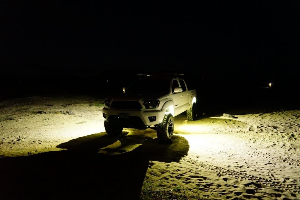

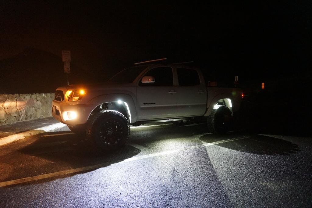

    Better shots of the Rock Lights...

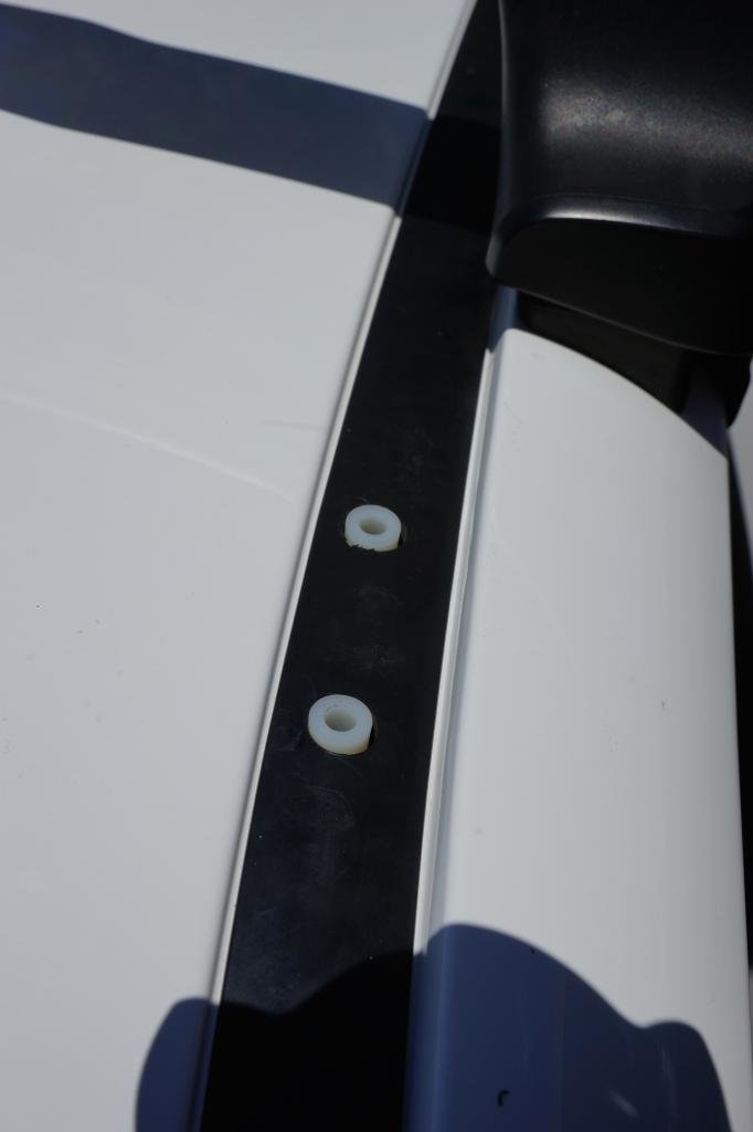

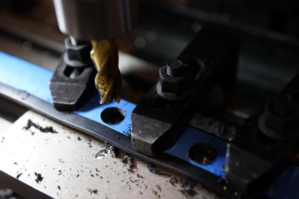

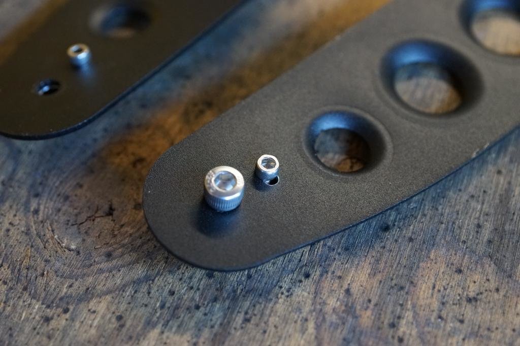

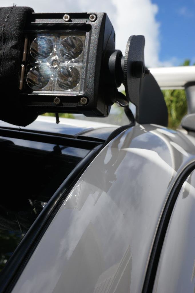

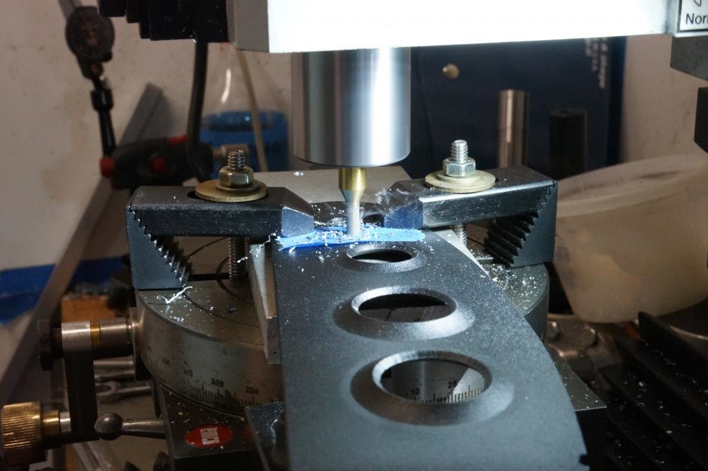

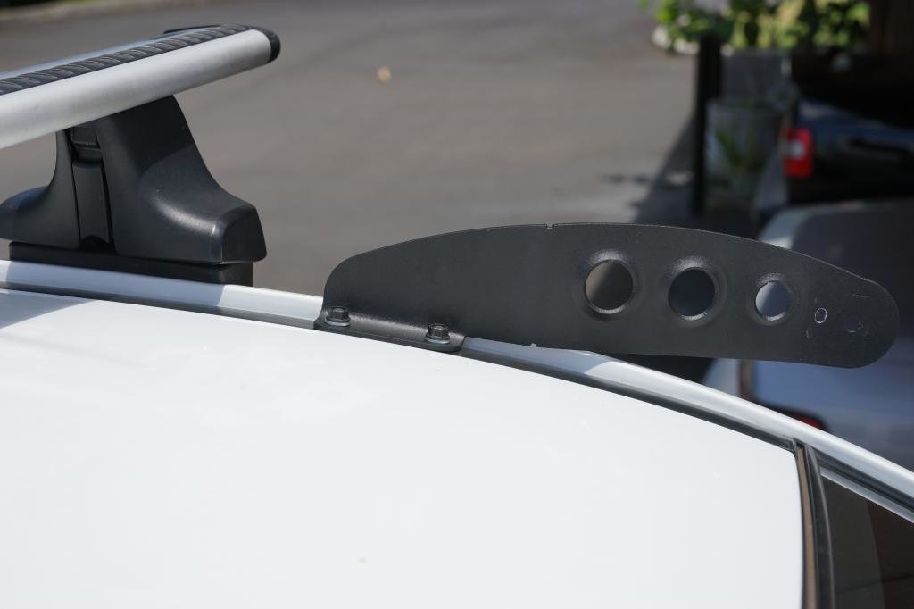

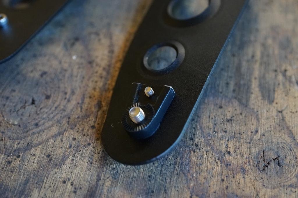

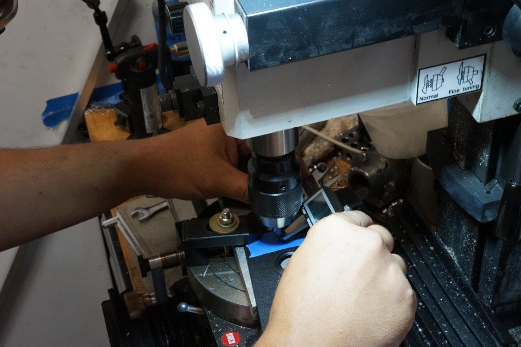

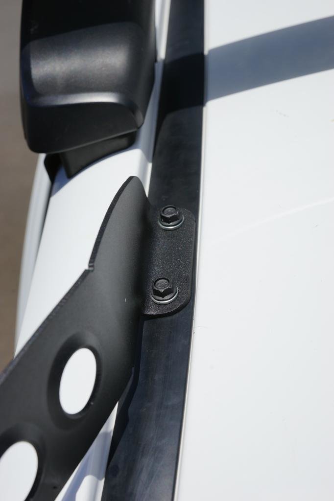

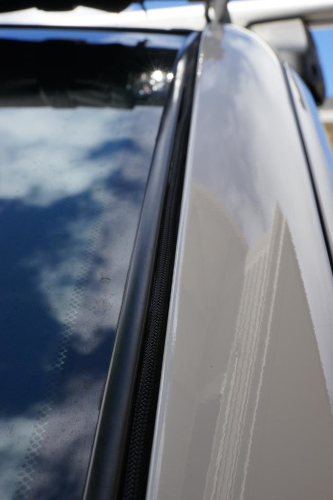

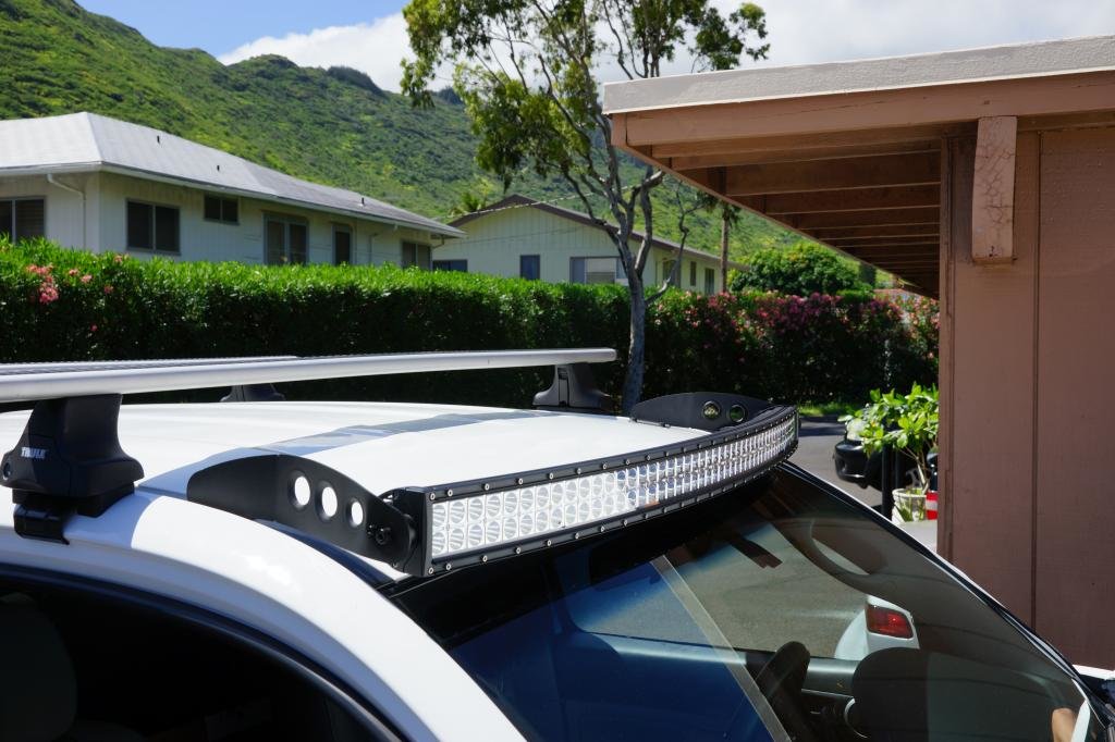

    Mounted a 50" Radius LED bar today. My TW brothers Bullaculla and Luka did a hell of a job fabbing and wiring. The light bar brackets were modded by Bullaculla by creating a 10 degree swivel point with a set screw adjustment utilizing and modding the existing hardware. Nylon bushings were inserted in the channels so that once the bar was mounted there would be no compression on the rubber roof rail as well. The light bar brackets then had to be bent near the mount points to accommodate a better fitment. It came out outstanding!
    Setting the tolerances
    Creating the 10 degree swivel set screw points
    Close-up of utilizing the existing hardware
    Creating the channel holes for the nylon bushings in the rubber roof strip
    Nylon bushings in place to support the light bar and to prevent compression of the rubber seal
    Test Mount
    Side View of bracket installed on railing (No compression of the rubber seal!)

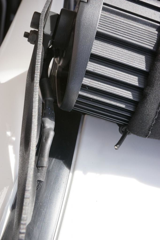

    Wired the lights together (connection) right off the bar to a longer cable going down the window channel and into the engine compartment to the fuse box... Recommend you sheath the wires well
    and I also used a mesh wire cover over the rubber wires so it looks professional...:D
    Wiring was placed in the channel along the window and fit like a glove. Placed a few beads of black silicone along the channel to hold the wire in place...
    Finished product! I highly recommend a cover like I used by taking some surfboard/kayak pads and removing the foam and then velcro'ing the canvas around the light bar when not in use.
    Main reason: The bar will howl/resonate when subjected to high winds making a high pitch sound. The canvas cover eliminates that...:)
