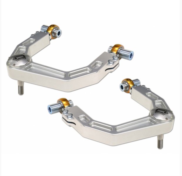

    Nice. Bling! Bling! Trying to get more adjustability?

    Just a little ;)

    Initially when I bought my suspension I wanted the billets but the price point at the time with everything else was.... How do you say in English? Expensive! :p Now I can finally get them...

    It's cause you gotta have heims to be legit :D lol

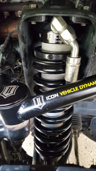

    With the 700# springs, how much thread do you have showing? What's your axle angle looking like? I'm still running the 650's, but I'm ready for the bumper.

    No difference in Axle angle. Lift still just around 3" or a little less (same as before w/650's). Only diff is less thread showing on coil overs. Right around 1-1 1/4"s thread as opposed to the 2 1/2-2 3/4"s I had before...

    How hard is it to adjust the coil collar with the reservoir hose fittings there. I was thinking of upgrading to remote reservoirs.

    No problem at all... The ICON spanner wrench fits in those holes, so you can only really turn it a 1/4 turn at a time though with the resi hose there. When I swapped to the 700's we adjusted the collar on the compressor to where I thought it might need to be. Placed it on the truck and it was only 1/4" low in the front. I didn't want to remove the coilovers again as it's a lot of work, so I just sprayed the threads and used the ICON spanner wrench and cranked them a couple turns. Easy peasey...:)
