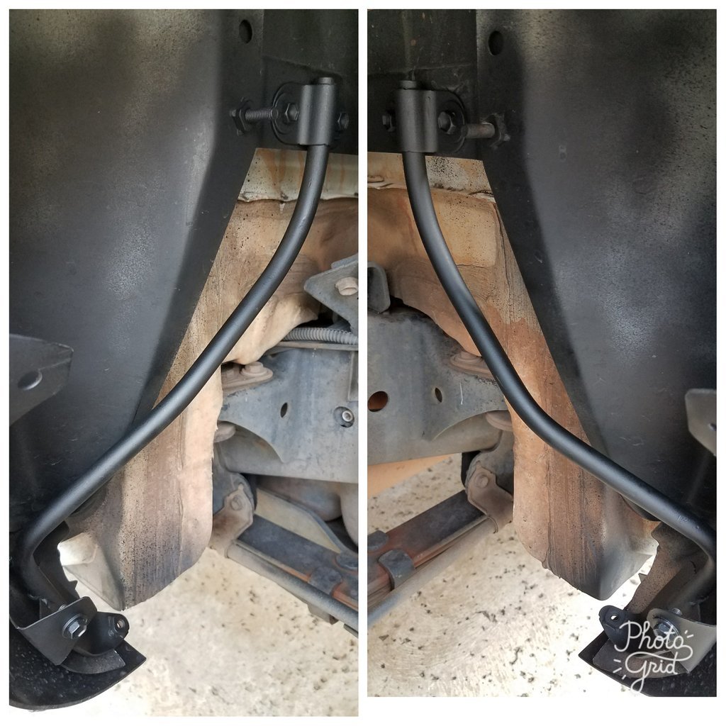

  15. Aug 15, 2017 at 9:11 PM
    #1095
    squint0241
    squint0241 [OP] OVRLND
    Jan 4, 2014
    #119916
    6,868
    Rick
    Tropics
    '14 DCSB/Off-Road 4X4
    Bone Stock
    Had to bend the "F" out of these fender supports, but got'er done. A good sanding and splash of paint as well. If I didn't tab my fenders this would have been a PITA...

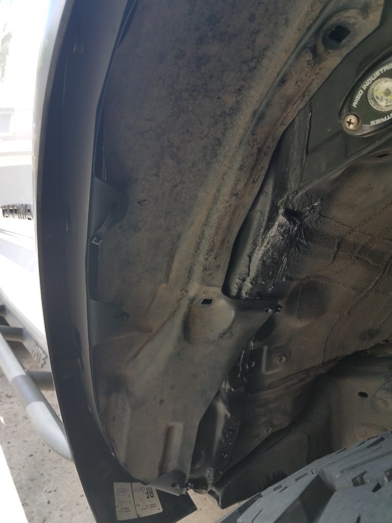

  17. Aug 19, 2017 at 7:26 PM
    #1097
    squint0241
    Jan 4, 2014
    #119916
    6,868
    Rick
    Tropics
    Bone Stock
    Used the OEM fender liner in the front passenger side. Took a heat gun to flatten it out and then trimmed it. Actually worked well! Rather time consuming though, but I needed to get a liner to protect the air intake in the fender. One down...3 to go...:(
    lemon177, DEDAFLO670 and Stormtaco_ like this.
  18. Aug 19, 2017 at 8:18 PM
    #1098
    seoulja99
    seoulja99 Well-Known Member
    Mar 8, 2016
    #180618
    2,559
    E.J.
    Oahu
    2012 DCSB 4x4 V6 TX Baja (1GR-FE)
    all things mall rated
    Snorkel will solve that problem! :D

  20. Aug 20, 2017 at 2:16 AM
    #1100
    lemon177
    lemon177 Well-Known Member
    Feb 17, 2012
    #73005
    887
    Matthew
    Oahu
    09 tacoma 4x4 sport pyrite mica
    TRD supercharger, URD 2.85" stealth pulley, TRD exhaust, TRD intake, DTLT headers, URD y-pipe, TRD boost gauge, PLX DM100 touch with OBDII and SM-AFR modules, 885 OME 3", Icon UCAs, Satoshi grill, Solid rear window, SCS stealth 6, 285/75/17 toyo AT2.
    What I did was cut the liner horizontally so that I could tuck it behind the flattened pinch weld ;)
