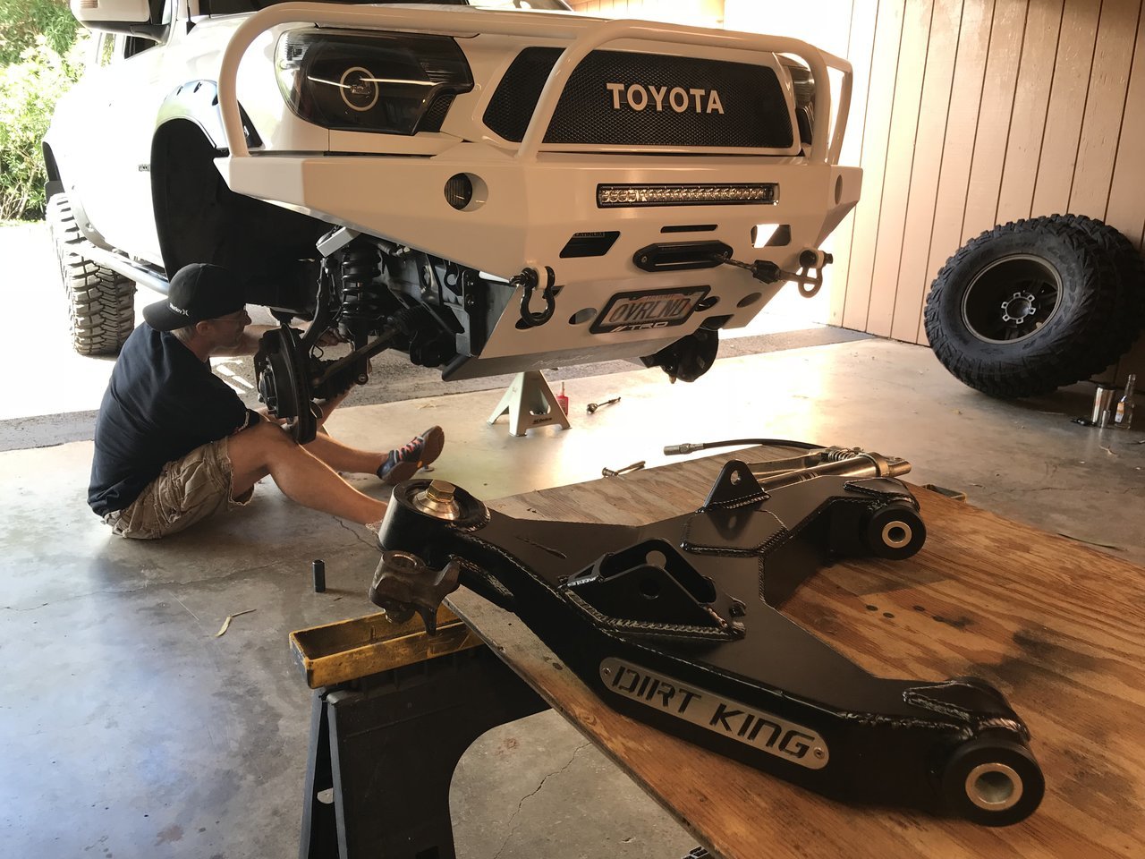

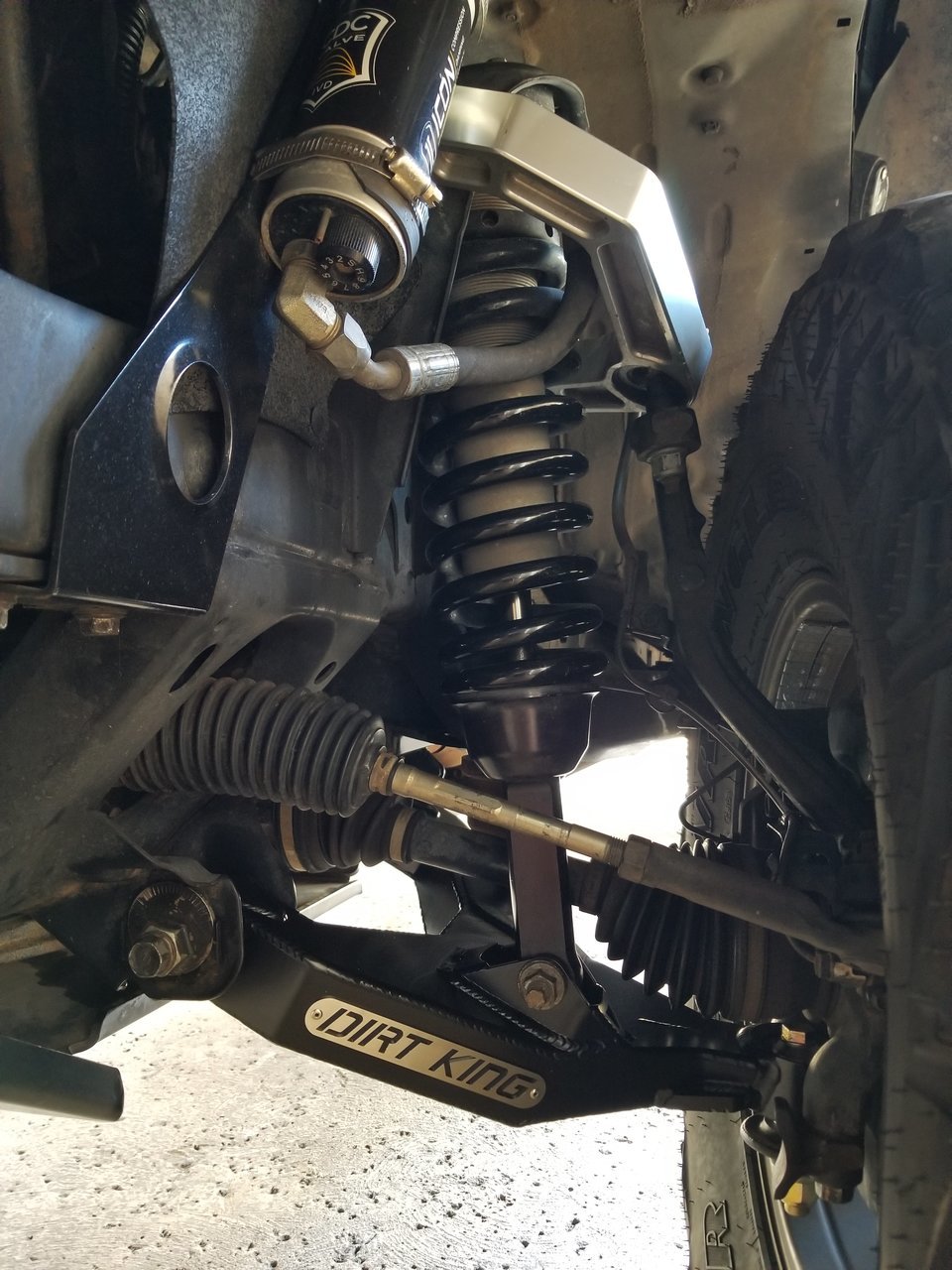

    Big thanks to bullaculla for the assist. His expertise at removing steer stops was instrumental in getting these pieced together:thumbsup:. I really like that these are stainless and greasable and the build quality is spot on. Now for another alignment:rofl:

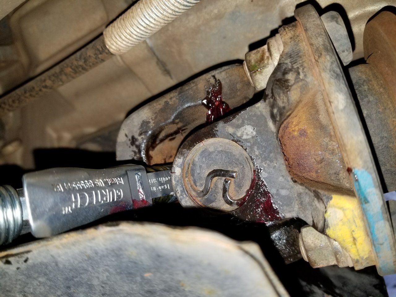

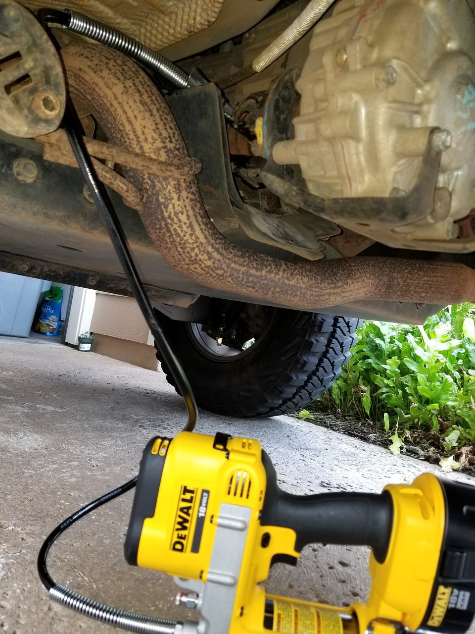

    Broke in my DeWalt 18V grease gun today. I needed this a long time ago..:frusty:
    I added a "Lock-N-Lube" connector to replace the original shitty twist connector which is a PITA when it's greasy and ur trying to connect/disconnect the damn thing from the zerk fitting. The whole lube process is fast and effortless now except for squeezing the trigger..:D The only issue I had was the Lock-N-Lube tip would not attach to the forward most zerk on the front shaft (space is too tight..:(). I had to change to the twist connector since the barrel diameter is smaller and fits into the small space. Oh well...can't win them all..:laugh: For those that have been remiss in lubing all the joints...I highly recommend you check them out! The initial pump brought out a thin dark black, watery goo of old broken down grease from the joints..:eek: Nothing but clean Red Moly in there now..:cool:
    Tight fit with the Lock-N-Lube tip...but she fit...:cool:
    Gobs of Red Moly goodness oozing out!

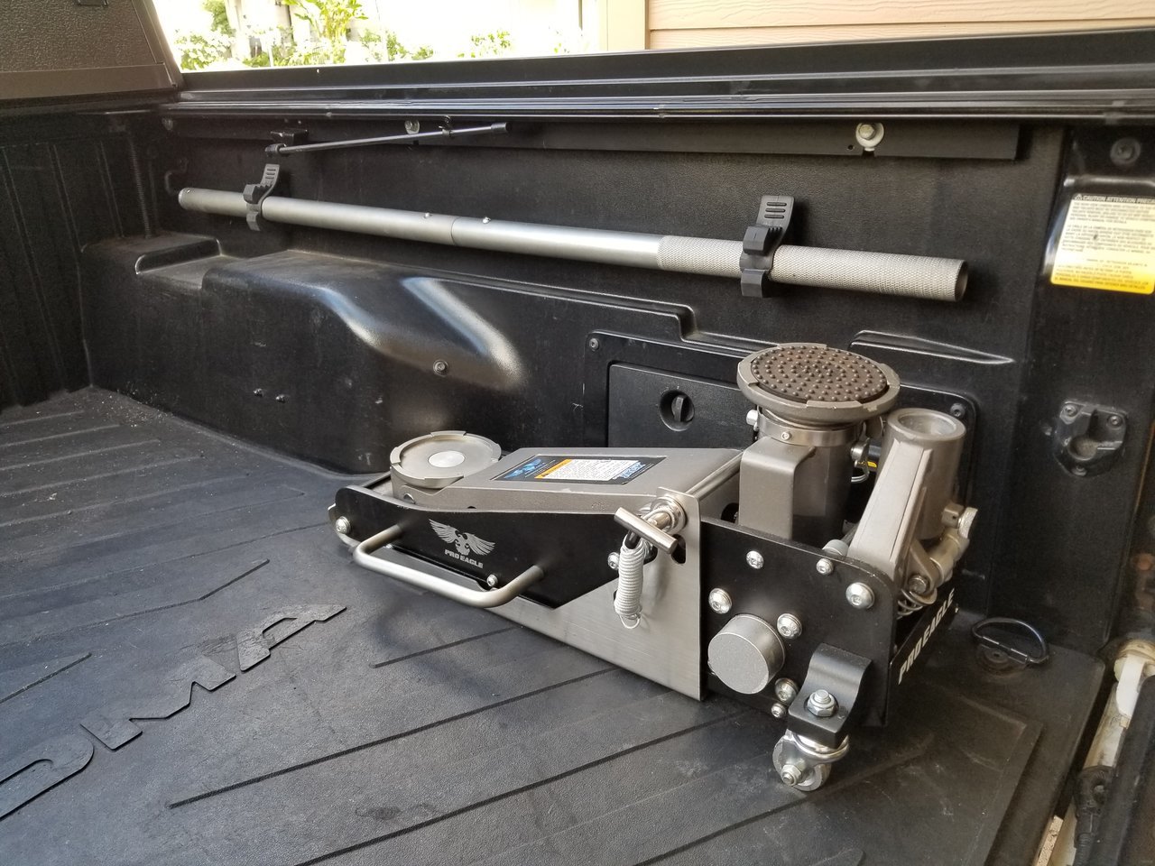

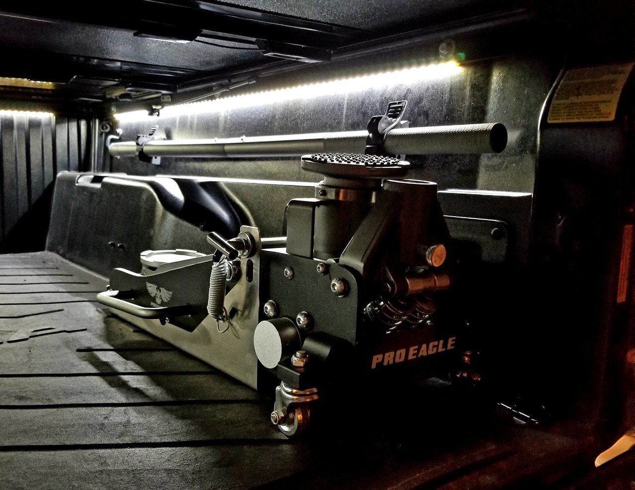

    Pro eagle mounted.

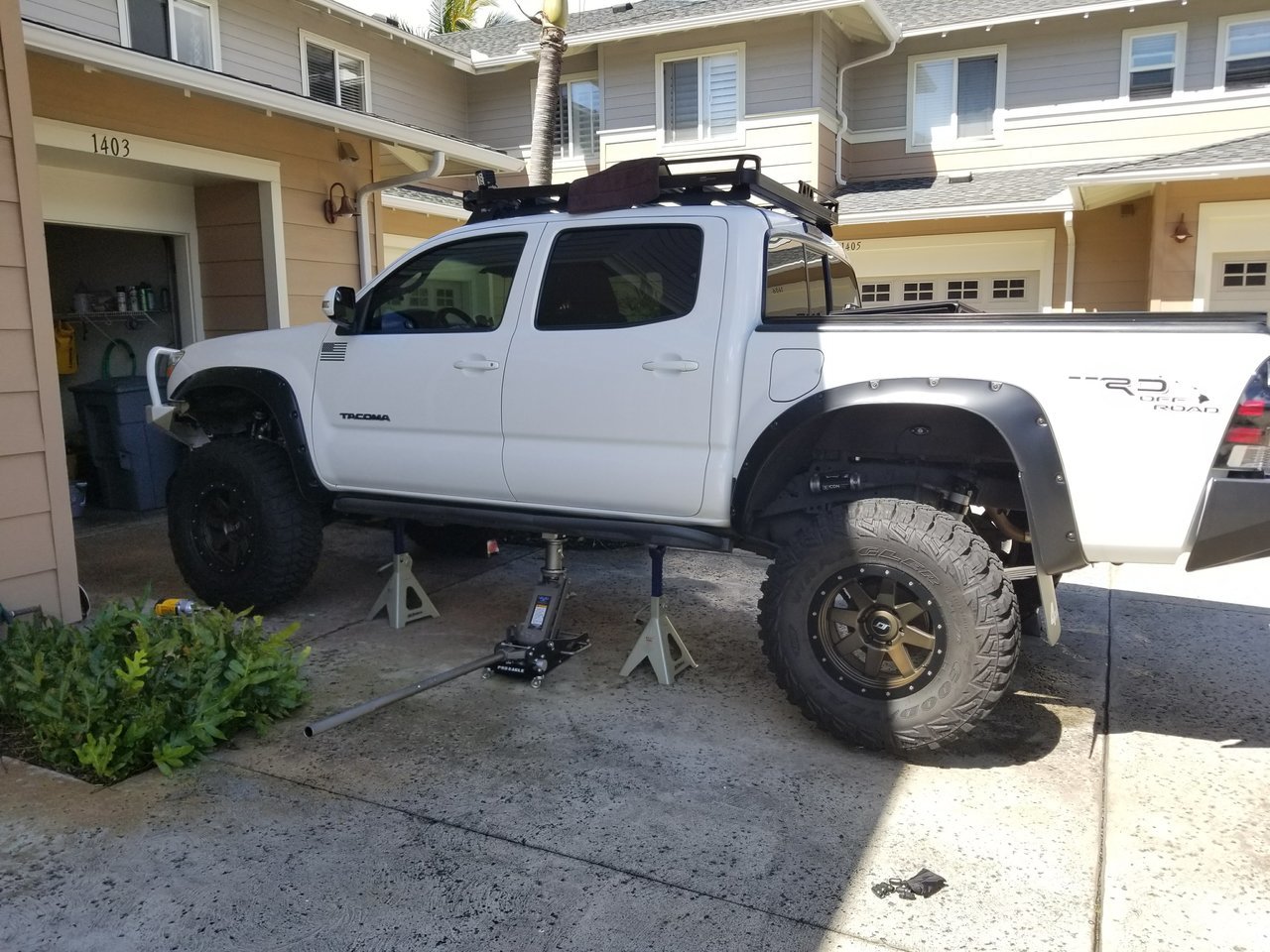

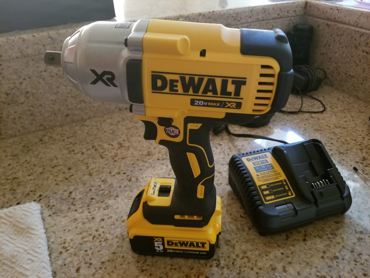

    Swapped the McMasters edge trim for something a little more appealing and beefier from Trail Toys. Tire rotation went well with the new impact gun...
    Before:
    After...
    New Impact gun..:cool:
    Tire Rotation...:rolleyes:
