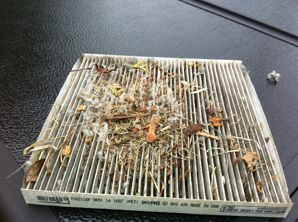

    Damn it .... I just went to change the cabin air filter and found a huge squirrel nest on top of the air filter. It was freekin' huge and took me an hour to vacuum it out.

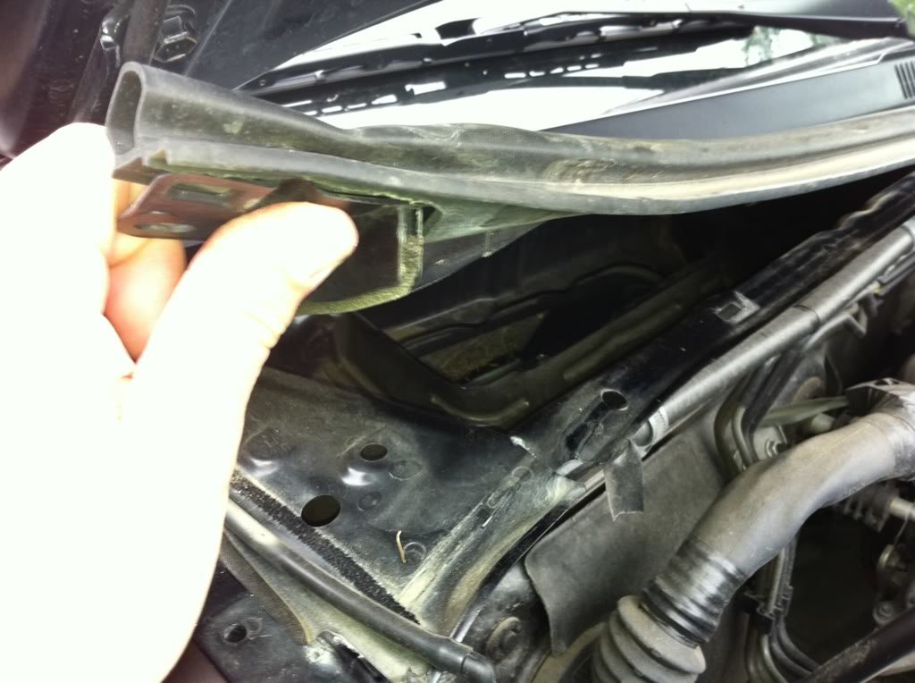

    I pulled up the shroud that stop leaves from dropping into the HVAC.

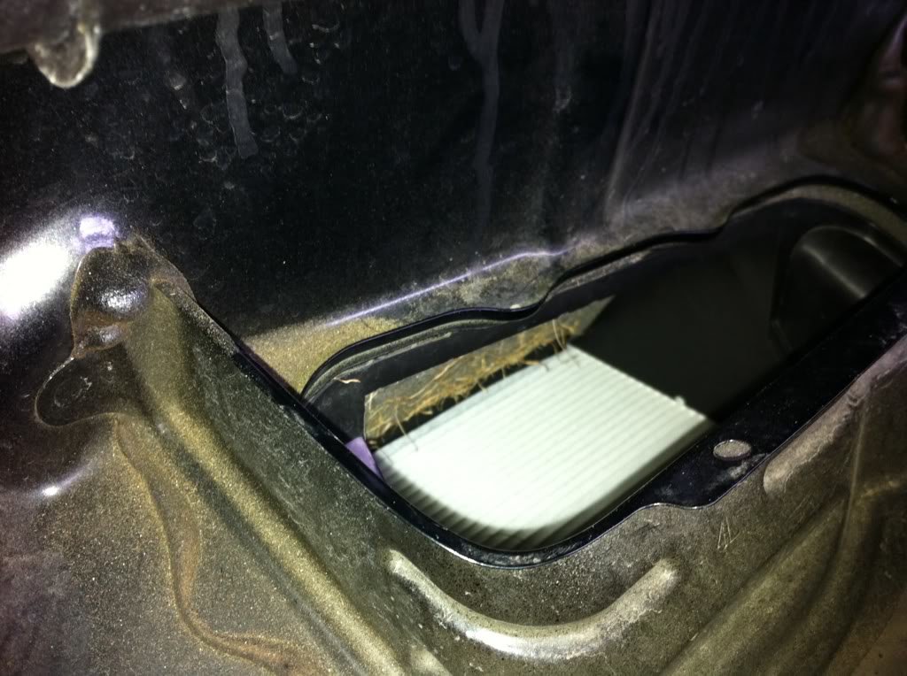

    You can see the new, clean filter down the hole.

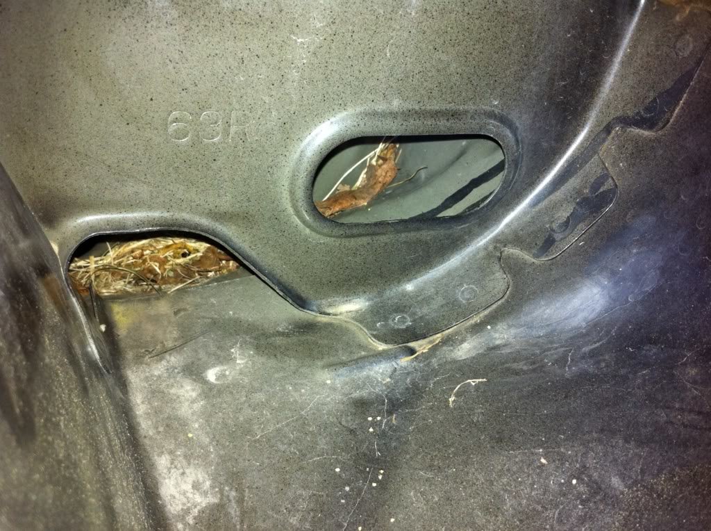

    The squirrels are getting in there by going up into the wheel well and through these little holes. The holes are down in the area next to the opening for the filter. There are located on the fender side.
    Gonna go buy a bunch of steel wool and stuff it in there and see what happens.
