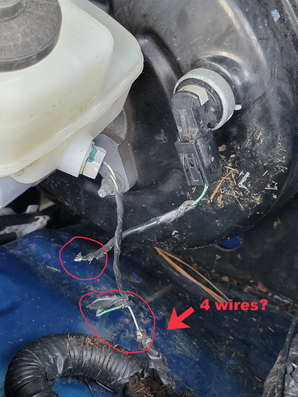

    Hey guys,
    Looks like the squirrels got into my 2017 Toyota Tacoma. Looking for any help on what these switches, sensors do and the wiring diagram, part numbers, etc...
    I'm a work from home person and don't use my truck that often. Popping the hood today I noticed a huge nest on the drivers side area. Cleaning it out I found the wires chewed to what looks like the brake booster and master cylinder reservoir. Looks like 4 wires to me (one completely separated) and another with one still connected. I did start the truck and no warning/idiot (that's me for sure) lights.
    I'm pretty decent at soldering can splice some wires, waterproof but at first glance it looks like 2 wires but then there is a small set of wires not connected which makes me think there are 4 -wires coming from that master loom? It's small gauge wiring, like 22awg.
    Any thoughts or help would be much appreciated.
    Thanks in advance.

    Looks like brake. Id get wire diagram then peel back wires see what color matches

    Thats what I think. Both sets of 2 wires goes to the brake boost and one to the master cylinder resevoir. Ill be repairing tomorrow, will take a few picks and just do a color to color fix.

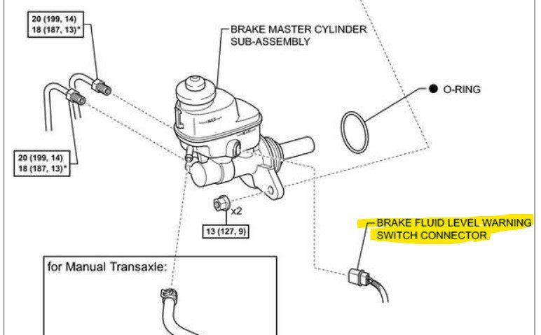

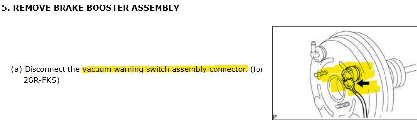

    Update: From the Service manual. At least I have the function, now on to wiring diagrams? Maybe
    1. Vacuum Warning Switch
    2. Brake Fluid Level Warning Switch
  17. Dec 5, 2022 at 4:51 PM

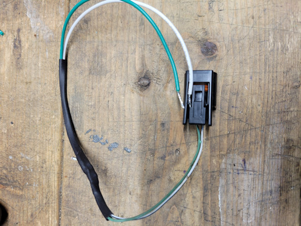

    Updated: for reference for anyone else....
    I repaired the "whatever ate my wires" today. The method I used was the solder technique instead of butt connectors. Heat shrink, water proofed, wrapped in electrical tape and then a wire loom.
    Both the brake switch and brake sensor wiring was green (common) and a white w/black stripe. My one sensor was still connected by one wire so I new which pair went to which. Otherwise I would have had to trace it to the connector and pins.
    ...now on to hunting them rascally wabb...squirrels!!!
    Wiring:
    Repair Completed:
