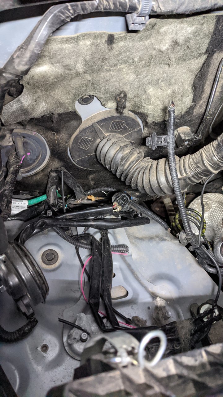

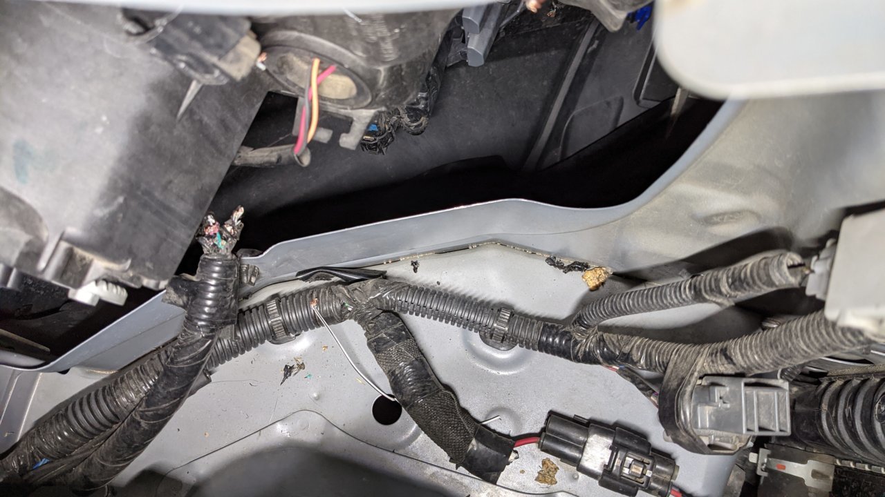

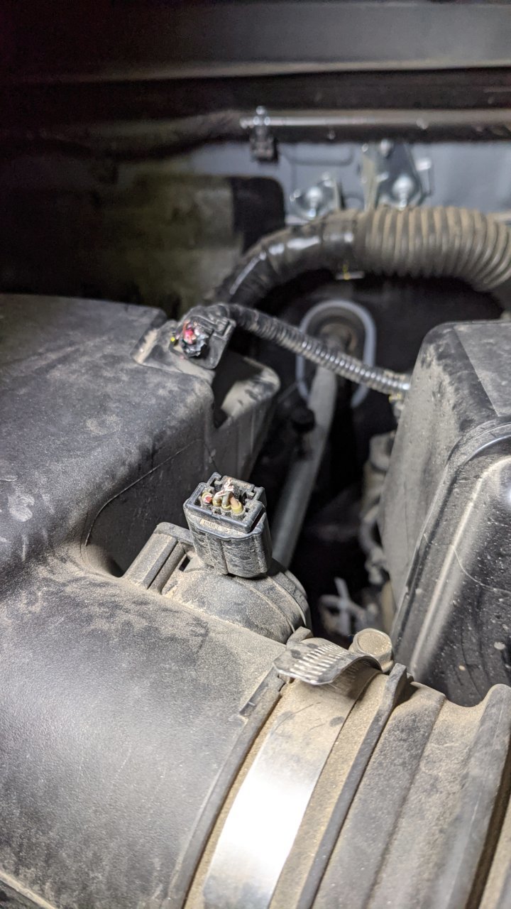

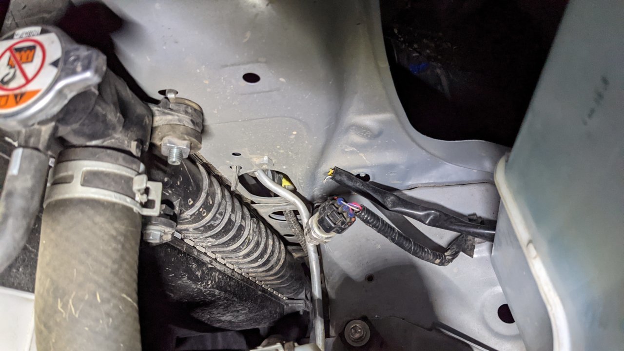

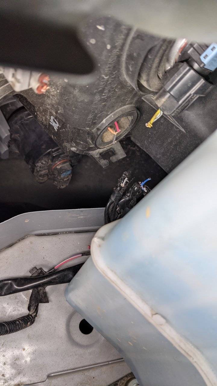

    Pretty much what the title says. Last time I drove my truck was Thursday morning, and then yesterday morning I took my Jeep. The lady and I were going to take the Taco last night to meet some friends for dinner and when I started it the dash was a Christmas tree so we took the jeep. On they way home I stopped at autozone to get a scanner because it would drive me crazy. So I plugged in this new bluetooth scanner and couldn't get the stupid thing to connect so I I popped the hood and found basically all the wires to the headlights trashed as well ass the TSS wiring, my front camera wire, and I think the MAF wiring. Near the firewall on the passenger side there was a pile of wires that for whatever reason they piled up there, and somehow they even managed to pull a bulb out of the driver's side headlight and drag it with a bit of wire still attached over to the passenger side. If this has happened to you before, was the truck ever right again after getting it fixed? And does anyone have recommendations for future prevention? Honda makes some electrical tape that's like lined with capsaicin as part of their TSB for this situation that I'm considering investing in, although it's apparently about $40 a roll.

    Dirk Diggler

    Seems odd to me..... The wires are neatly severed so close to the connectors.
    You could probably fix yourself.
    Gonna need more than butt connectors.

    Thanks for the advice y'all. I started a claim under comp and it won't bust my rates. On a truck this new and nice I don't want an engine bay full of butt connectors. I'm kind of leaning towards taking it to the dealer and much as it pains me to say that but it seems like this repair would be best suited to them.

    Dealer. Depending on how much is damaged, you will likely get a new harness. Toyota has required specs on wire repairs, so they wont just be wire nutting them all together.
    #1 way to keep them out of the engine bay is leave your hood up. Use fluid film all over your fuel tank wiring and vent lines as they hate the greasy feeling and wont touch it. I have seen rats/mice make nests inside cars ontop of irish spring soap bars and fabric softner sheets.
