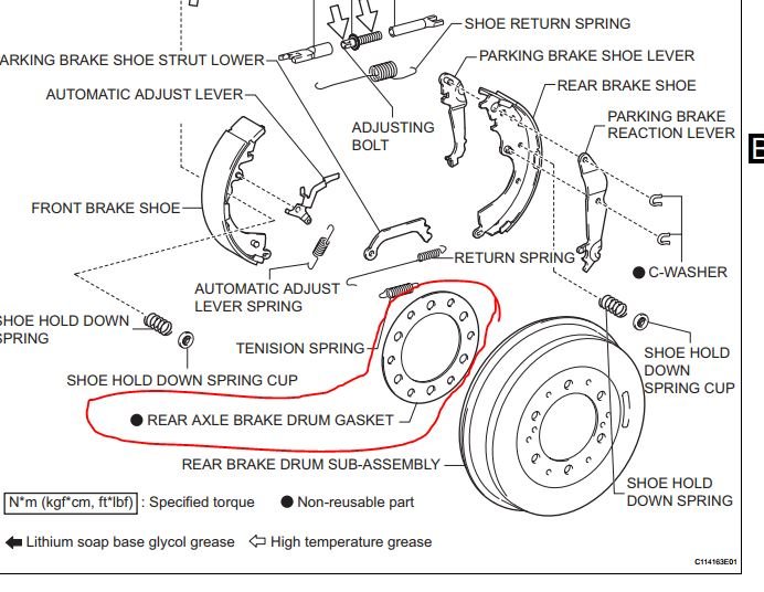

    What I posted earlier was also a link to the shop manual for reassembling the brakes:
    From the Shop Manual: http://www.customtacos.com/tech.old.../06toyrm/06toypdf/06rmsrc/rm2006ta/042010.pdf
    Following the link you would have seen this:
    1. INSTALL REAR BRAKE DRUM SUB-ASSEMBLY
    (a) Install a new drum gasket onto the rear brake drum.
    (b) Install the rear brake drum.
    2. ADJUST REAR DRUM BRAKE SHOE CLEARANCE
    (a) Provisionally install the hub nuts.
    (b) Remove the hole plug, and turn the adjuster to
    expand the shoe until the drum locks.
    (c) Using a screwdriver, release the adjuster 15notches.
    (d) Install the hole plug.
    Of course you can do it with the wheel in place. That just makes it harder to adjust.
    As far as which way to adjust it is the standard right hand screw threads.
    Looking at the picture in the link I posted it says which way to adjust the wheel to expand or tighten the brakes.

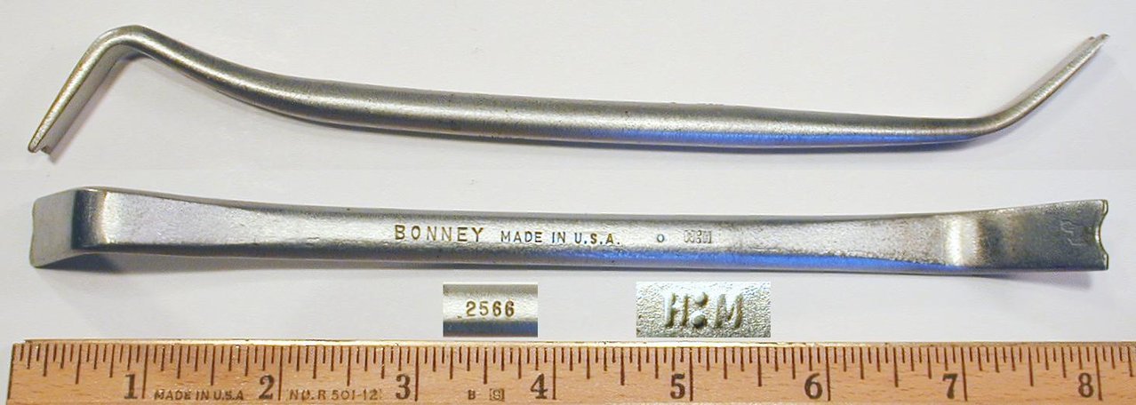

    It is also easier with a proper tool such as this brake spoon:

    Cut & broke off some stuff.
    What is this? I don't remember seeing any sort of gasket in there at that position.
