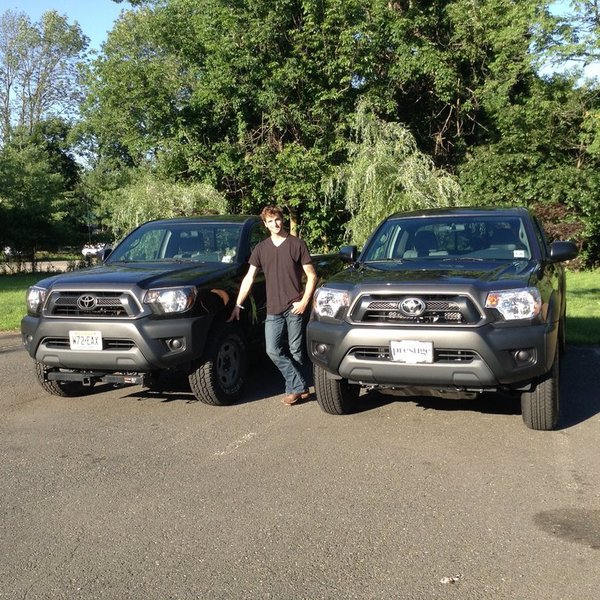

    I had the 30" for over ten thousand miles and went to the 31/10.5" on stock wheels which have another ten thousand on them. You won't feel any squishyness, it will probably ride stiffer in fact!

    That's it in black next to my sons 4x4 AC in grey. They were identical in height, the one on the right is just on higher ground. Customized front spacer (shorter), and AAL. I'm toying with trying a 32-11.5 on it too. If they had a 32-10.5 I'd be running it. I think the 33-10.5 is going to eat up too much of my wheel wells.

    Your truck looks great man! How are the wear patterns on the tires? Do you have to rotate them more often than stock tires?

    Ok, you misunderstood me. My 30/9.5-15 were fine, looked new at 10,000 miles. I did 4.88 rear gear and was a little too short for where I wanted to be so I replaced them. The 30" tires are not actually 30" in reality, more like 28!
    I have 10,000 on the 31-10.5-15 and the right front got a ramping wear pattern on it. That's with no rotation as I prefer to see issues with one corner as they appear. With ritation at 5,000 I might have missed the bad strut!
    My truck has 30,000 miles and it needs struts and shocks. That's the tire wear issue, I rotated it and reversed it to the left rear and it'll probably go another 30-50,000 miles anyway. No appreciable wear, just that funky ramping from the strut.
