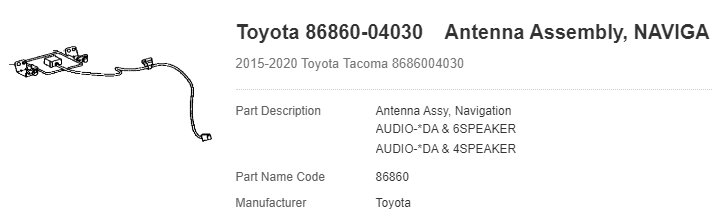

    Did your factory unit have navigation? If not, I’d guess you don’t.

    If you truck didn’t come with navigation, I doubt you have the GPS antenna,,, therefore nothing to plug in to. I could be wrong though.

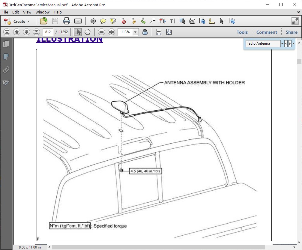

    Don't all late model Tacoma's have the dorsal fin on the rear middle of the roof? Or is that there for something else and the optional GPS antenna mounted elsewhere? My SR does not have navigation but has the roof fin.

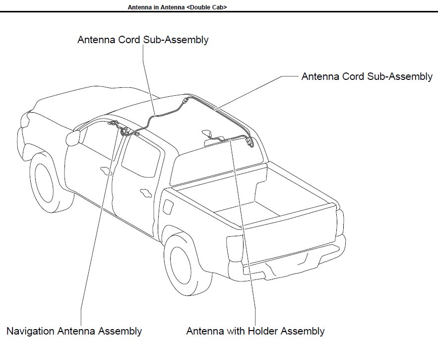

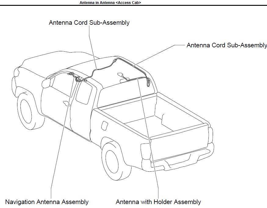

    So it looks like the dorsal fin is the radio antenna and the GPS antenna is under the roof near the overhead console.

    What? Depends on model. OP got it straight now. You're late to party:burp:
