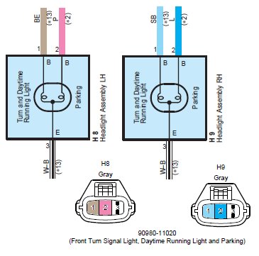

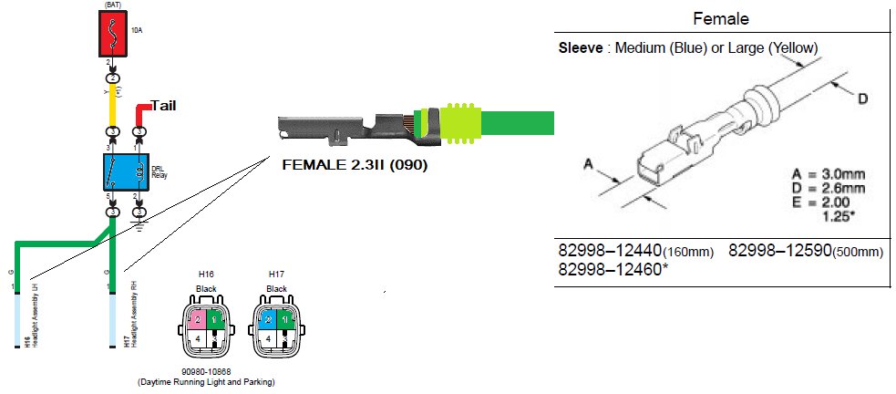

    You'll need to get connectors H14 & H15 (90980-11486) and remove the wires from H8 & H9 (#1's) for the Turn Signals.
    Wires from H8 & H9 (#2's) to H16 & H17 for the TAILS.
    Male connector to H16 & H17 is available here:
    https://www.bmotorsports.com/shop/product_info.php/products_id/4045

    Since the SR has no DTRL stalk, activate the DTRL with separate switch or with TAIL tap...you'll need a "repair" wire with seal

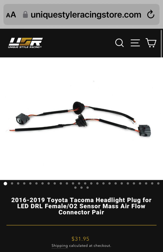

    Hello gentlemen
    Is there a harness to tap into the DRL Headlight on a SR5 model to connect to H16
