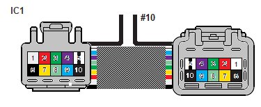

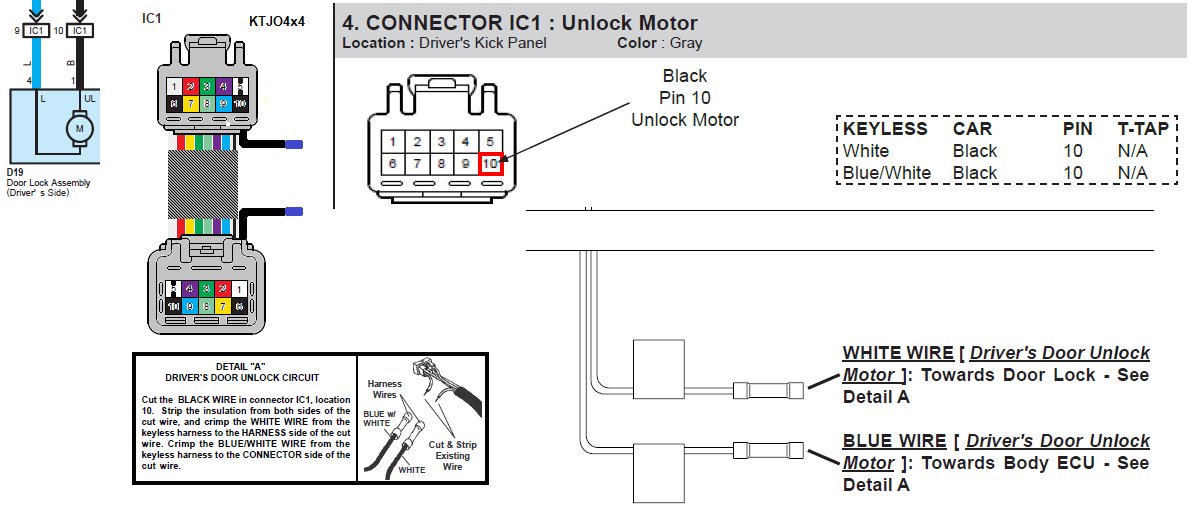

    Here is the PDF...:burp:

    If you contact @KTJO 4x4 , she could sell you a harness for the driver's side IC1 so you don't cut the wires on that part of the install.
