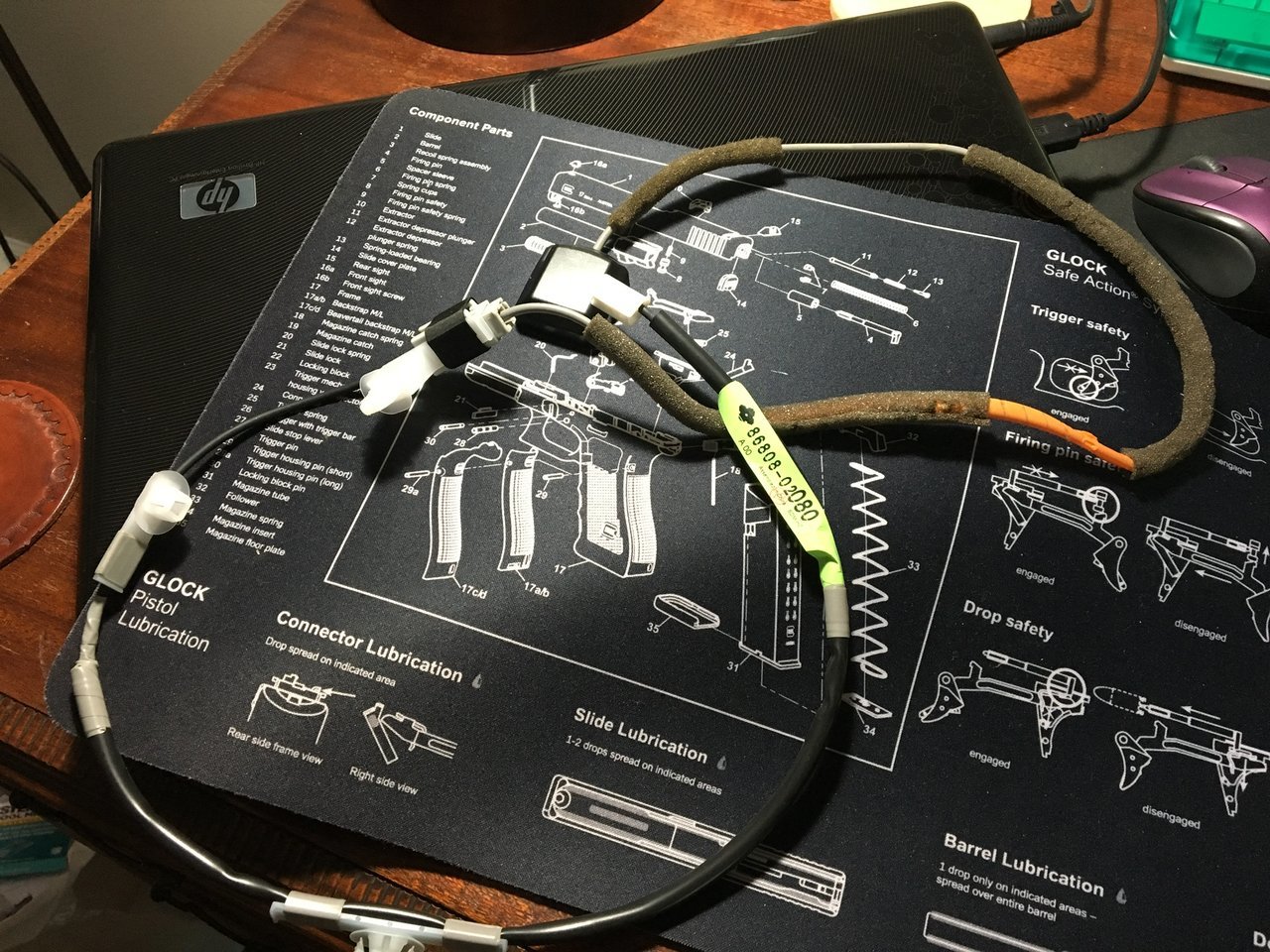

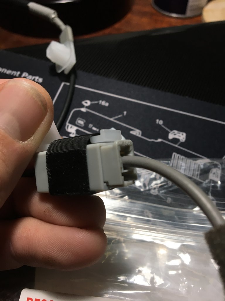

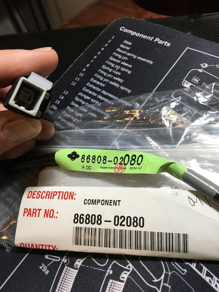

    This is one of the harnesses I used to plug into the back for the XM antenna. Had to modify it a little, notch was on the opposite side.
    parts.mcgeorgetoyota.com/oem-parts/toyota-cord-sub-assy-navig-8680802080
    This one also. It plugged into the above harness and then into the magnetic XM antenna. Had to be modified a little also.
    https://www.amazon.com/gp/aw/d/B01AQXR1C0/ref=ya_aw_od_pi?ie=UTF8&psc=1

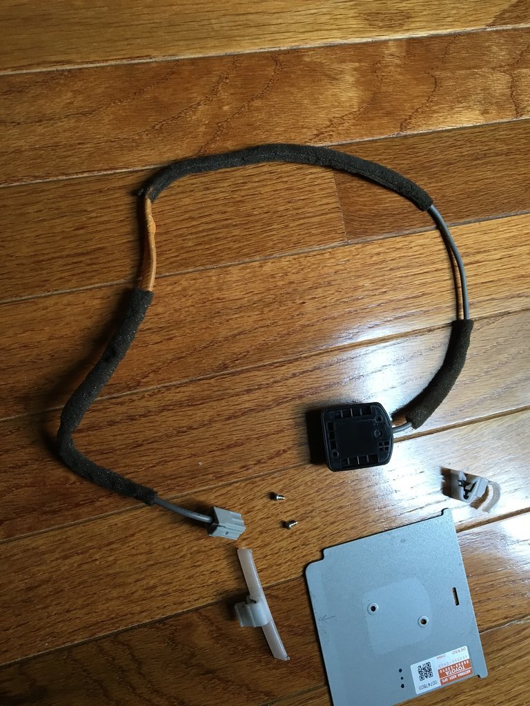

    This could help anyone looking for the cheapest alternative for both GPS and XM antennas.
    Either 2nd or 3rd gen.
    This is the second time I've done the XM antenna using this guy, I just carefully snip/slice the pink end off the mini coax and the coax slips right into the radio coax.
    If there is a harness out there to mate this end to the factory black end on the XM unit I am all ears.
    Mine has never come lose on me so it works for me.
    On my 2015 I let it sit in the flat part of the hood next to the radio antenna and there is a firewall pass through just under the hood right there. Just run the XM cable into your cab and it'll be to the right of your glove box. Just be careful and don't kink the cable when your pulling it all through as you'll have some extra.
    https://www.amazon.com/gp/product/B003O86GYE/ref=oh_aui_detailpage_o00_s00?ie=UTF8&psc=1

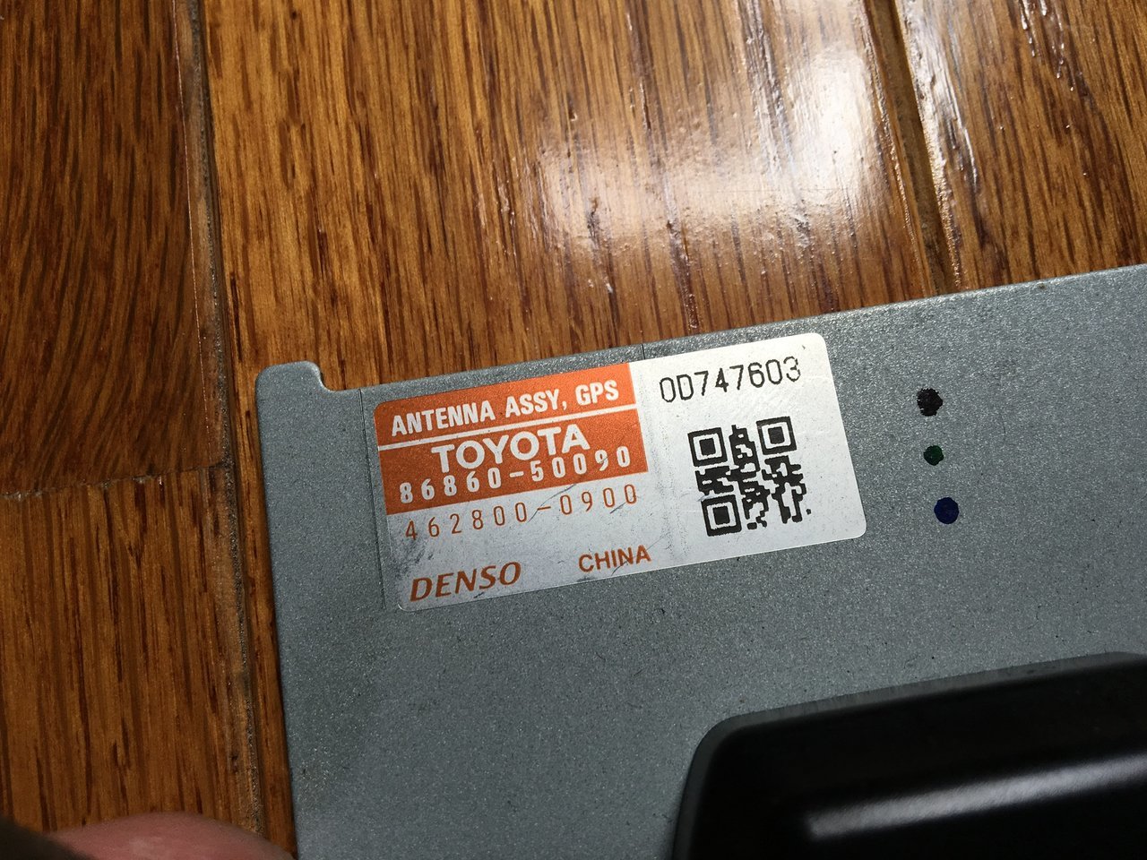

    This is the adapter cable from Toyota that I was able to get online for under 40.00 shipped. It's mentioned above and it a fantastic deal as now your just looking for a GPS antenna with the square shaped grey plug.
    I also took a gamble on the plug end matching up with a different Toyota GPS or actually a Lexus GPS unit from an LS460, scored off eBay for 40.00 shipped via best offer.
    I took a pic of the part number, I figured if it's good enough for an 80K+ sedan it's sure good enough for my Tacoma!
    They clip together perfectly!
    Wow, you can't beat GPS success for under 85.00!
