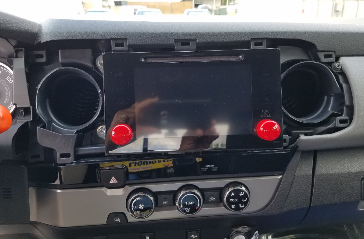

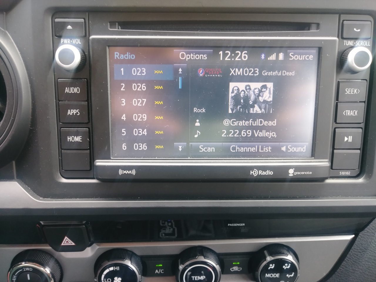

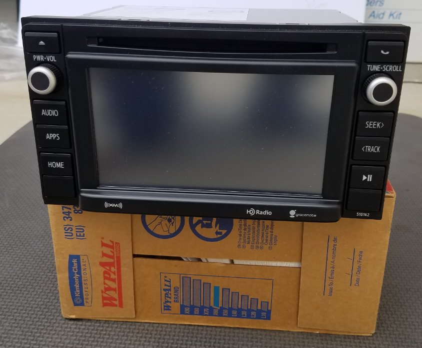

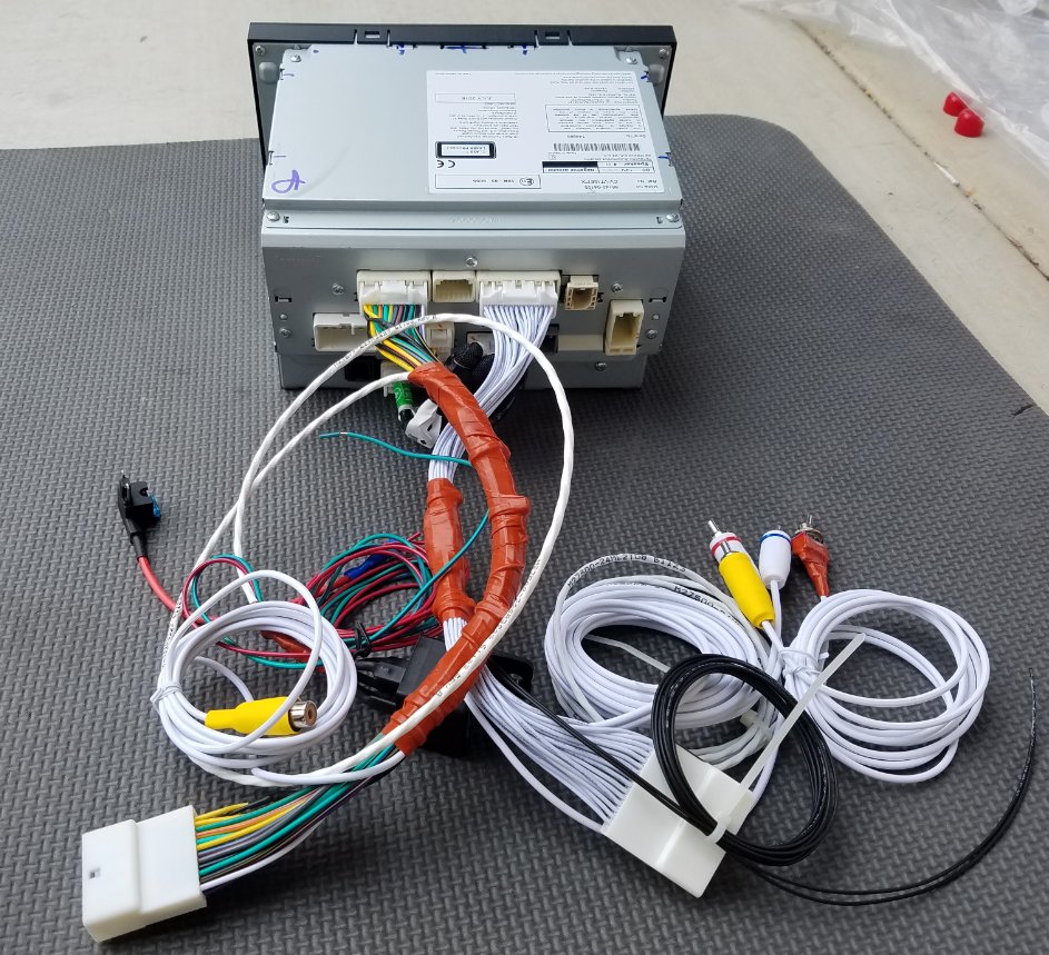

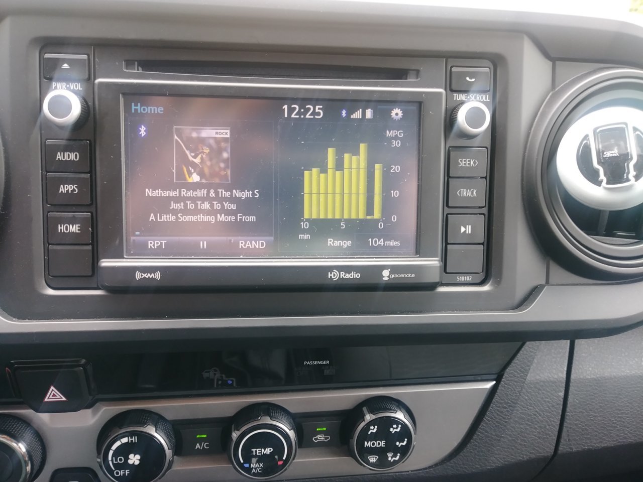

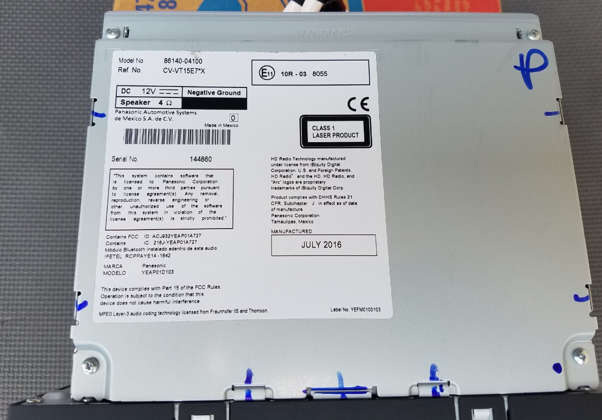

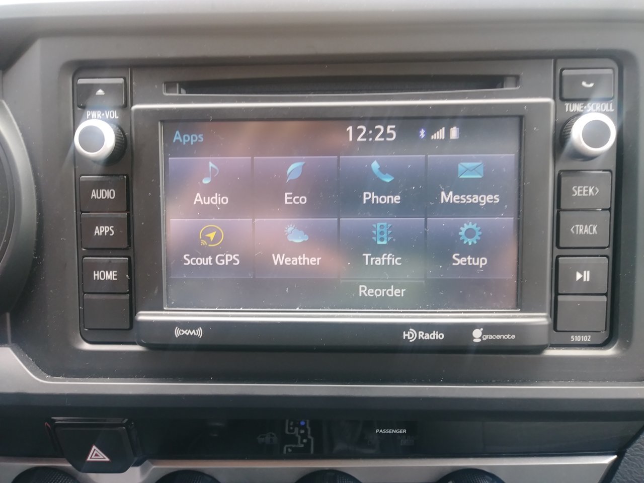

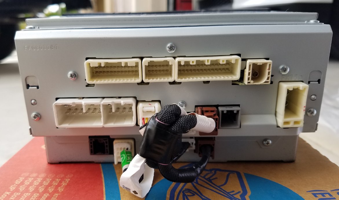

    Well I finished my swap, it super easy. Plug and play20180529_122652.jpg 20180529_122617.jpg 20180529_122617.jpg 20180529_122637.jpg 20180529_122606.jpg
