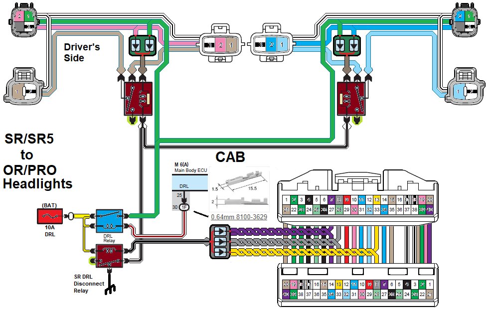

    Added relays cut the SR DRL illumination to the TURN bulb.
    Selecting TURN/Hazards reverts TURN circuit via added relay.
    Diodes at cab side C11 & A35 (Headlight Stalk n Hazard switch connector) prevent circuit ties.

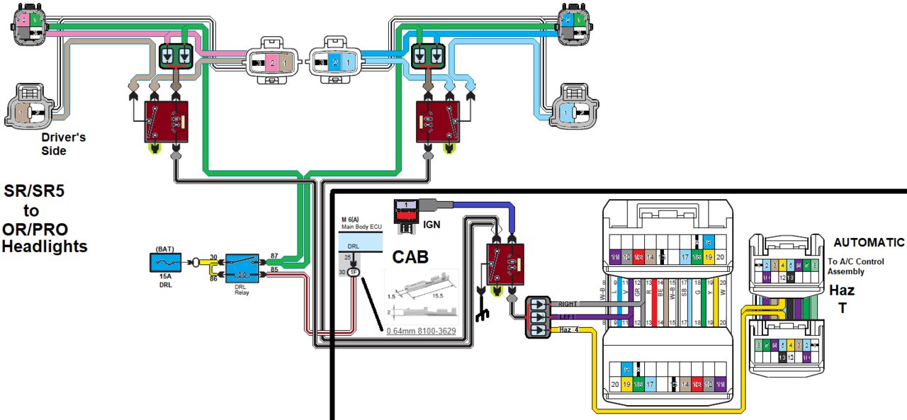

    GEP 12 slot with 5 pin 280 type relay and diodes.

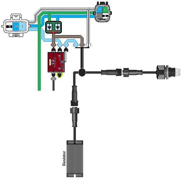

    Variable for VLEDs as DRL/TURN also:
