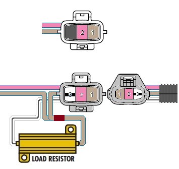

    Edited to add resistors (keep in mind resistor(s) values to "normalize" flash is different depending on vehicle add-ons)

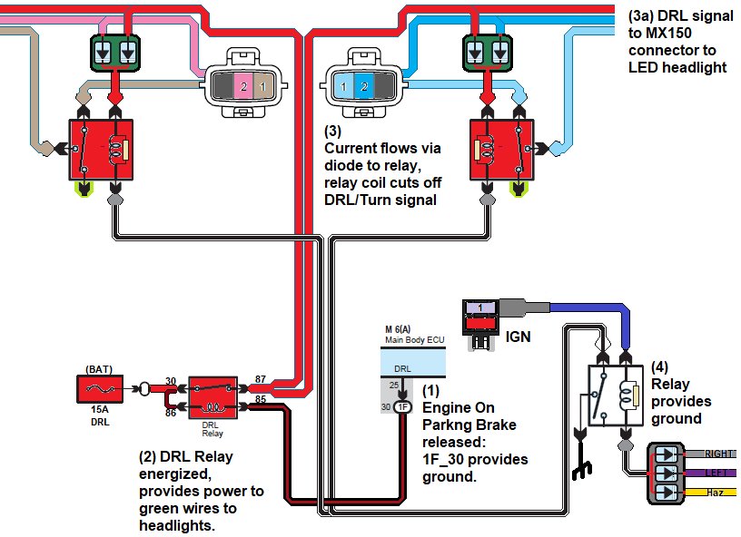

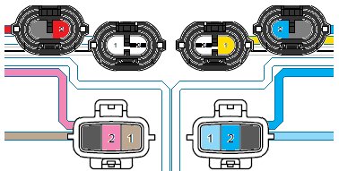

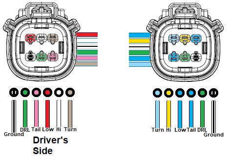

    MX150's to Headlight:
    Corresponding mating connectors to vehicle connectors (DRL/TURN/HAZARD GROUND plugged on receiving side):

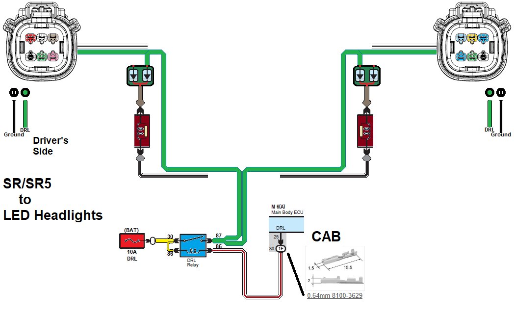

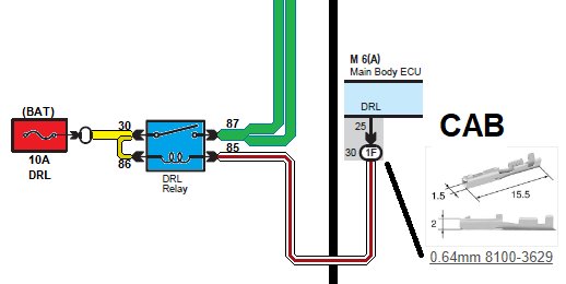

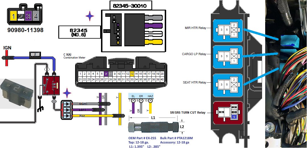

    One wire to cab for DRL added relay, inserted to connector 1F_30 (at Main Body ECU) with female terminal Sumitomo 8100-3529.

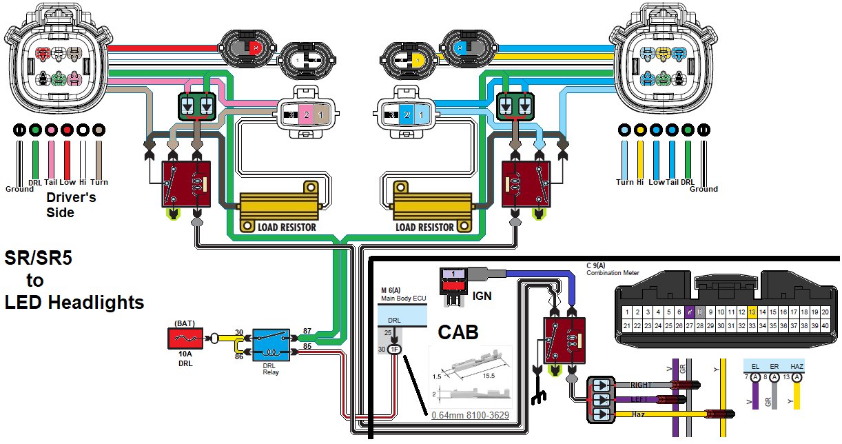

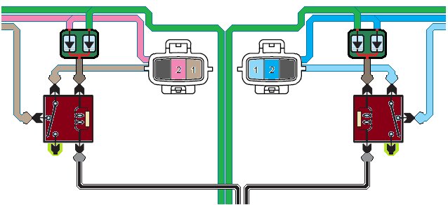

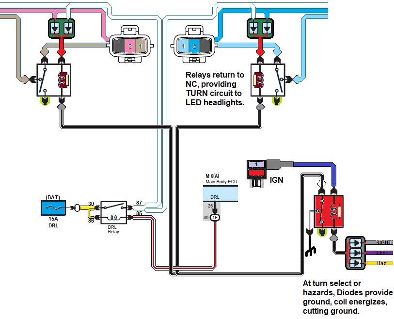

    Relay interrupts the SR DRL/TURN signal
    Power to actuate the relay comes from tap to DRL wire (added circuit) and TAIL circuit. Diodes keep circuits apart. When Low Beams are selected the DRL circuit is disabled, an OEM feature, leaving Tail circuit to continue providing juice.
    This relay (one per side) provides turn feature without DRL in same circuit as the SR has.

    DRL detail:

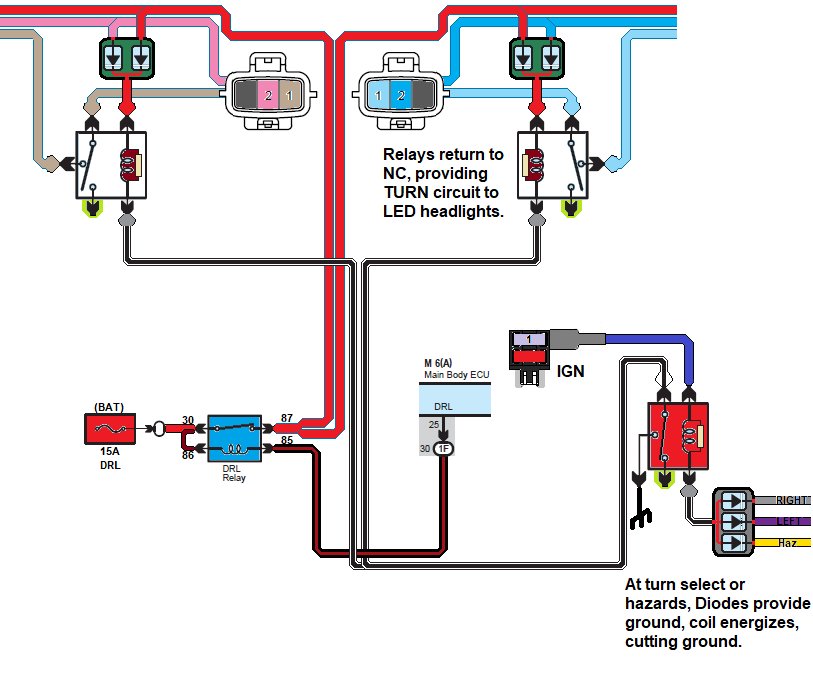

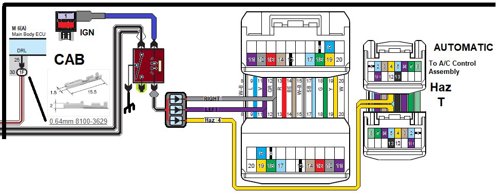

    TURN Control (DRL disable on same wire, SR OEM feature)

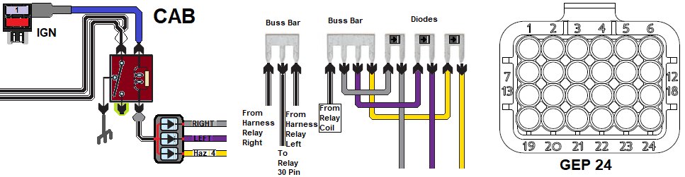

    IGN sourced power to added 5 pin relay, 30 & 87a NC, provides ground to relays at each headlight connector. Triple diodes provide ground to this relay coil to disable ground that the relay provides, returning relays at each headlight to enable turns/hazards.
    At vehicle OFF the added turn relays at each headlight rest at TURN circuit.

    Once low beams are selected, DRL relay looses ground, system looses DRL. LED headlight DRL goes to DIM via TAIL circuit input. Added relays remain functional via Tail circuit via diode to added relays.

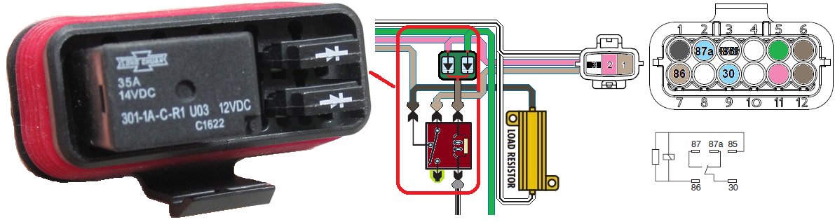

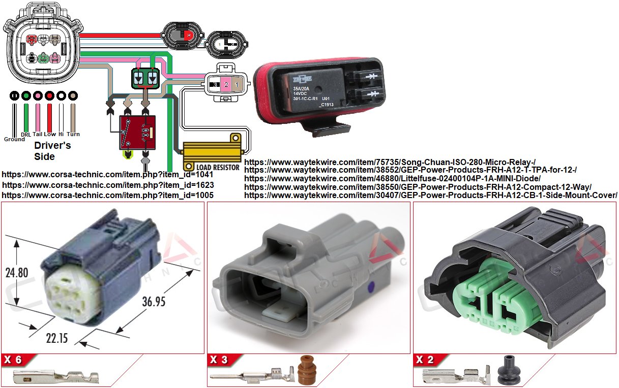

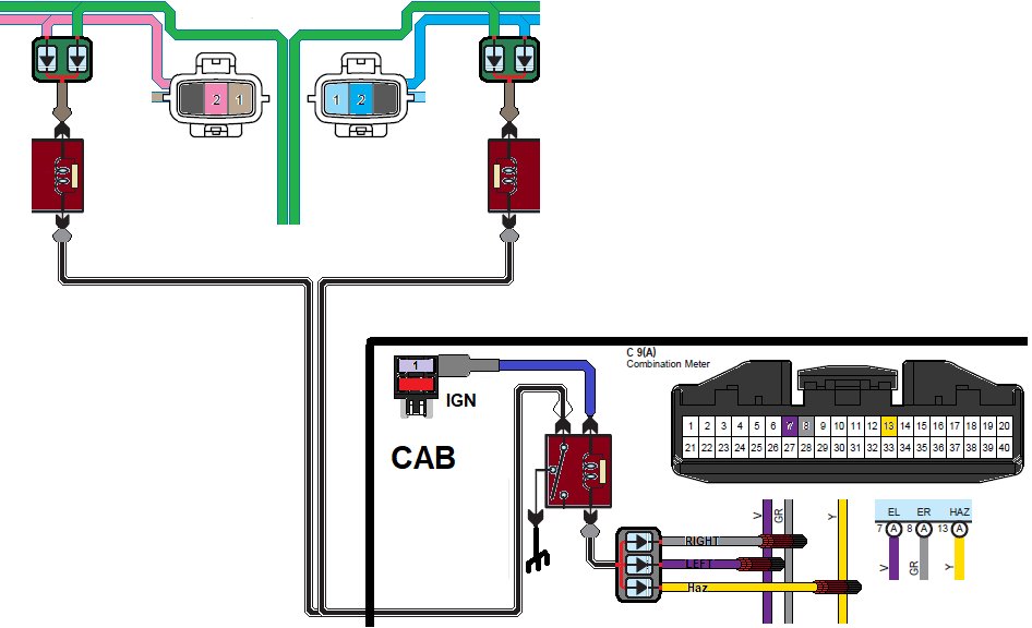

    Sealed fender box for relay and diodes near headlight (x2) and resistor for hyperflash issues (a few choices to install):
    Adding interior relay and triple diode:
    Stand alone is another option.

    Engine bay parts & links.
    Waytek

    Interior relay & diode set up. (Overbuilt)

    Caribe, you haven’t addressed hyperflashing. That’s a big part of the PIA. Another wrinkle is Oem tails vs VLED vs MESO vs aftermarket.

    For hyperflash, one must play with the various versions of resistor. There are so many versions/types to chose from and so many cheap/butcher resistor adds to the other proper installs. All work, one will last longer than others.
