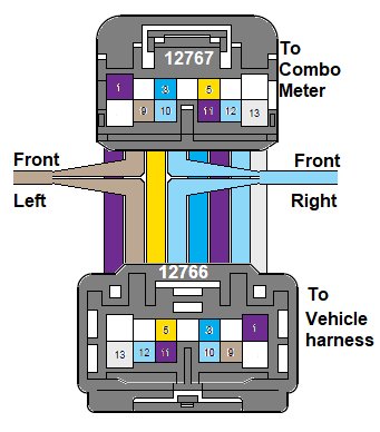

    Snipped OEM connectors for direct terminal crimp to MX150 connector.
    No returning to OEM without disassembly of MX150 and snipping MX150 terminals then stripping and crimping proper terminals and inserting into OEM connectors.
    Or assembling an "opposite" harness to mate to the MX150.

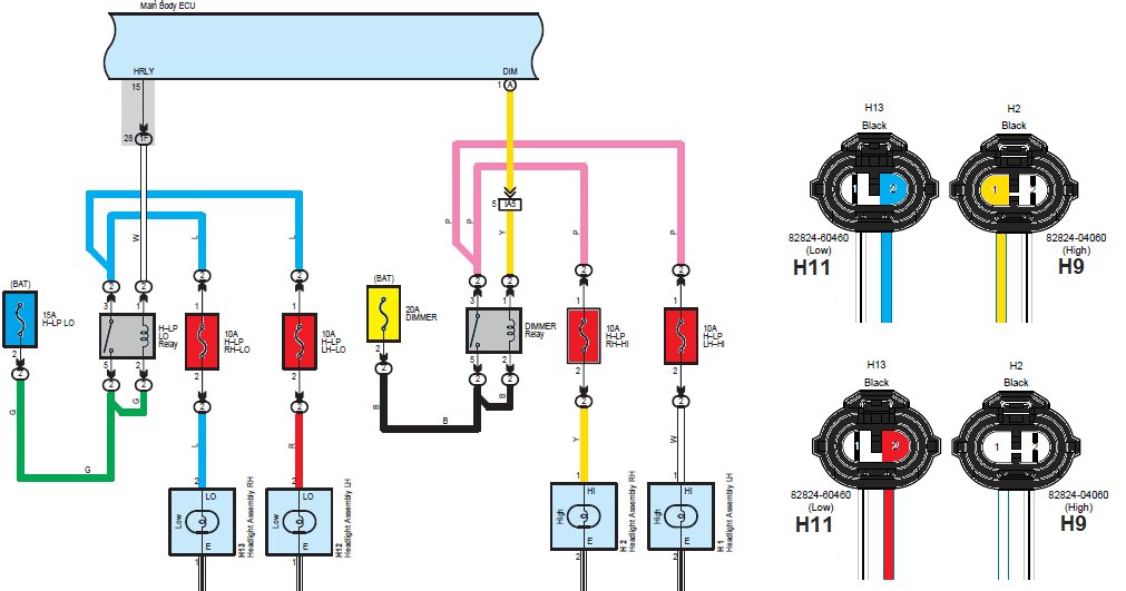

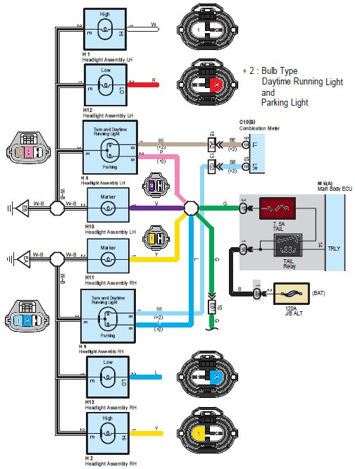

    SR headlight circuit detail for reference:
    High & Low beams each have a common fuse (battery) which feeds a relay, post relay there's a fuse for each lamp.
    See here:
