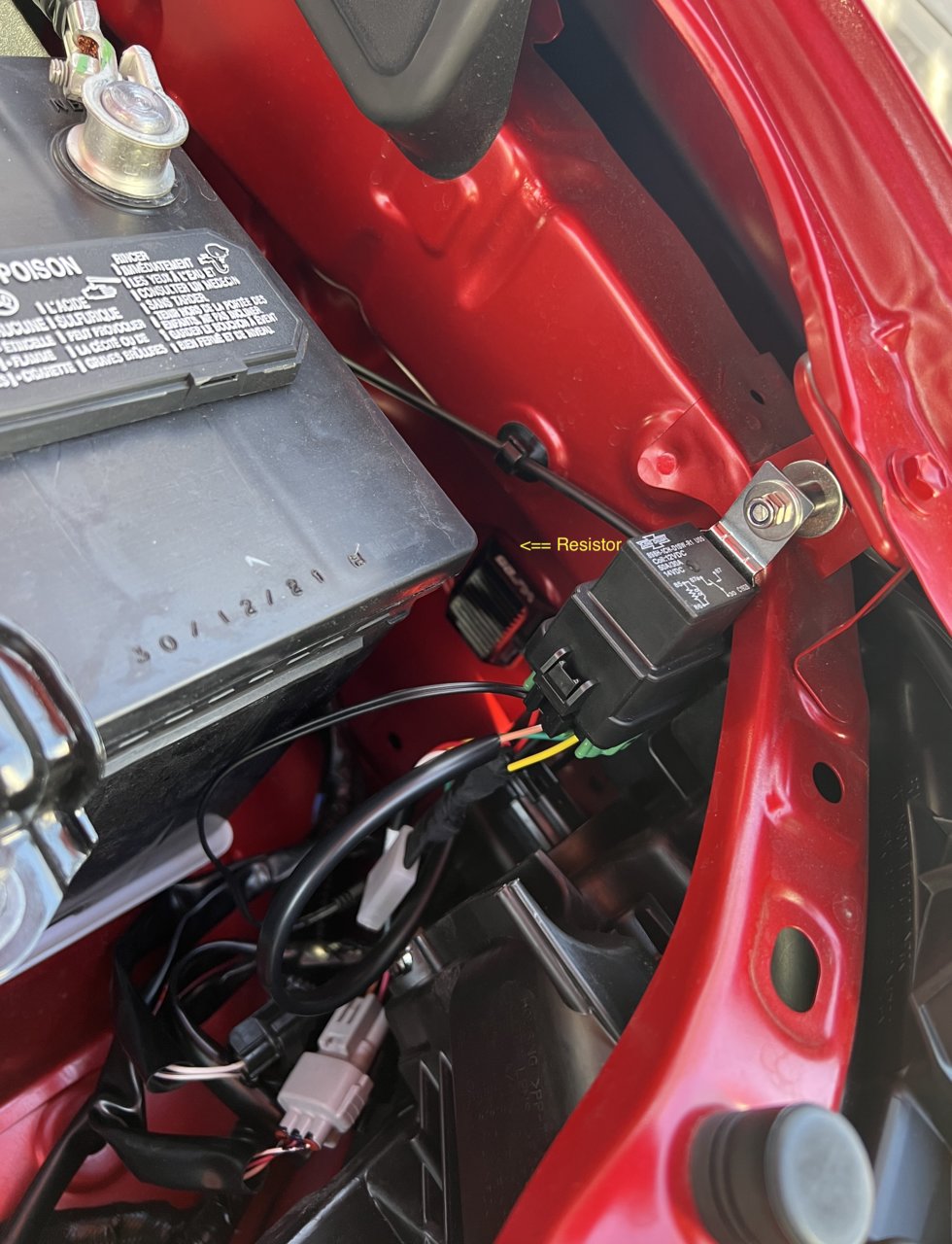

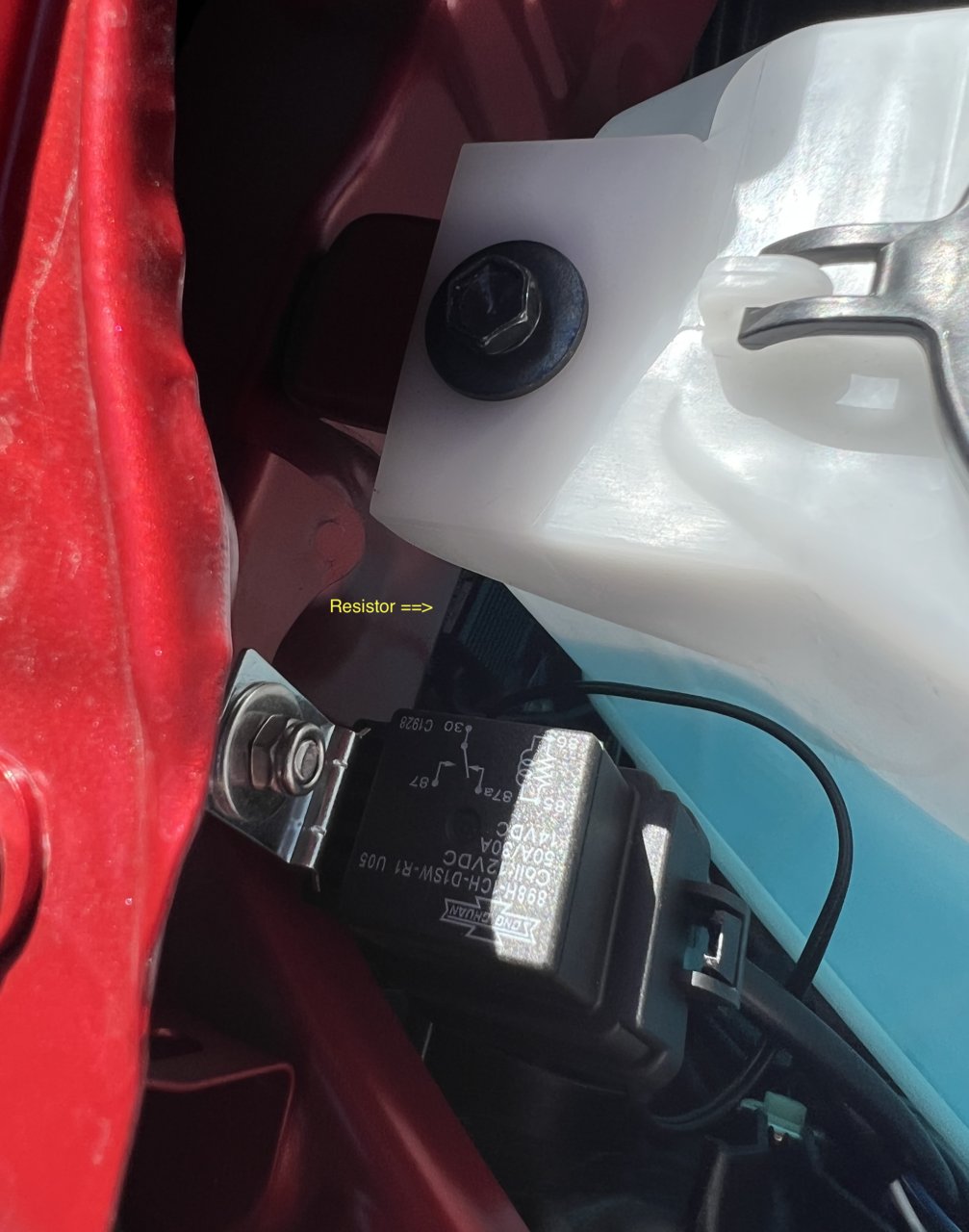

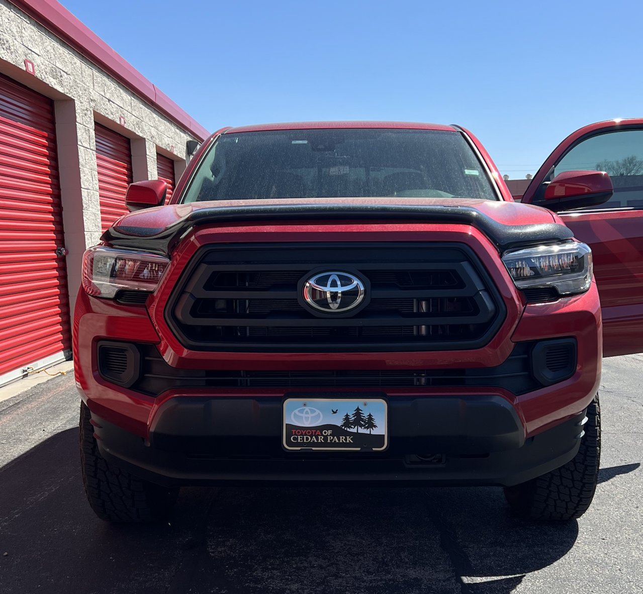

    Just installed it
    it was WAY easier than I thought on an SR, no fender flare means I didn't have to struggle to peel apart the bumper to reveal the 10mm
    OP's instruction is very accurate, one thing I'd like to add is that you might want to use electric hand wrench to tighten the 8mm locking nut, hand tightening was a bit painful
    here is how everything looks with red body paint
    I didn't zip tie anything
    I did install resistors provided by the OP
    I also run MESO stage 1 in the rear and I needed the plug and play resistors provided by MESO too in the rear, otherwise I'd get hyperflashing

    Testing the lights in front of a mirror
    https://youtu.be/VL6j0lXACn8
    DRL would not light up in P stationary, so the video's shot in D standing still
    1. Starting off from stalk setting on DRL
    2. and then OFF
    3. and then back up one notch to DRL, you can see the amber flash and delay
    4. and then up another notch to parking lights, instant on
    5. and then low beams, high beams, you can see the dimmed DRL
    6. and back to parking lights, similar to #3
    7. and back to DRL
    8. testing left and right signal, slight delay getting back to white DRL
    9. and OFF
    A little bit different from the OEM behavior but I'm very satisfied nonetheless
