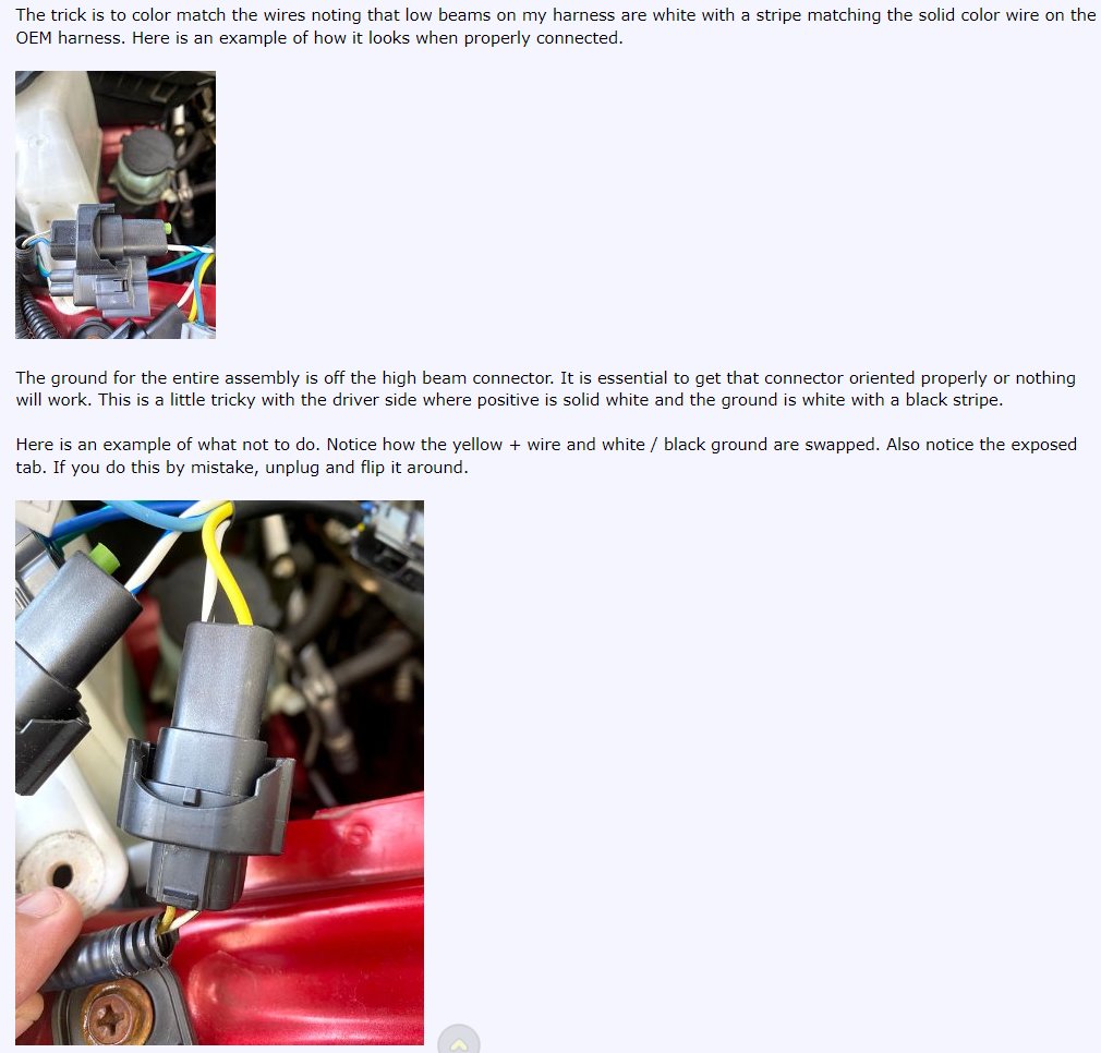

    Everyone with SR / SR5 harnesses. Polarity is super important with these (just as with the TRD OEM LED conversion harnesses). White w black stripe always to white with black stripe, that is the ground, it is labeled as such. Positive high beam on the driver side is solid white, it's easy to get that confused. Positive high beam on the passenger side is solid yellow. I didn't realize anything would work on the SR harnesses without that ground established since the TRD harnesses are completely non operational until polarity is correct on that piece. Unfortunately there is no OEM male H9 connector and no way to force polarity, you have to line up the colors and match the tabs to the curved H9/H11 females.
    Lots and lots of people have had some legit trouble with this piece and I haven't hammered the point home well enough but it's the entire reason why we include labels on each wire. If anyone is confused, more detail here:

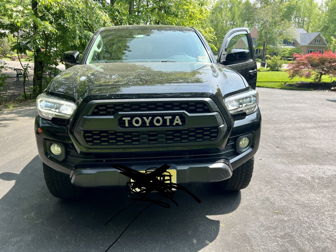

    Thanks Dave and Johnny for the help on this. V2 harness worked beautifully. No resistors neeeded as of now. Still in observation period but looks great and man what a difference. Night and day between halogens. So happy I made this upgrade

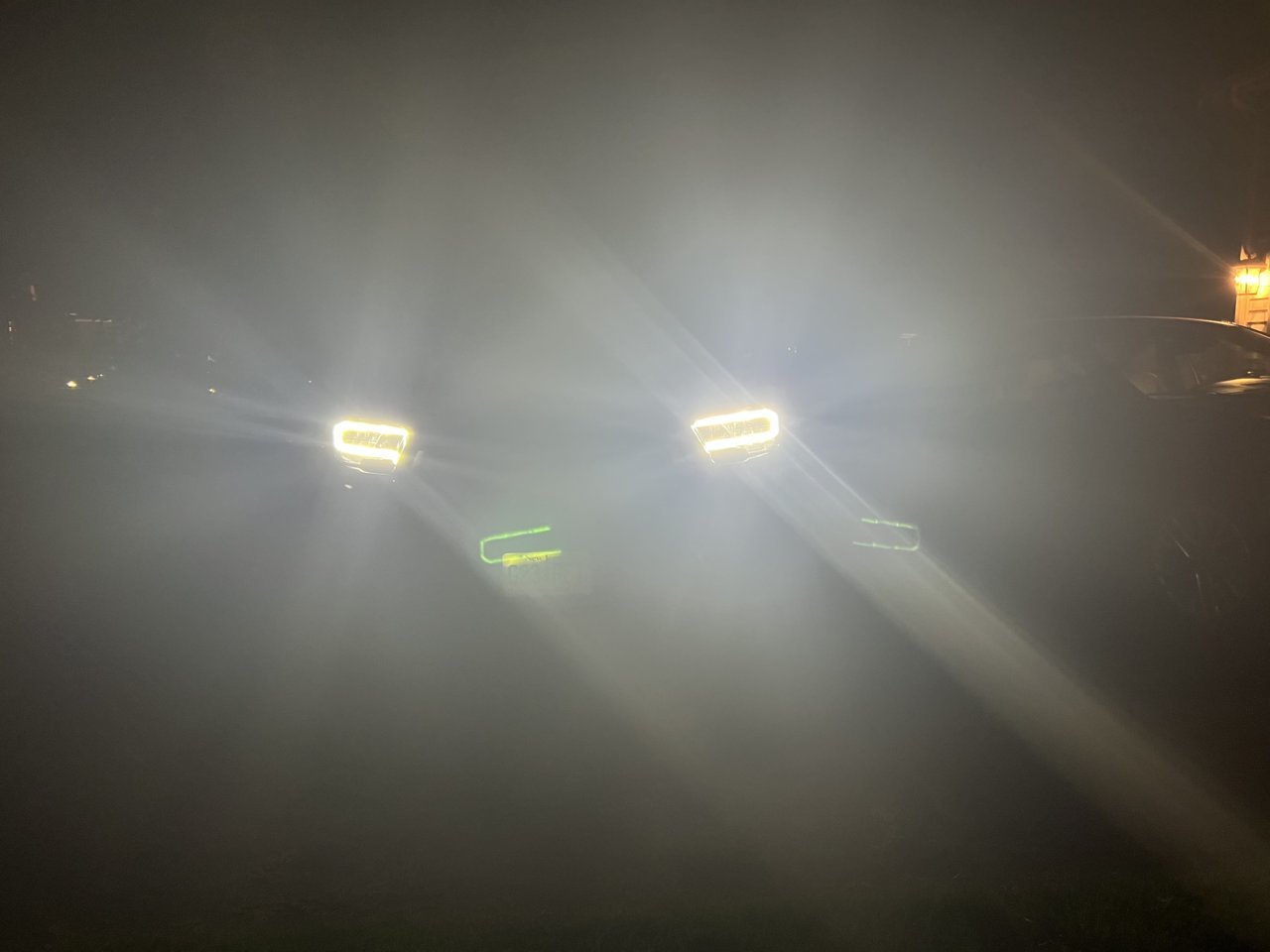

    Update, day 2 oem headlights v2 harness are working flawlessly. I have a stock sr5 no upgraded leds of any kind. I think this the key to success with the v2 harness. As long as you don’t have other leds they work as they are supposed to. And no resistors were needed
