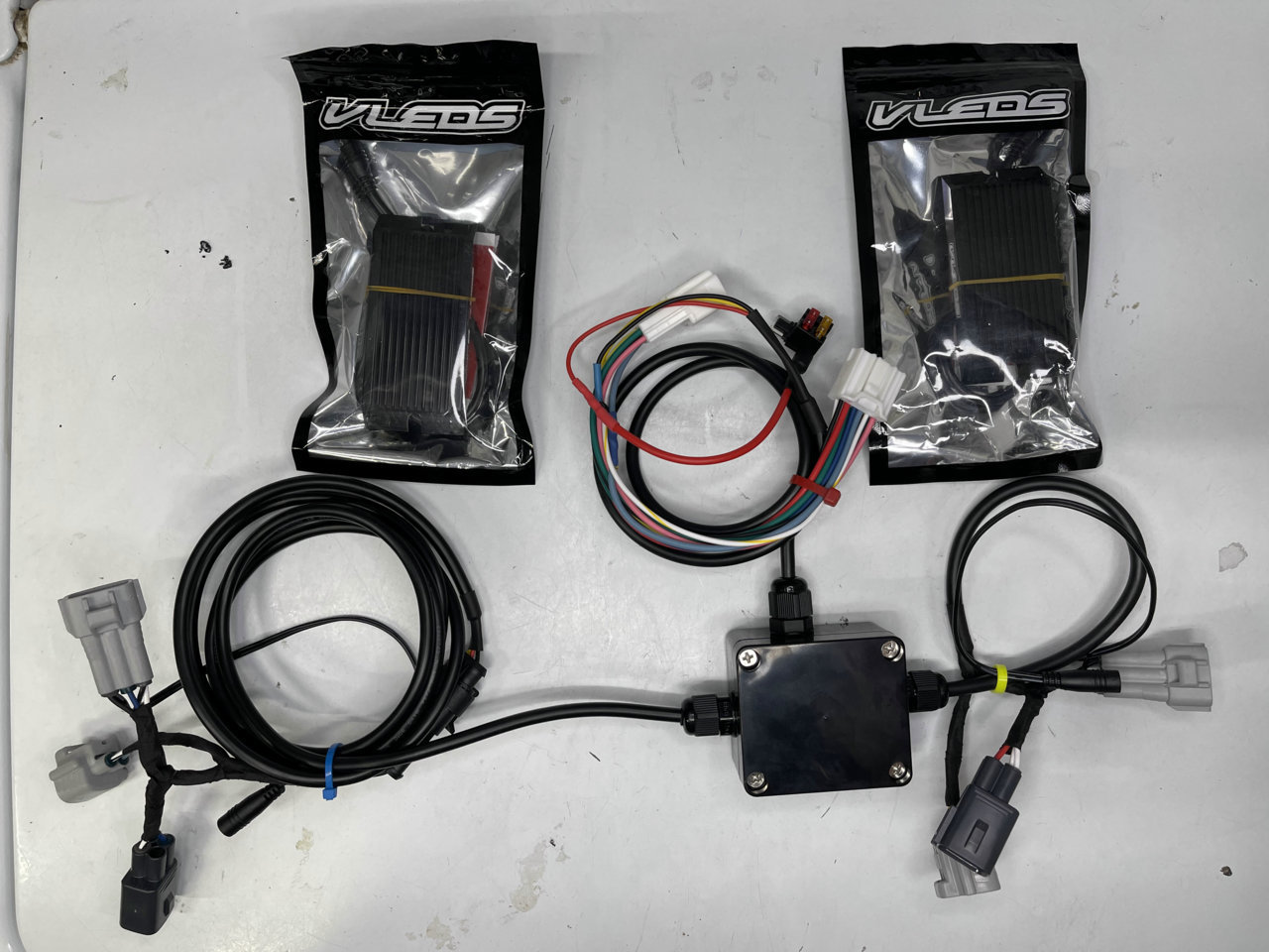

    So, here is my latest creation:
    IMG_9877.HEIC.jpgNow, to what it does: It converts SR/SR5 to TRD headlight plugs. Specifically, the turn and DRL (everything else is the same between the two, so no conversion needed). I know there are other options for this, but here is what makes mine different: Mine will make the headlights act just like the TRD models do. The only exception to this is when you turn on the DRL, there is a 1-2 second delay. That's it. Other than that, they act like stock TRD headlights in every way.
    When you turn the stalk switch off, the DRL turns off (as opposed to the kits that use the ignition fuse to drive them, causing the DRL to be on full brightness all the time, regardless of stalk setting). When you turn the stalk to DRL or AUTO, the DRL lights come on full brightness. When you turn the stalk to parking/running lights, the DRL stays full brightness. And lastly, when turn the stalk to low beams, the DRL dims. So just like TRD headlights are supposed to act!
    There are three parts to this harness. One wire that goes to the passenger side headlight, one that goes to the drivers side headlight, and one that goes to the fuse box under the hood. I will post installation instructions next weekend, but it isn't hard. Maybe a half an hour job. The only tool that is required is a small flat screwdriver, and that is just to pry a tab with.
    This kit does require resistors (included) and changing the front turn signal 7440 bulb to an LED (not included. I figure you would want to make a choice as to which bulbs you want).
    I asking $150 for the headlight conversion harness (that might go up with future builds. These take over $100 in parts, and a lot of time. I plan on timing it when I do the next batch, but I am guessing I have 3 or so hours in it).
    I have a second option that I am asking $175 for. This version will have a 2 port plug on it for grille lights. The grille lights will act just like the DRL does. off with the DRL, full brightness when the DRL is on full brightness, and dimmed (the amount it is dimmed can be adjusted, so it's up to you) when the DRL is dimmed. This one may be a one off, I haven't decided yet. It will not include the grille lights, but will include a male plug for you to hook the grille lights to.
    As of right now, I don't plan on making more of these for a while, but if these have a decent amount of interest, I might make more down the road. So if it's sold, but you are still interested, let me know.
    Thanks for looking, and feel free to ask any questions you might have.

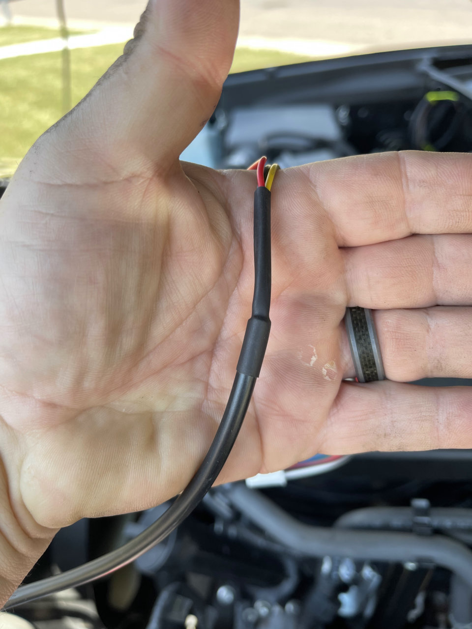

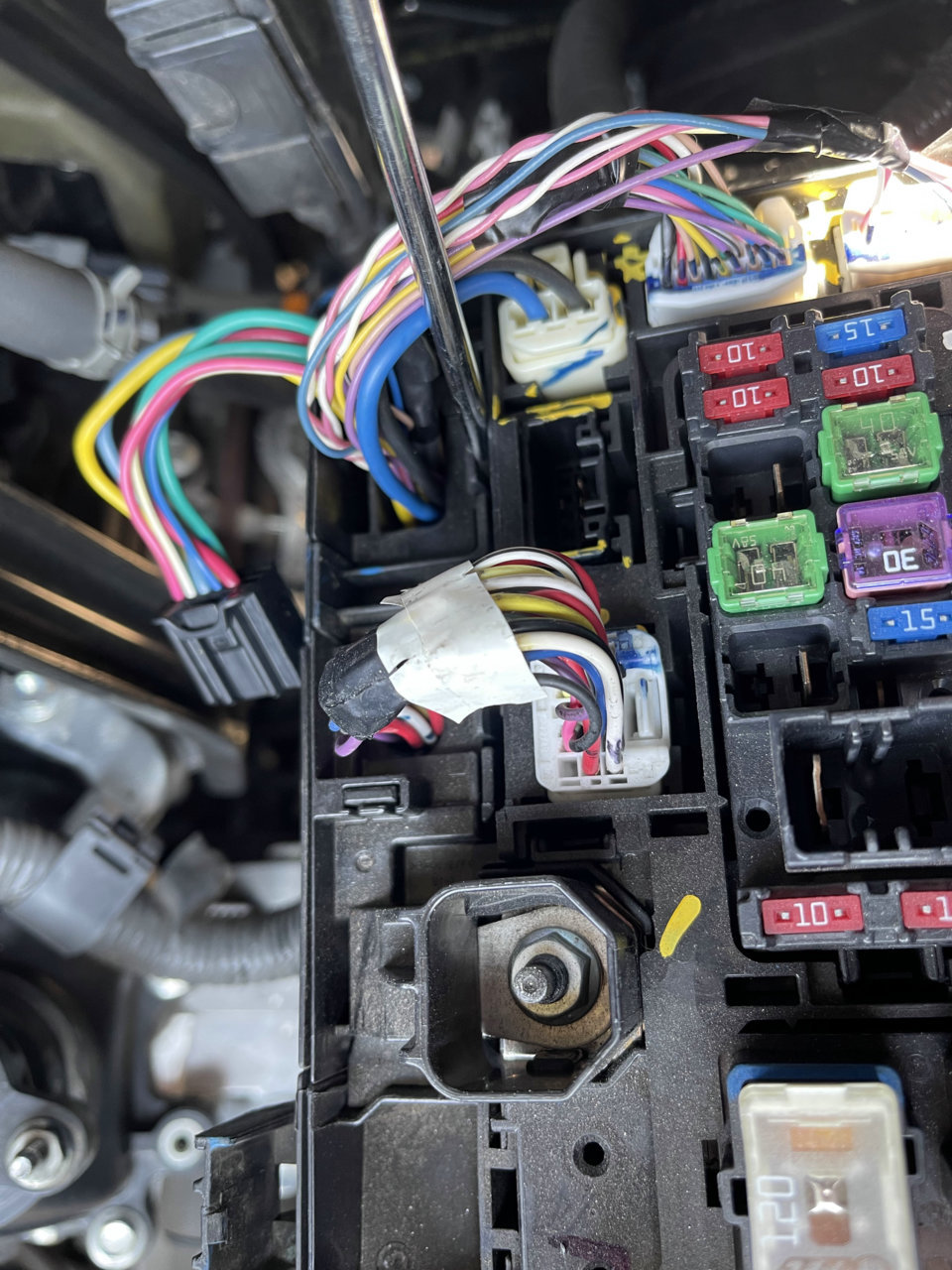

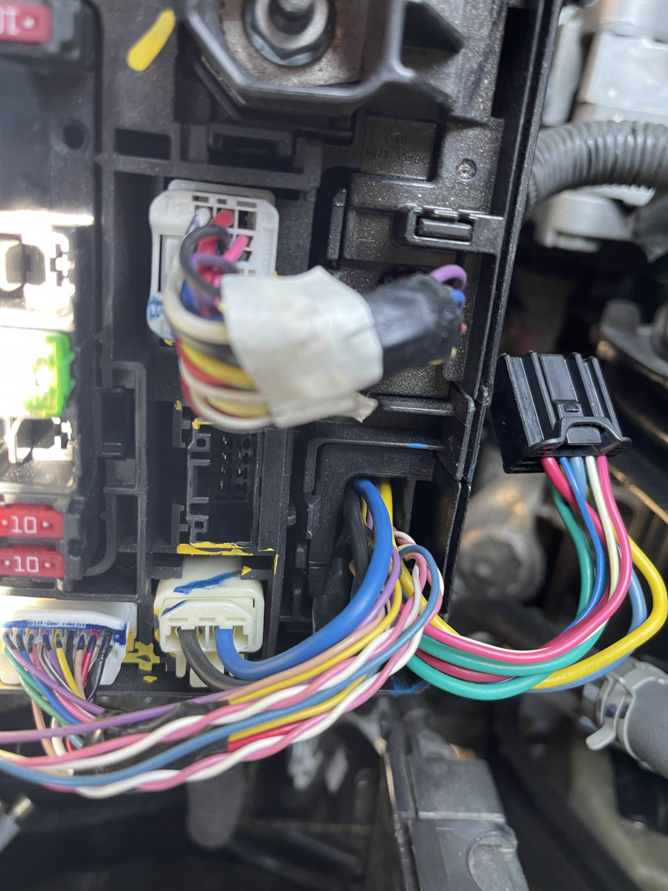

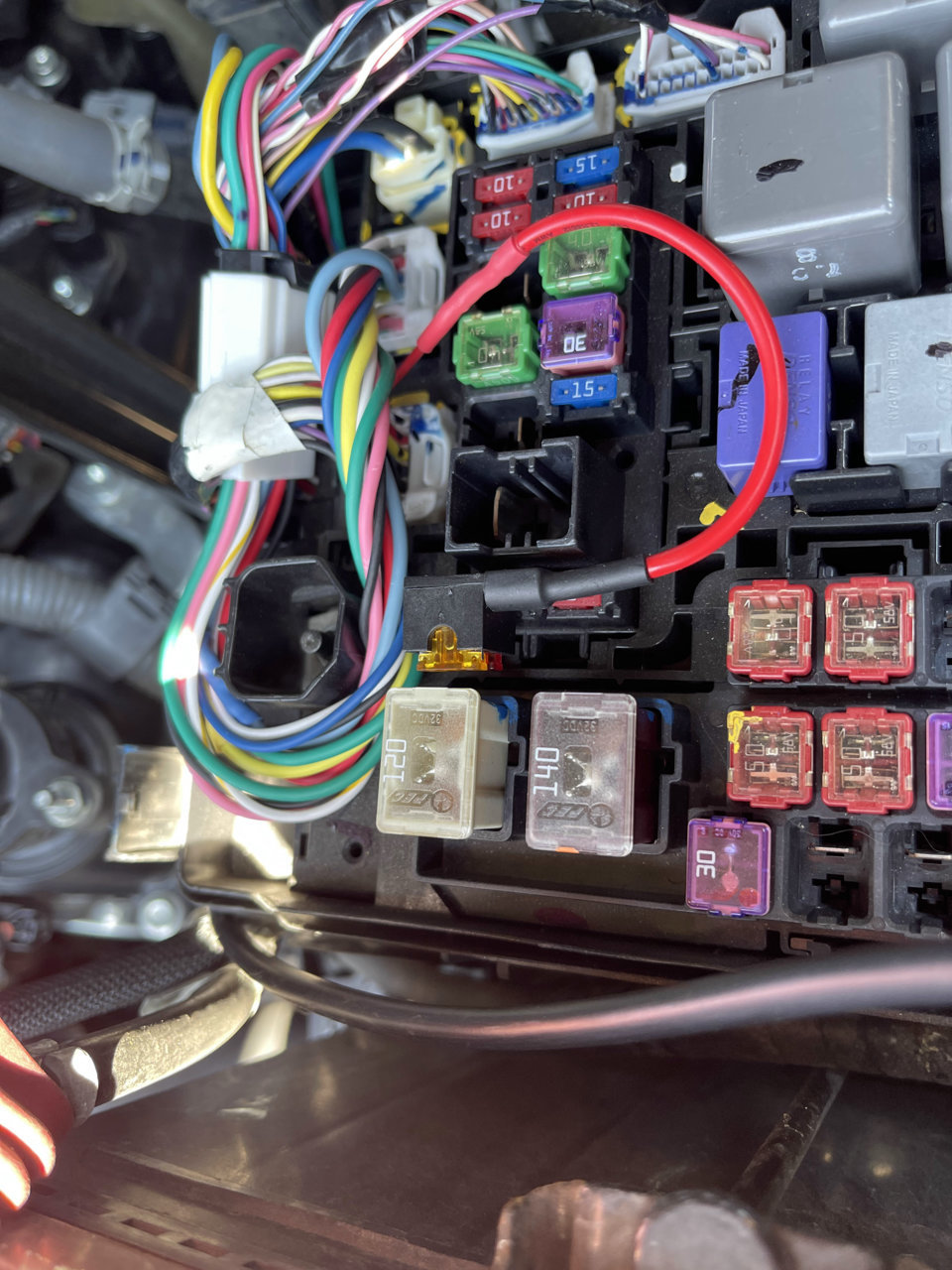

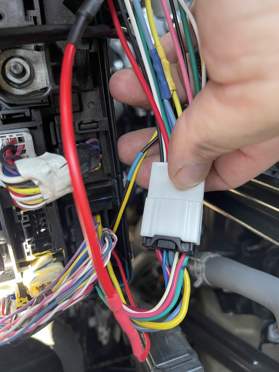

    How to install:
    First, a disclaimer. I suck at explaining things.
    Okay, now to it. The harness consists of three main parts coming out of a little black box. The box itself is mean to be mounted between the battery and the drivers side headlight. There is a little flat spot there that works great for it.
    --Holding for a picture of said mounting spot--

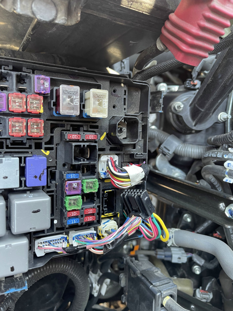

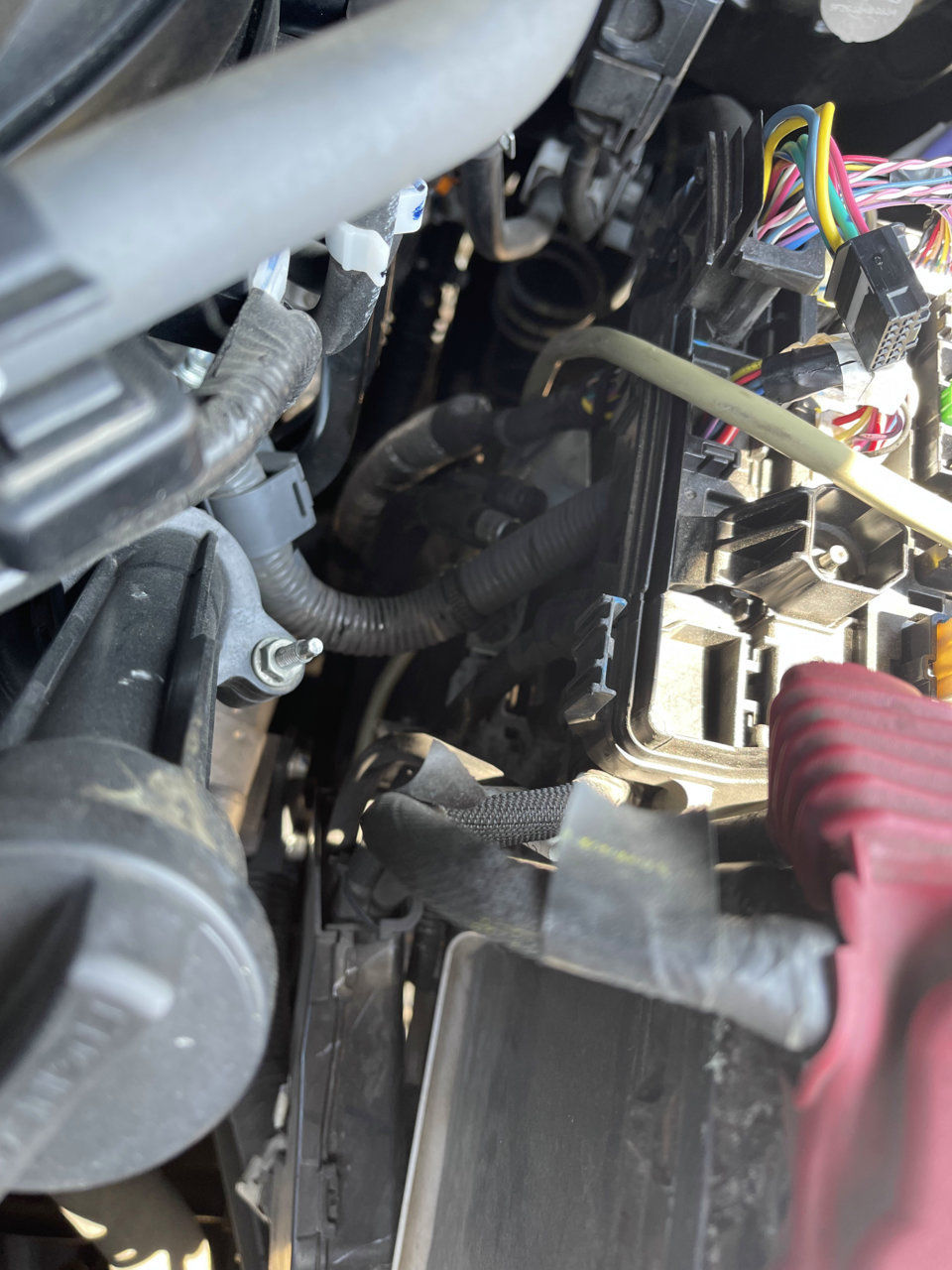

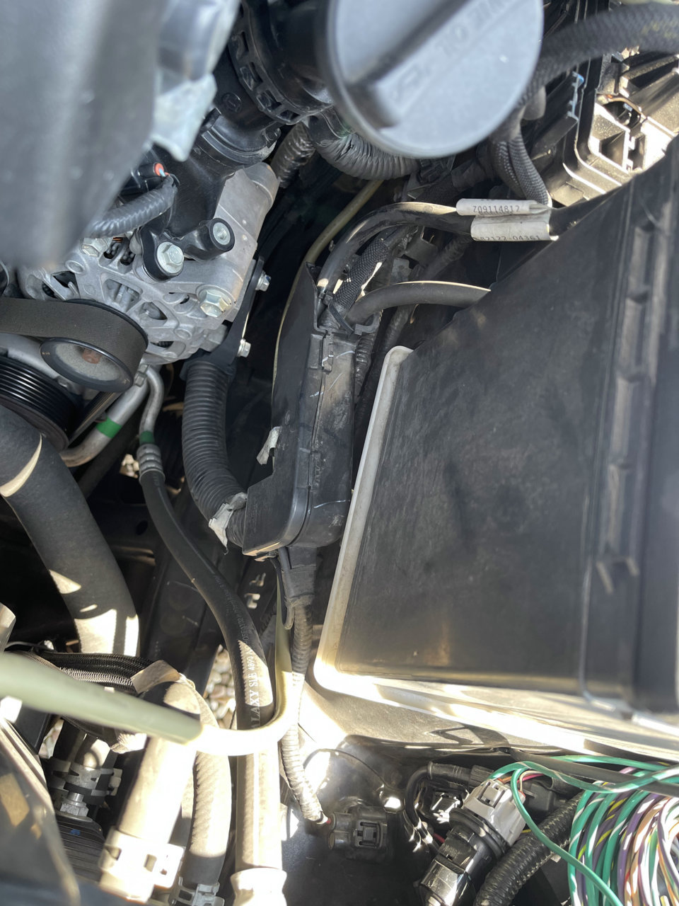

    Now as to the three wires coming out of that box; First we will deal with the one that goes to the fuse box. This one:

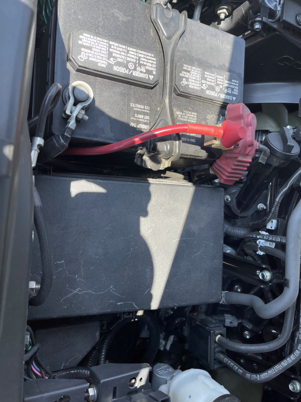

    You will want to route it behind the OEM cables to the passengers side of the battery (I tried using a brown extension cord here just so it would show up better). Be patient and just work it a little at a time so it doesn't snag, and you'll get it through. If you are really impatient, you can alternatively just run it on the outside of those stock cables and zip tie it I suppose. I like running through them though as it keeps the wire out of danger and looks cleaner. We are aiming for the back passengers side of this fuse box:
    Hopefully you can see the route I took with my tan cord here:
    Once you are back to there with that bundle of plugs and fuse tap, we now have to route it to the inside of the fuse box. So find this plug and go ahead and unplug it. Yours may have more wires it in than mine, but the plug itself will be the same. It's the black one seen here:

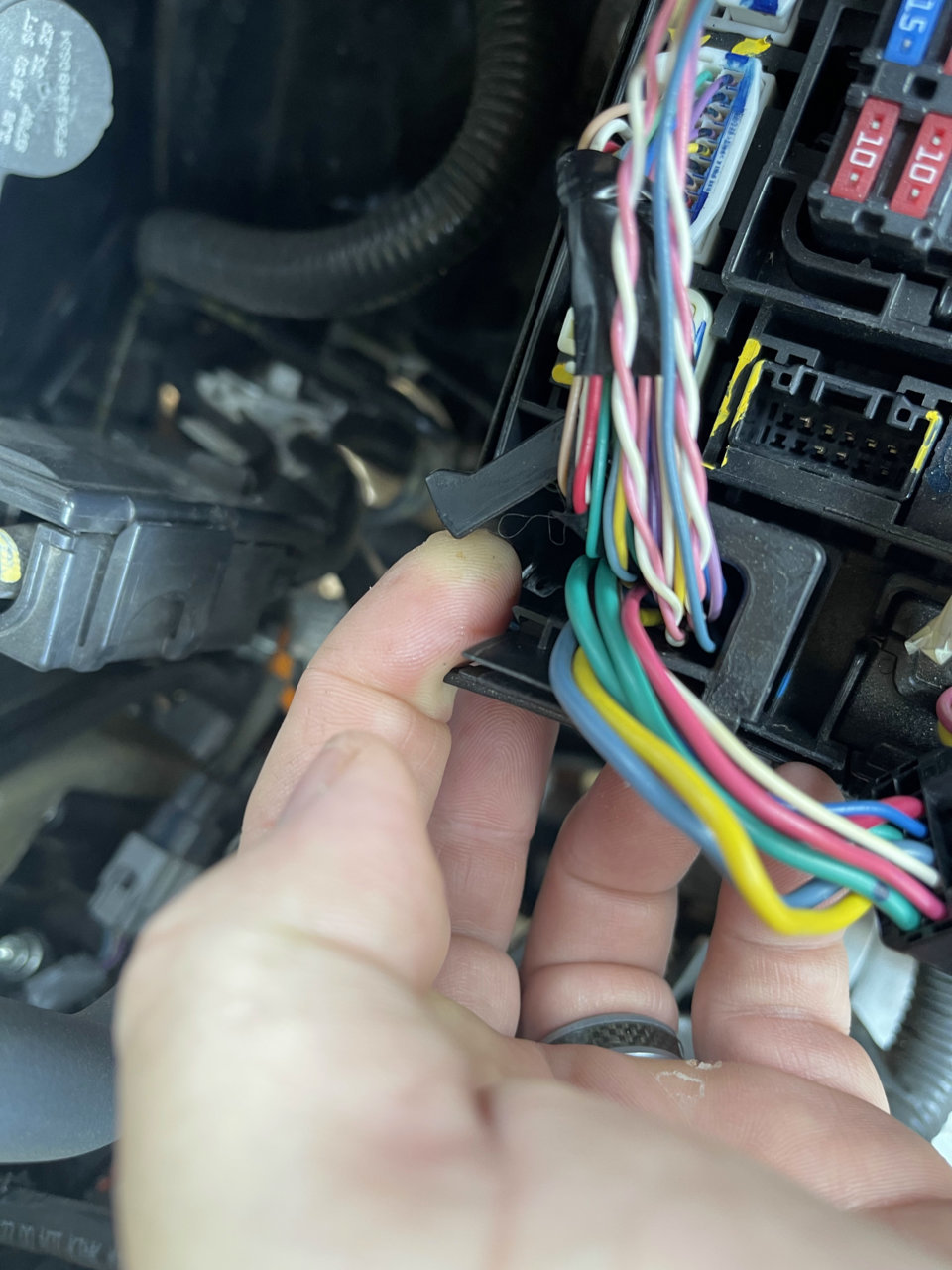

    Now right to the passengers side of that plug is a little tab. You can hopefully tell which one here:
    Here it is with my screwdriver next to it:
    Pull that tab toward the drivers side. It should move really easy, so not a lot of force is needed here. While holding that tab to the side, put your finger on the other side of that bundle of wires. feel to the bottom of the fuse box right where that bundle is, and lift it up.
    Now, toward the back of that little plastic housing, there is a door. You just need to lift the top and pop it open:
    You can now feed the skinny portion of the heat shrunk part through there. The heat shrink is there to hold it together and off additional chaffing protection.
    You will be running it up the side of the existing bundle of wires. Insert it like so:
    Now go ahead and close the door, and slide that whole thing back into place. That little tab you held earlier should click back into place. If you're still with me, congratulations, you've finish the hardest part IMO.

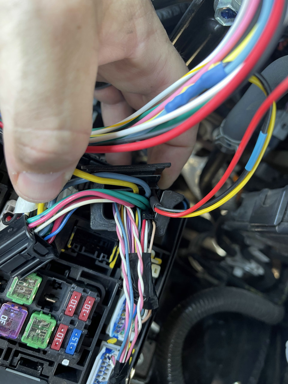

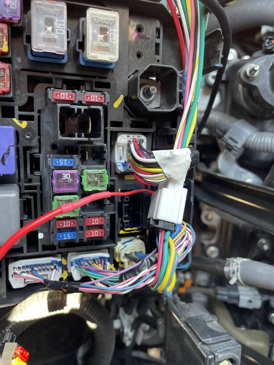

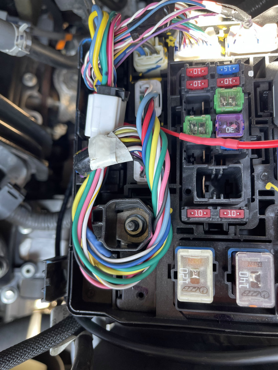

    Now, to do something with that bundle of wires you just ran into the fuse box. Remember the black plug we unplugged earlier to get out of the way? Well, you can now plug it into one side of the harness we just ran there.
    14.HEIC.jpg Now, the way I do this part is unplug the harness next to where the black one was, and run the bundle of wires under that bundle of wires, except the fuse tap part. Once its under there, you can plug that one back in. We should now have something resembling this:
    Now we will take the part of the new harness that is still not connected to anything and kind of loop it back, going around where that bolt is. Once that is ran, go ahead and plug the new white plug where the old black plug was.
    Now to the fuse tap portion: Pull this 10A fuse.
    And plug in the new tap there. Make sure the 10A fuse is on the bottom (it should be shipped like that, but double check) and the 5A is on the top.
    That's it for that part! Go ahead and close that fuse box up. Be cautious of any wires hanging out of the box as you do it. Now to the headlights themselves!

    Instructions worked great. No issues with the harness during install or with final function. Thanks @Puppypunter for this harness and all the 'tech support' along the way. :bowdown:

    What signals are in the red and yellow outputs? +12 and ignition switched?

    Red is power. It goes to the INJ1 fuse (don’t quote me on that, I could have the name wrong). The 10A replaces the factory 10A fuse, and the 5A piggybacks off of it. So it is only hot with ignition. I have heard from some that use it for grille lights that it can become hot at random times for some reason, but even if it did in this case it wouldn’t matter. There isn’t any draw because there isn’t any trigger.
    The black is the right turn signal and the yellow is the left turn signal. They are tapping the rear signals. This is why LED bulbs have to be used with this, so it doesn’t overload that circuit. Ground is actually pulled from the turn/parking lights. The exception to that is the one I made that has the dimming grille lights. I made it a separate chassis ground just because the grille lights could use a better ground. Without the grille lights, the only thing that ground is getting used for is the relay, so not a lot of added draw there. Sometime you’ll be getting the how-to on these. I’m not opposed to sharing that info, it’s just that there is a LOT going on, so writing instructions is kind of a daunting task.
