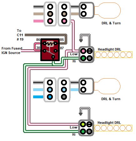

    Added bonus is TURN is an added DRL and the Tail Circuit to original connector can be pigtailed to Grill lamps or other added lights.

    Having the turn signal remain a drl really isn’t a bonus. It won’t look right having a white led strip with the amber drl bulb.

    Think Napolitano Ice cream...:rolleyes:...for you, it might be eat the vanilla, leave the rest to everyone else.:burp:

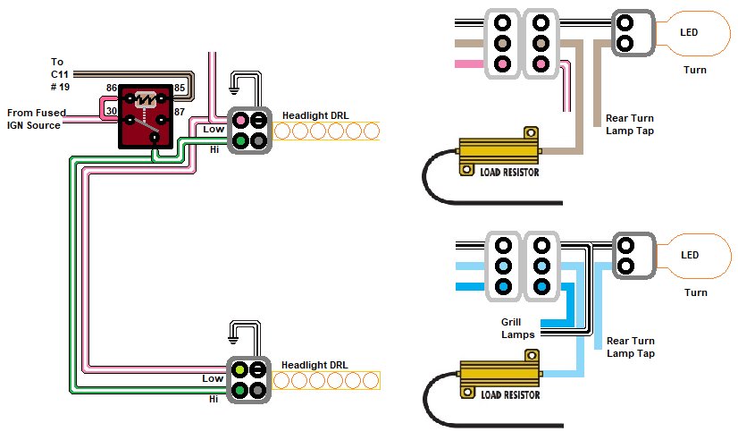

    One side tap for Grill Lamps if needed.
