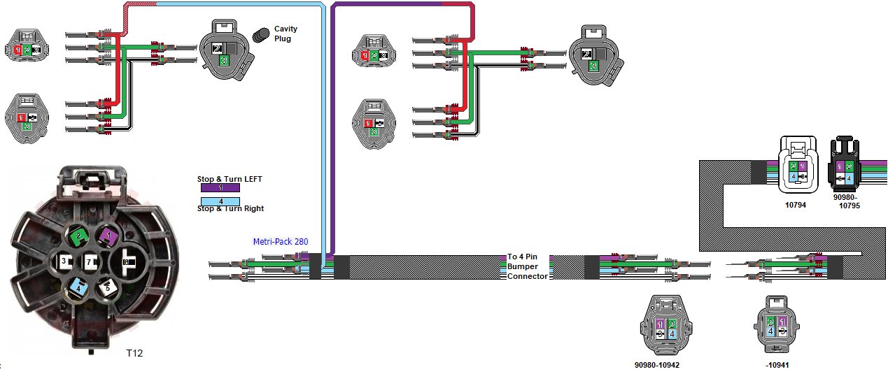

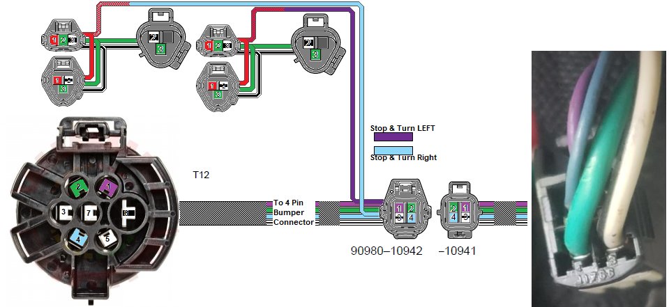

    TAIL (Green_2)
    Ground (White w Black Stripe_3)
    Towing Stop & Turn Left (Violet_1)
    Towing Stop & Turn Right (Sky Blue_4)

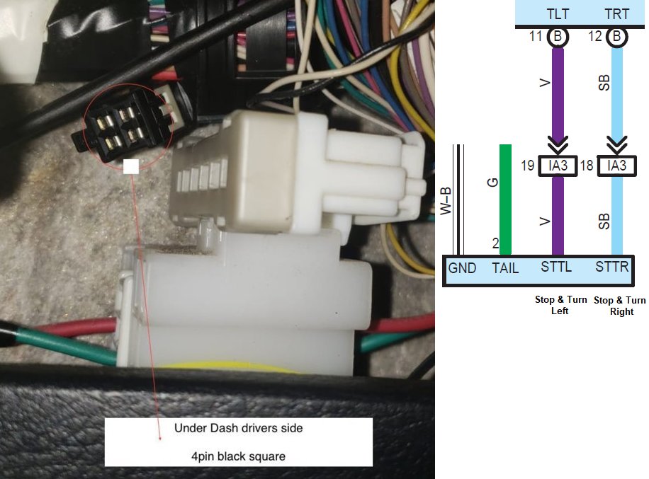

    Original Stop connector (both sides) provides Ground & Tail.
    Mating connector to Stop Connector splits to Rear Tail Light Assembly Turn & Stop.
    Wires from towing harness provides Full C illumination for Turn & Stop.
    Harness from cab (4 wires, loomed) mates to cab connector (hidden behind driver's kick panel connectors tray) needs to be routed along door sill to under driver's seat then through floor grommet. Runs to rear parallel to OEM harness. T12 towing is a separate harness incase it gets destroyed, it can be replaced. Like 2nd Gen towing harness.
    Missing circuits to T12 (7 pin Tow Connector) can be added later as separate circuits they are.
