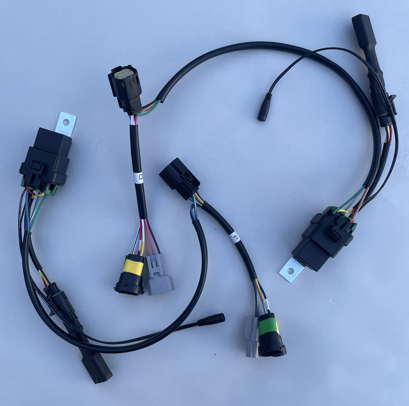

    I am starting a new thread for these, just to clear up a few things and try to get all the relevant information condensed a little.
    These are the V2 harnesses for adding OEM headlights to the SR and SR5 with halogen headlights.
    They are $200 shipped in the States. I can do Canada as well, but shoot me a PM first.
    If you have a TRD trim truck, hit up @daveeasa or visit his website Headlight | FBC Harness Solutions (square.site) for the harness you need. These are for the trucks without the "L" shaped LED DRL.
    The V2 is universal for these trims (SR, SR5, Limited, Trail Edition), fully plug and play, simple to install, and work regardless if you have AUTO or DRL on the headlight stalk switch.
    BENEFITS of the V2:
    -Universal, no need to disable anything.
    -Will retain the functionality of the stalk switch. They will turn on and off with the appropriate stalk setting. Unlike running a fuse to the fuse box, where the DRL will be on whenever the truck is on, regardless of stalk setting.
    -They will dim when the low beams are on (like they are supposed to).
    -easy to install. If you can match colors and put the square block in the square hole, you can install these.
    -The electromechanical components are replaceable. If you need to replace something down the road, and I am not around anymore for some reason, you can. The relays are obtainable (though sometimes for more money than they should be) and the timers can be ordered straight from the manufacturer. He will even program them for you. You will just need to splice the new ones in, which isn't hard.
    CONS of the V2:
    -While they do perform like stock TRD as far as function, they do have a slight delay. This delay is about an additional second (0.8s to be exact) when switching the DRL on. So going from off to DRL/AUTO, there will be an additional delay. And when going from low beam back to park, there is the same additional delay. I am saying additional because the stock TRDs with these have a delay as well, they are a switchback after all, so it is built into the headlight. These have additional logic though, so it takes that extra second. It isn't very noticeable though, and I don't think anyone has ever complained about it. I just want to be as transparent as possible here.
    - Price. I know these are pricey at $200 for the set, I get that! If I could make them cheaper, I would. Hopefully my reputation precedes me here that I try to off the stuff I make at a fair price. Dave and I have discussed this quite a bit, and we are seeking ways to lessen the cost. But in order to make them where I am comfortable with the durability and serviceability, that price is where I am at for now.
    -These usually require a set of resistors to function correctly (they are included). More on that below.

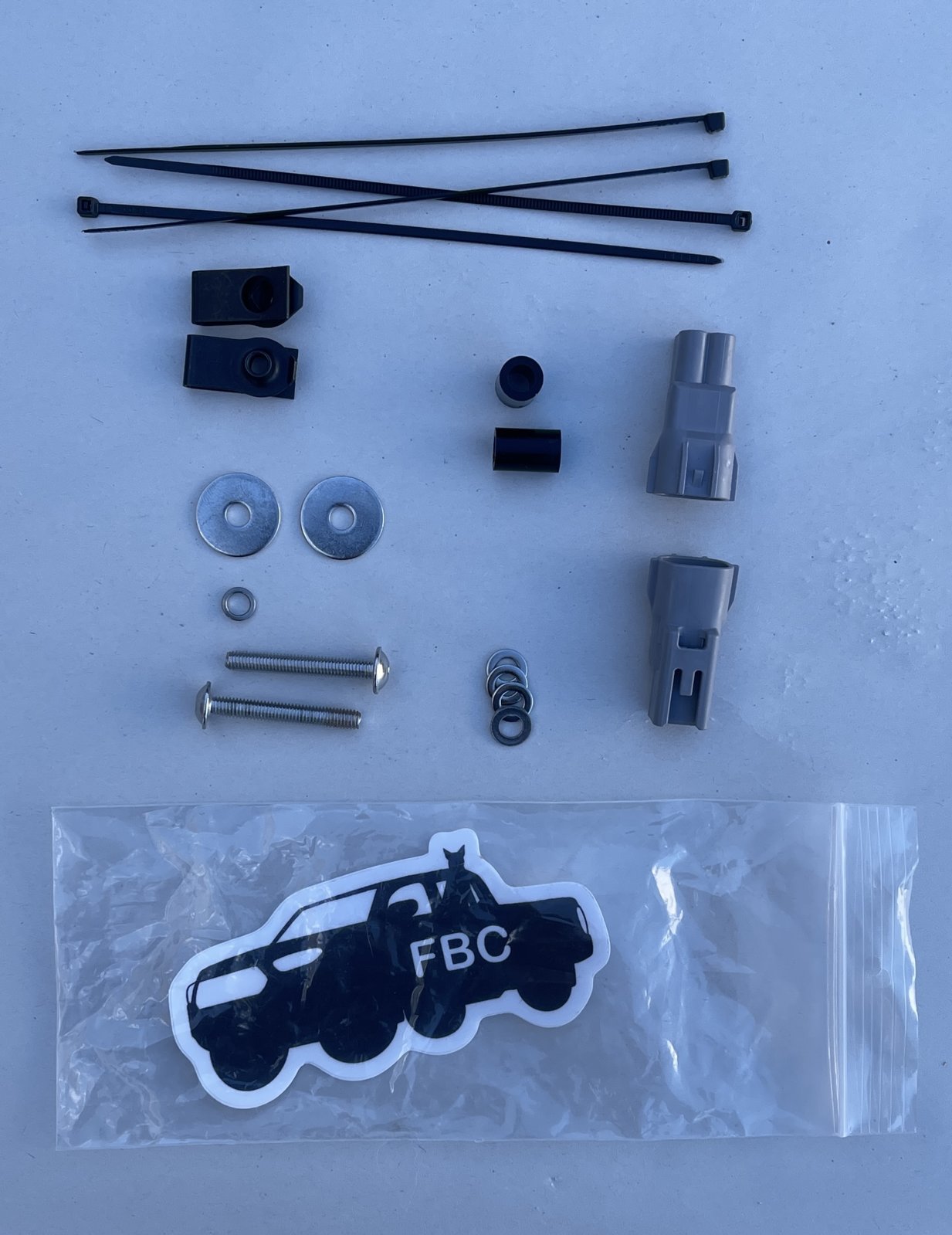

    WHAT IS INCLUDED: For $200 you will get (2) harnesses. One for the drivers side, one for the passengers side. They are the same thing, just color matched to their respective sides. (2) resistors (VLED VLR25 resistors). I like their stuff as it is well made and has great heat dissipation. Also, if you have one fail (it's rare, but it can happen), they are easy enough to order from VLEDs direct. You will also get the necessary hardware to mount these up by the fender, and caps for the unused side marker plug just to keep it clean if you ever need to use it again.

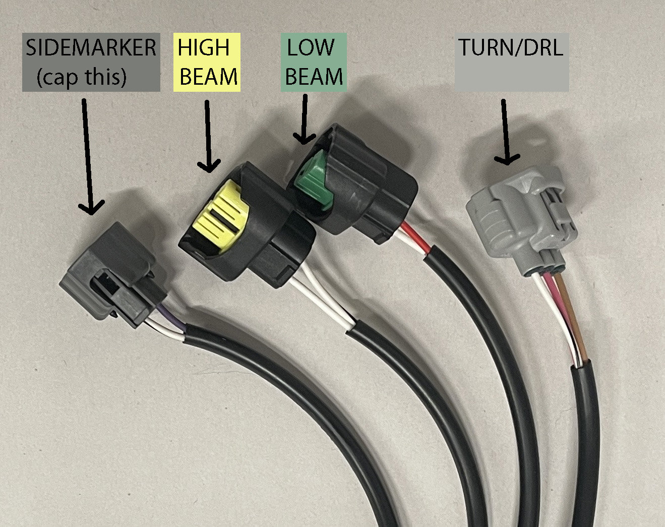

    1. You will notice four plugs going to your existing headlights. Those plugs are Low beam (black plug with the green inside), High beam (black plug with the yellow inside), Turn/DRL (grey plug with 3 wires) and side marker (grey plug with 2 wires).
    2. You can take the supplied caps and snap those into the side marker plug. That plug won't be getting used anymore. So cap it and zip tie it somewhere just to keep it from flopping around.
    PIC2 (coming soon)

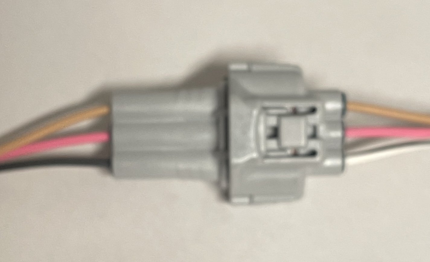

    3. Next comes the turn/DRL plug. This will go to the grey plug on the harness. It can only go in one way, and the colors should match (I use blue with a white stripe on the passengers side where OEM is blue, but that will be the only difference). Make sure it clicks in tight.

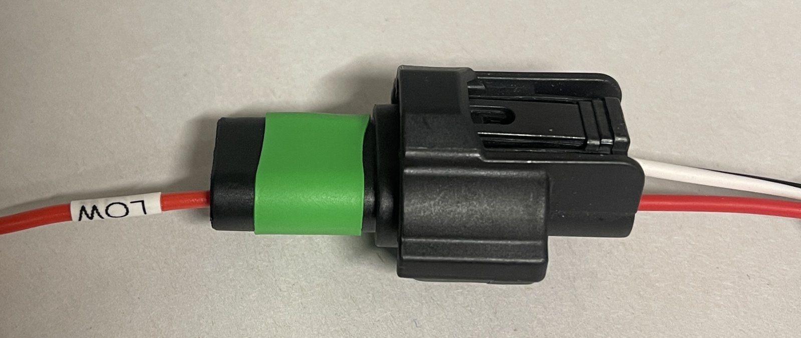

    4. Now on to the low and high beam. The low beam will have two wires on the truck (red and white/black stripe on the drivers side; blue and white/black stripe on the passengers side), but it will only have one wire on the harness. This is how it is supposed to be, so don't worry. Just make sure when you are plugging them in, the red goes to red, and the blue to blue. The wires on the harness are labeled "LOW" in addition to color matching. The low beam is also designated with a green band on the plug.

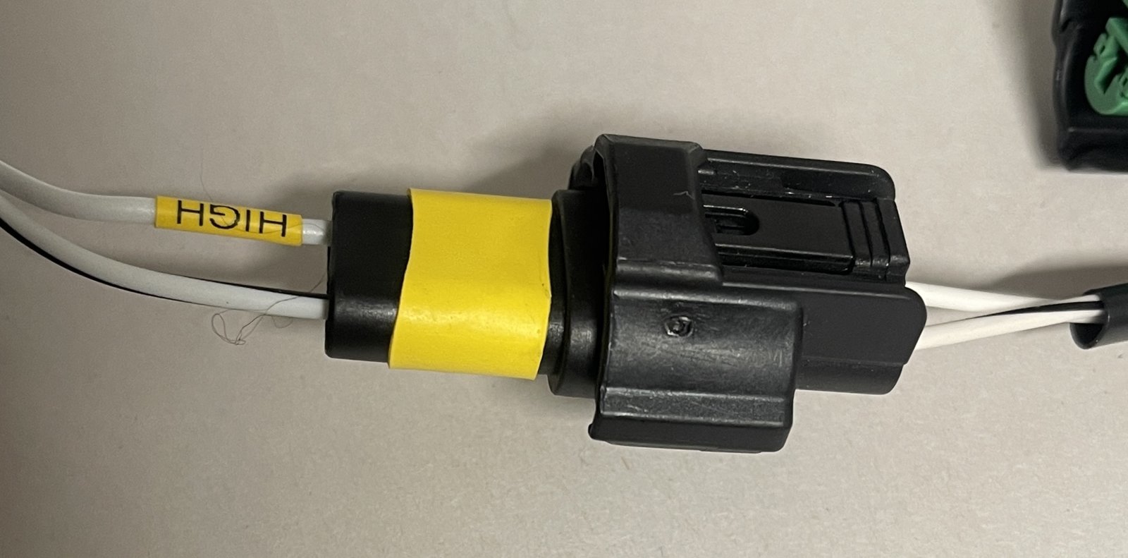

    5. The high beam with be close to the same thing, but there are two wires on the harness for high beams. Once again, make sure you are on the right plug (yellow inside) and using the harness plug with the wire marked "HIGH" as well as being marked with a yellow band. On the passengers side, the wires will be yellow and white/black stripe, so make sure the colors line up. The drivers side is where most mistakes are made, so pay close attention. The wires on the drivers side are white and white/black stripe. So make sure the wires with the black stripe match each other.
    Again, make sure to verify it is striped wire to striped wire. It is a little less noticeable in the truck.

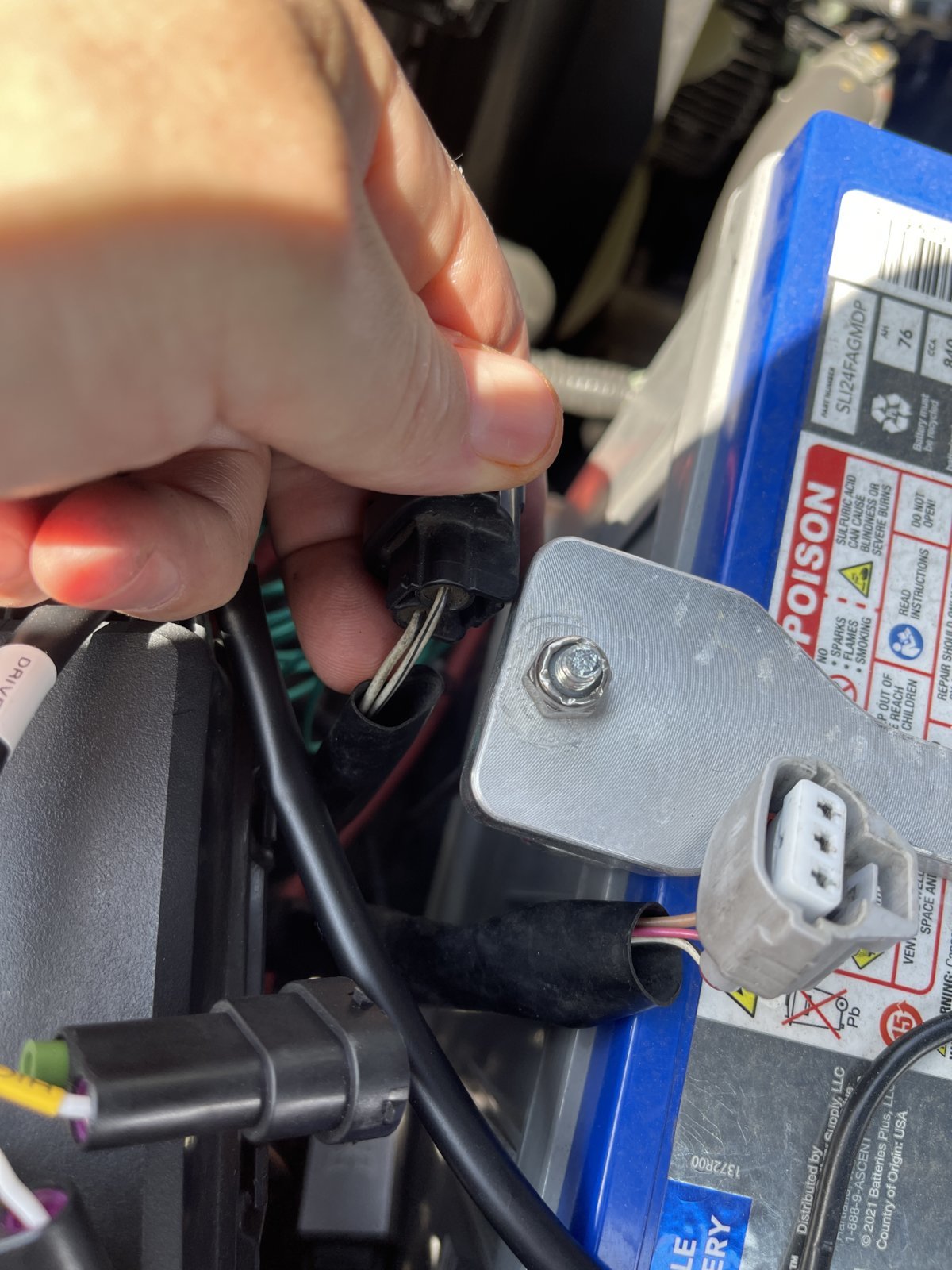

    6. Now, the last plug on the harness goes to the headlight itself. It can only go in one way, so just pay attention to the tabs on the connector.

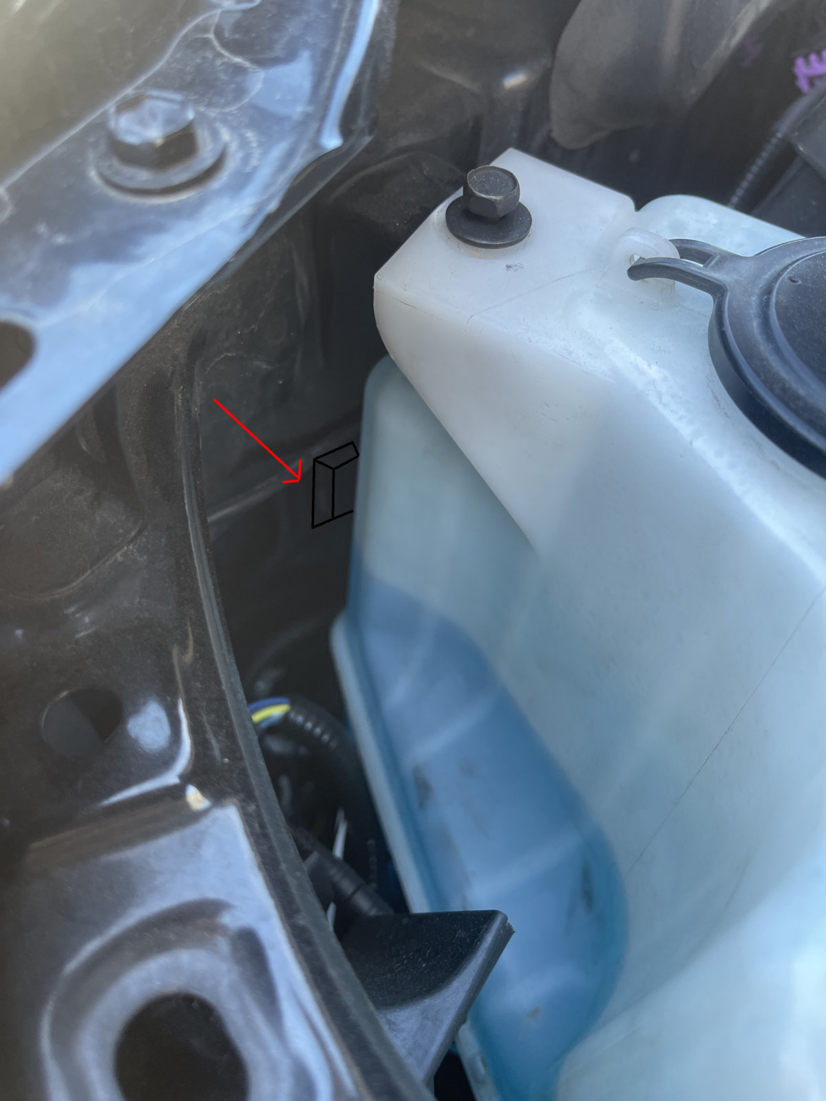

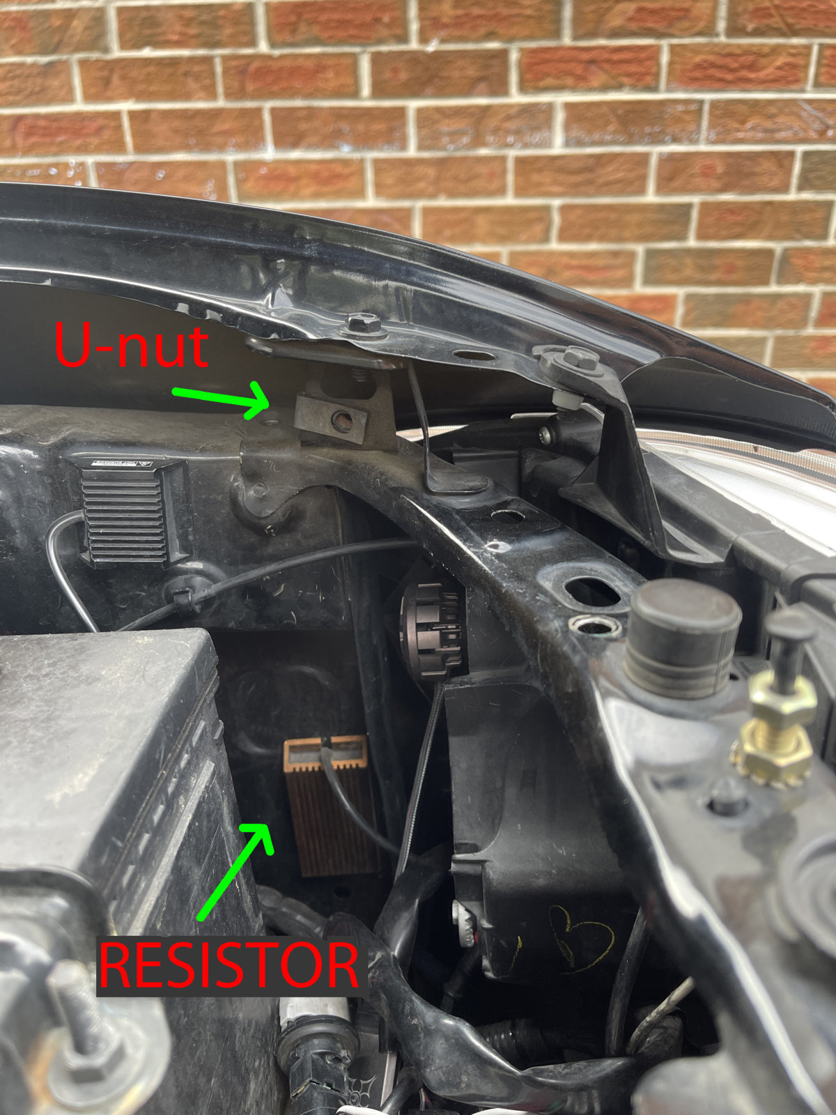

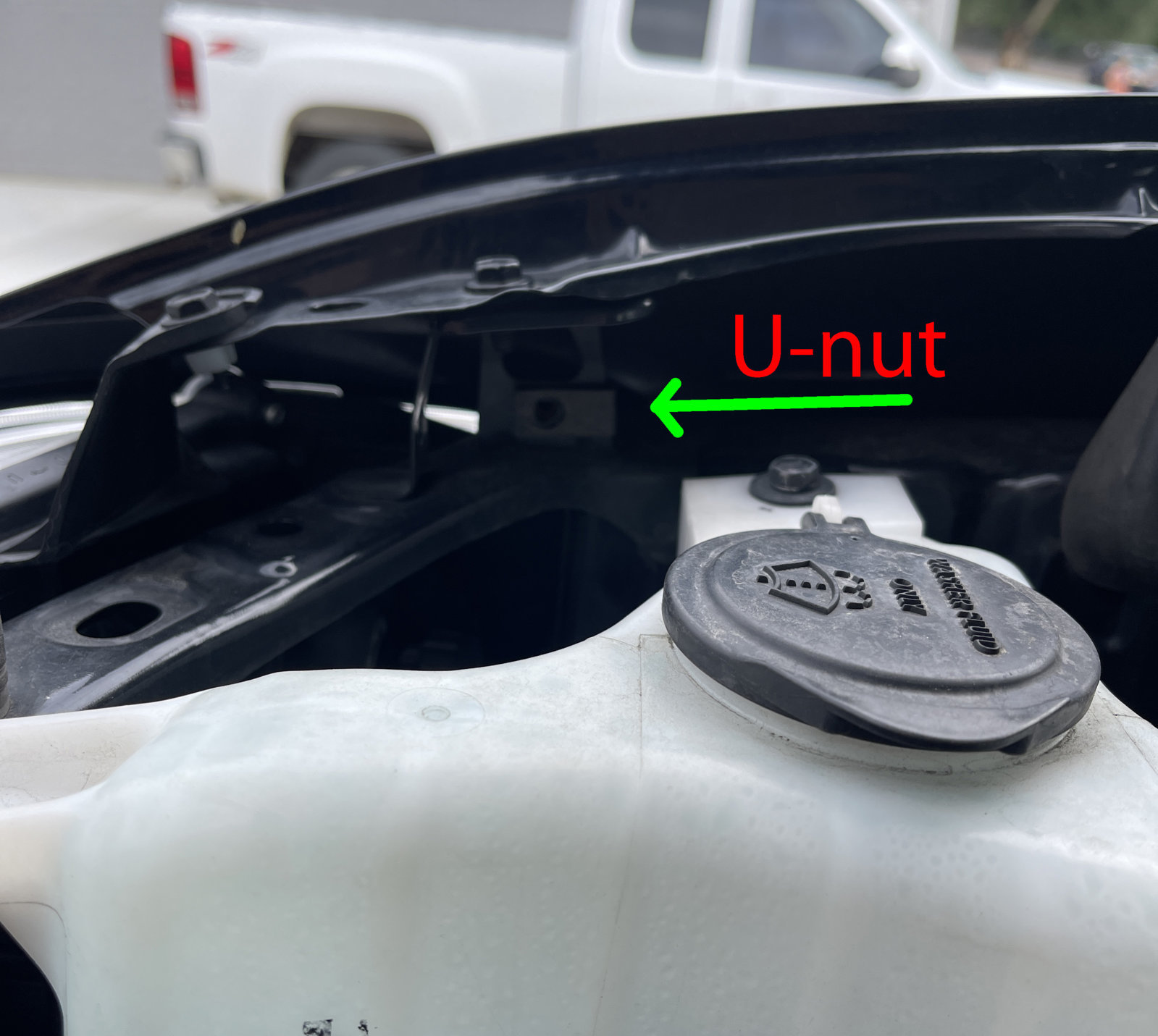

    7. If you want to use the resistors that are included (I recommend you do, see first post where I babel on about hyperflash), these will need to mounted to a flat metal spot, with at least an inch of clearance from wires or hoses. They can get hot. Here is the spot where I mount mine:
    The passengers side is little hard to make out. But it is behind the reservoir.

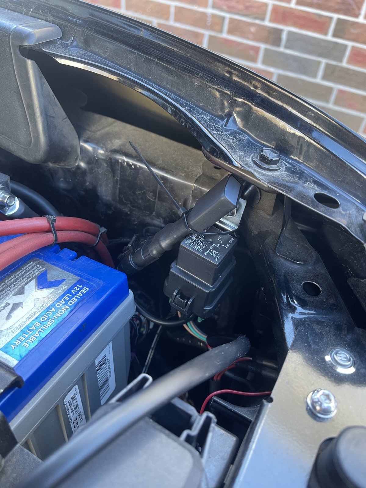

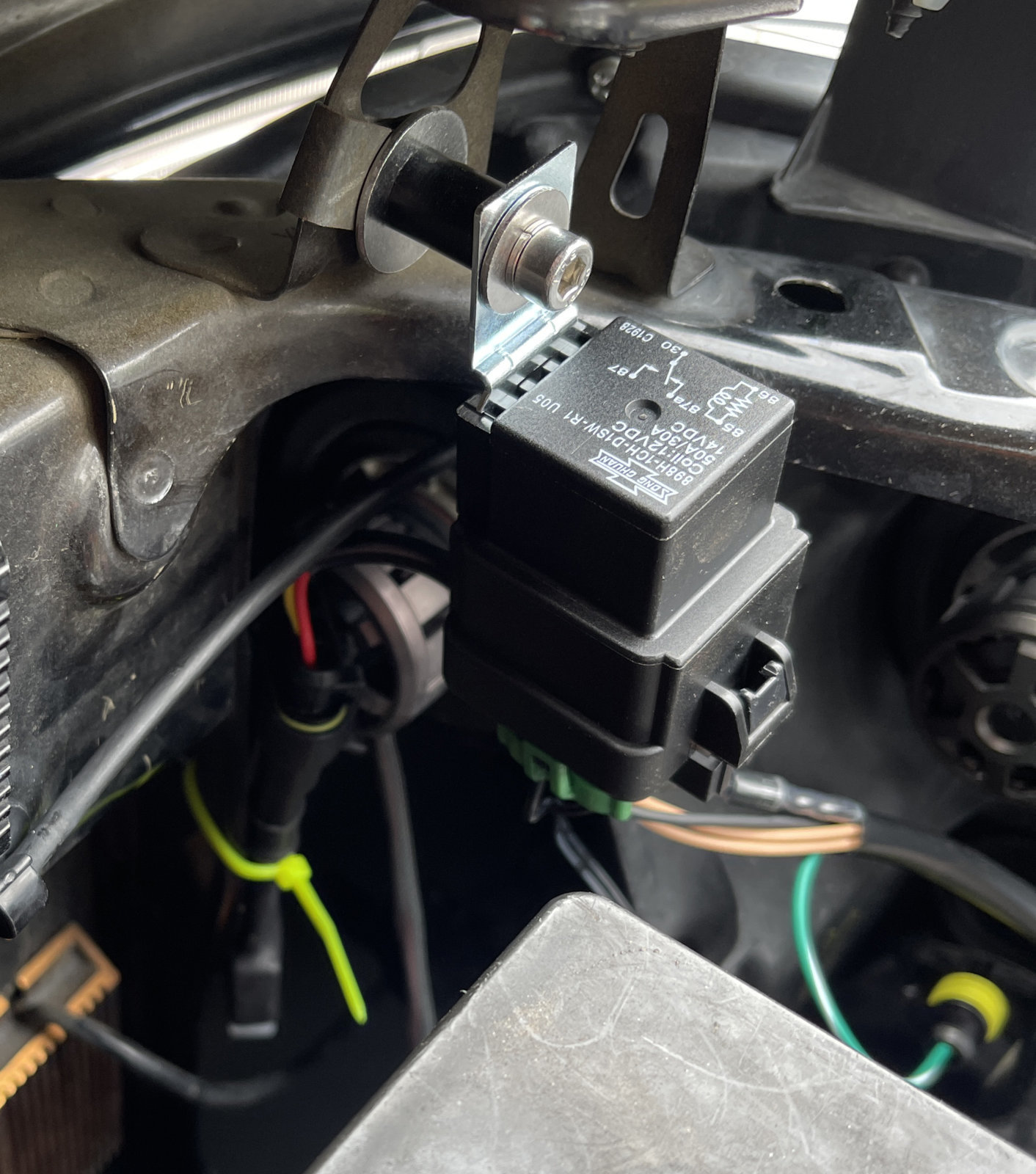

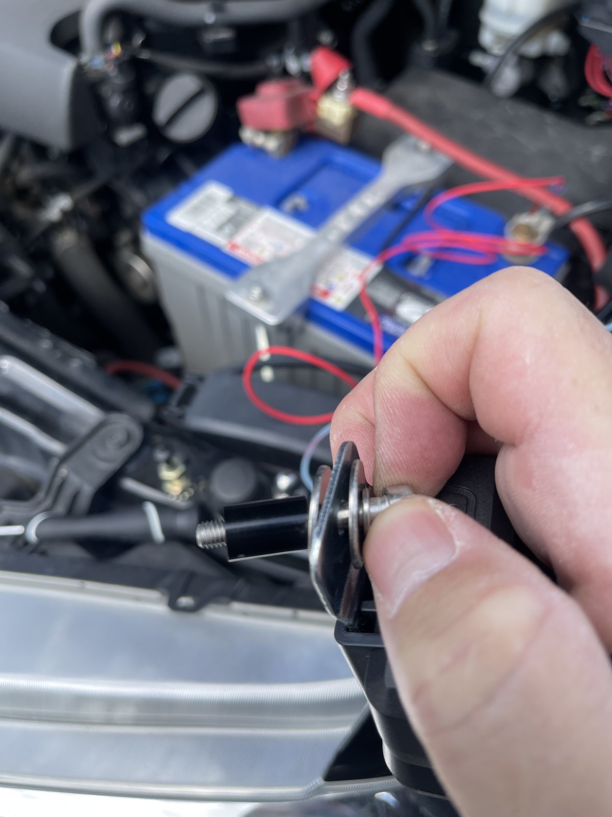

    8. Almost done! Now we just need to deal with the relay on the harness. I have included a couple of U-nuts. The best spot I have found is on the fender, just behind the headlight. Here:
    Now you can take the supplies screw, add the lock washer and a regular washer, and insert it through the hole on the mounting tab of the relay. Then add the black tube spacer and the other washer. Now you can take a 4mm hex key (allen wrench) and screw that whole thing into that U-nut. No need to go crazy, just snug enough to flatten the lock washer will do it.
    9. Lastly, there is a timer hanging from that relay (black heat shrank thing on a plug). Use another zip tie to secure it. It can be most anything you want, it's just best to not have it bouncing around.
    That's it for the install! Recheck them to make sure everything is still working and go out and enjoy your new headlights!
